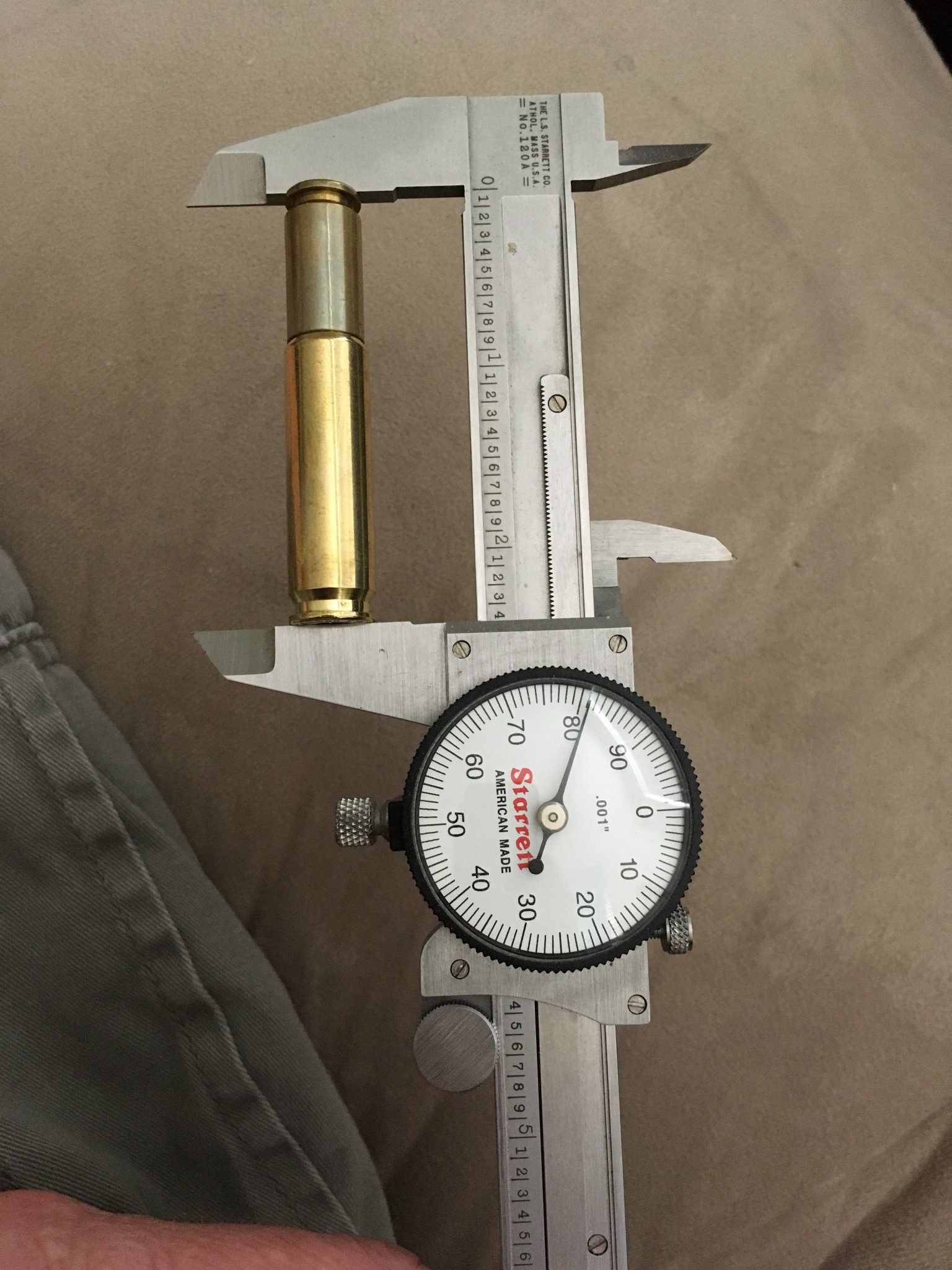

You have to measure the shoulder length on your fired case, then unscrew the die a little, size the case, measure the shoulder length, then screw in the die in small increments until you reduce the shoulder length by .002”. That way the case will chamber easily but you won’t be over sizing the case.
Do you have a shoulder length comparator? Or a 9mm pistol case?

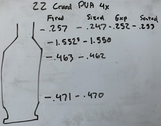

That’s not the barrel you shot it from. Bump shoulder back .002” from fired. That’s it!

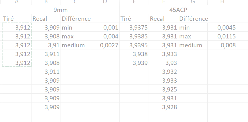

On friday I'll check the chamber with propers gauges, compare my fired cases with my sized cases, and fired cases (lapua), so I should understand what's happening.

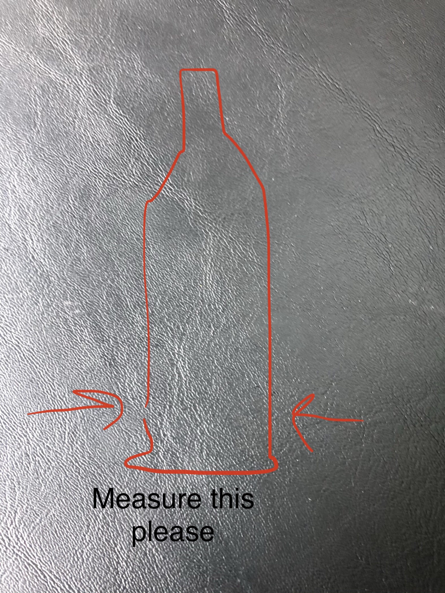

Are you new to reloading? I ask not to insult, but to understand your process. This is how most of us would have started - by measuring and setting the die by making measurements of the shoulder, using either a comparator tool or a 9mm shell as above. Very few on this site set the die by touch + 1/4 method that is listed in the die booklet.

Get measurements of the neck diameter, shoulder set back, shoulder diameter and base diameter in both the fired and sized conditions.
If you want to know a real answer then you need to get some real data. No one can tell you what you have except for yourself.

I Made some measurements of that whith 2 cases I have : 9mm para and 45 ACP. These two cases permits me to measure at the smallest point of the shoulder (9mm) and at the middle of the shoulder (45 auto). Unfortunately, I am not able to measure the base of the shoulder.
Do not take a look on the value, I did not zeroed my tool. Just take a look on the differences.
I compilated all my measurements in excel to have a clear view of what's happening, you should have a picture.
What do you think about that ?
The headspace measurements are a good start, but I would also like to see a measurement near the base of the case (case diameter).
From your measurements, I am referencing the ones made with the 45 case - measuring halfway down the shoulder is a good way to measure effective headspace and sizing, or bump.
I am concerned that you are moving the shoulder back too far. An average of ,008" is quite far. We usually want this number to average ,002. Try to unscrew the die in the press to produce a ,002 difference between the fired case (unsized) and resized case, when measured with the same 45 shell. If you resize your cases by ,002 smaller than fired, you should find that they still chamber easily.
I think you have the die set too low in the press. This could be the reason why you are breaking dies.
Measuring the base of the case was the first thing I dit when I saw that I was not able to chamber back. I have a difference around 0,003", 0,004" maximum.
If I cannot chamber, I was forced to full full full resize to be able to chamber, because of the bottom of the brass.
Than, I agree with you, I think I bumb my shoulder back too far. This causes overpressure I ignored, and I entered in a bad circle that I described some posts earlier.
