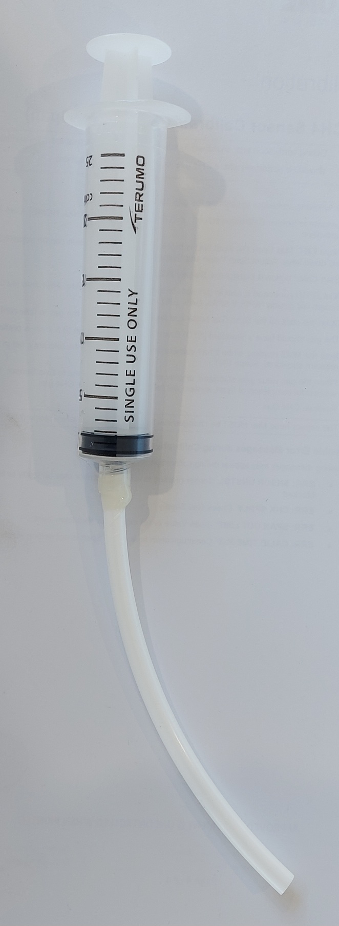

Bringing this back from the dead. How are you guys filling the barrels up with cleaners without getting stuff all in the action?
Bought 10m of "water filter line" at the hardware and a few syringes, it actually winds into the syringe end but araldite for security.
