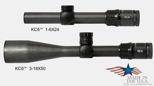

Tried? Yes.
Successful? No.

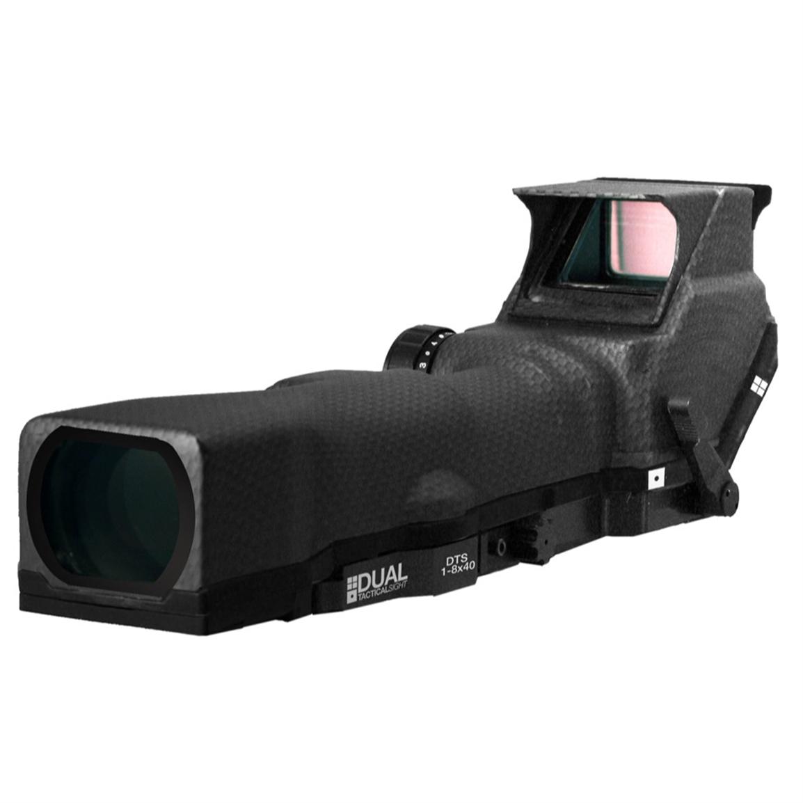

They also had at least two that were square-ish/rhomboid.
