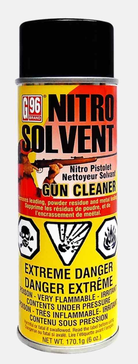

I also use a bronze brush on a pistol length rod in my drill motor, but with G96 nitro solvent (a lot safer on your bore!)
I measure with my bore scope the depth of the carbon ring and mark the rod depth with masking tape to insure not getting into the rifling. The most stubborn carbon rings come out in seconds!
Sorry the pic came out so big.
