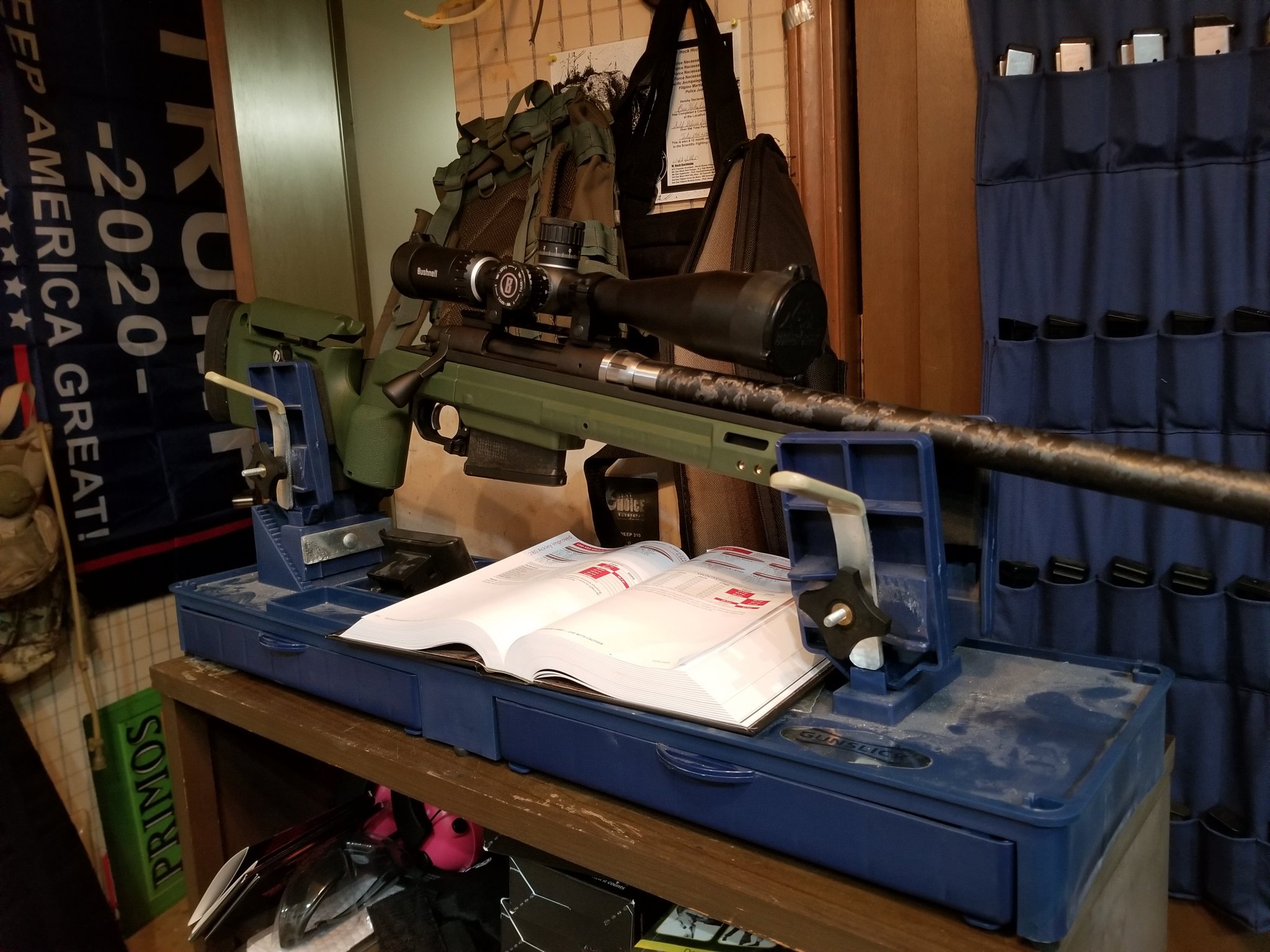

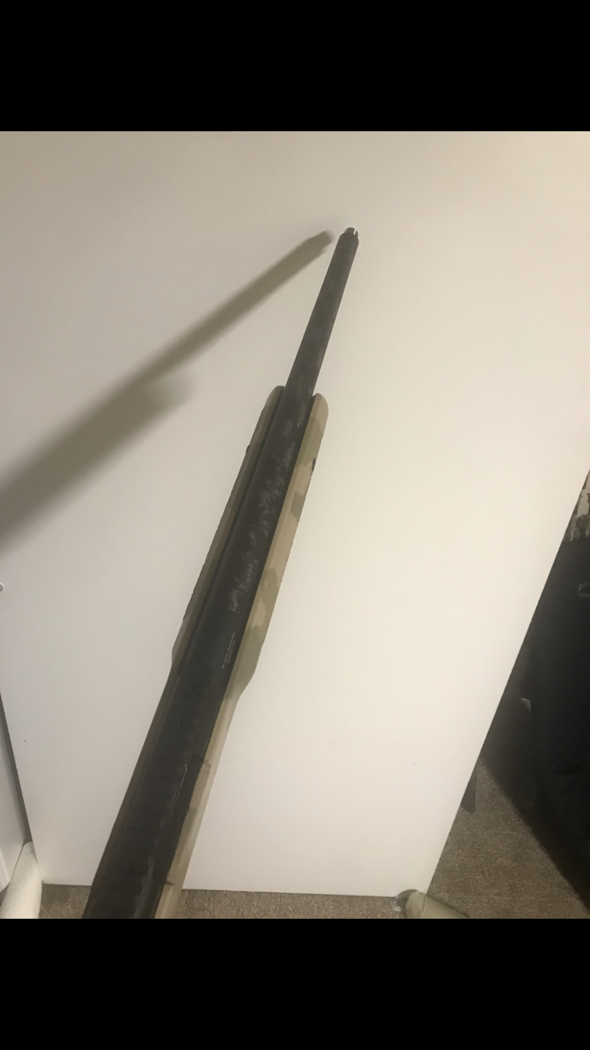

Just an update I received the barrel back in the mail today installed it on the action everything seem to space correctly and it fed rounds flawlessly hope to get to the range on Saturday my day off see how she shoots😎

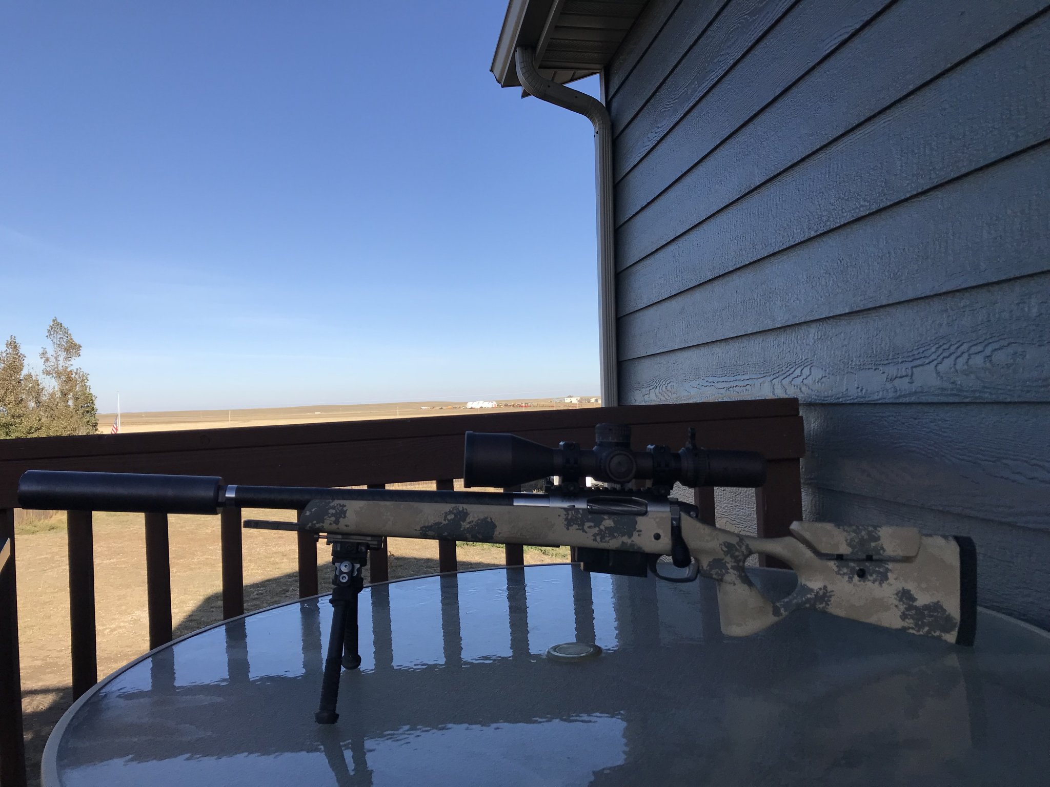

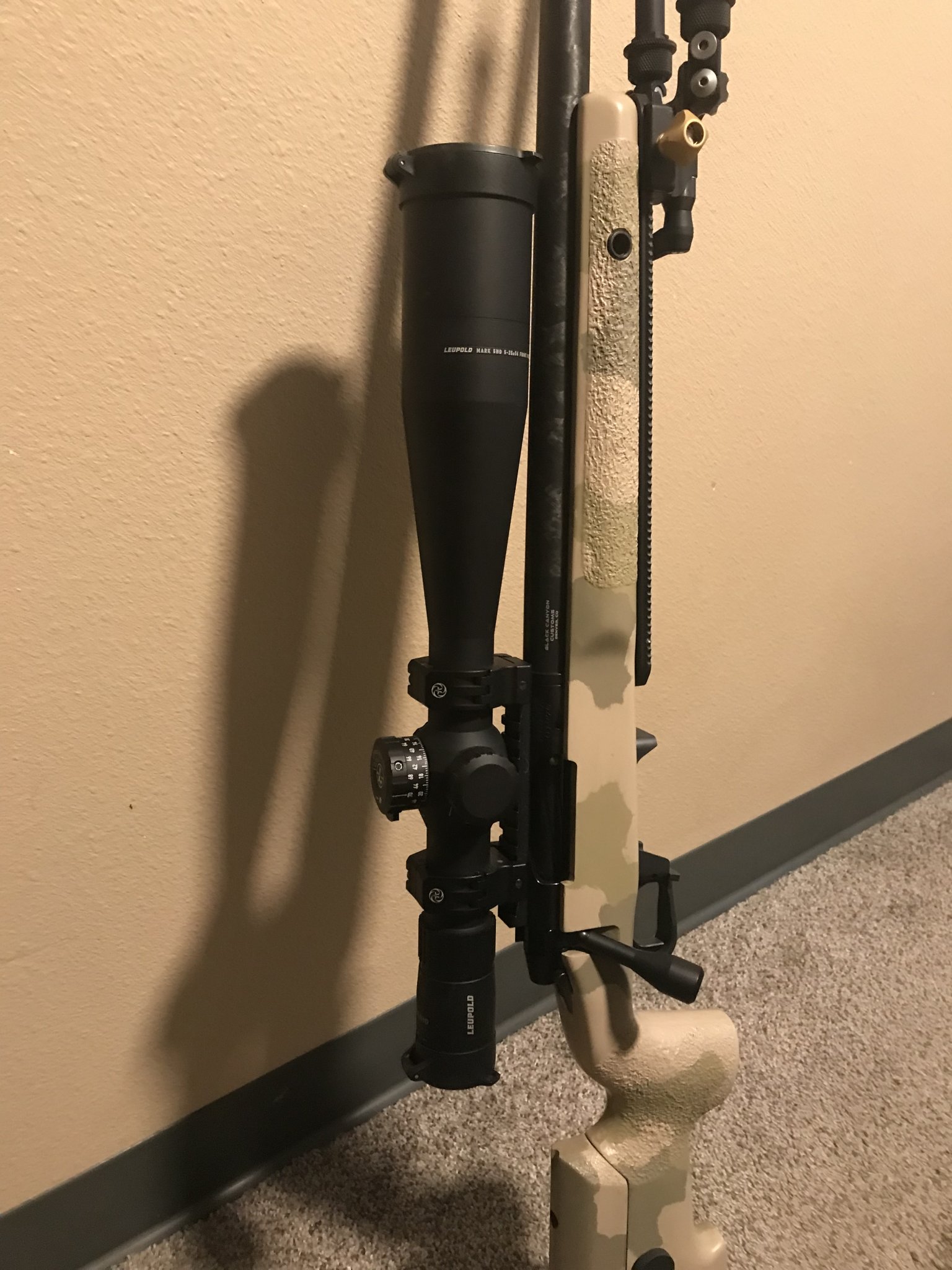

The 280AI "Hide" rifle. Action, stock, rail, rings, bullets, and brass came from the trading post. Found out about carbon 6 barrels here as well. 8.9lbs without scope. 24" magnum barrel 2lbs 14oz.

Just an update I received the barrel back in the mail today installed it on the action everything seem to space correctly and it fed rounds flawlessly hope to get to the range on Saturday my day off see how she shoots😎View attachment 7724948
Shoots just as good as my other custom barrels. Even shoots my Berger 140 load that all my creeds like!! I’m happy 😎
Let the killen begin!!!

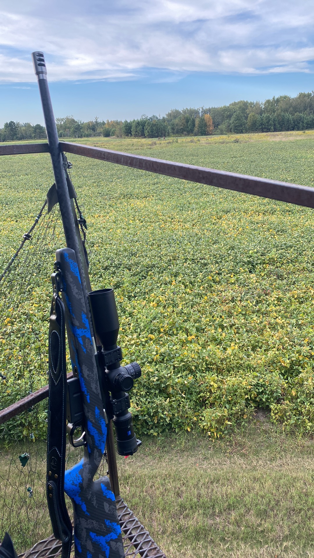

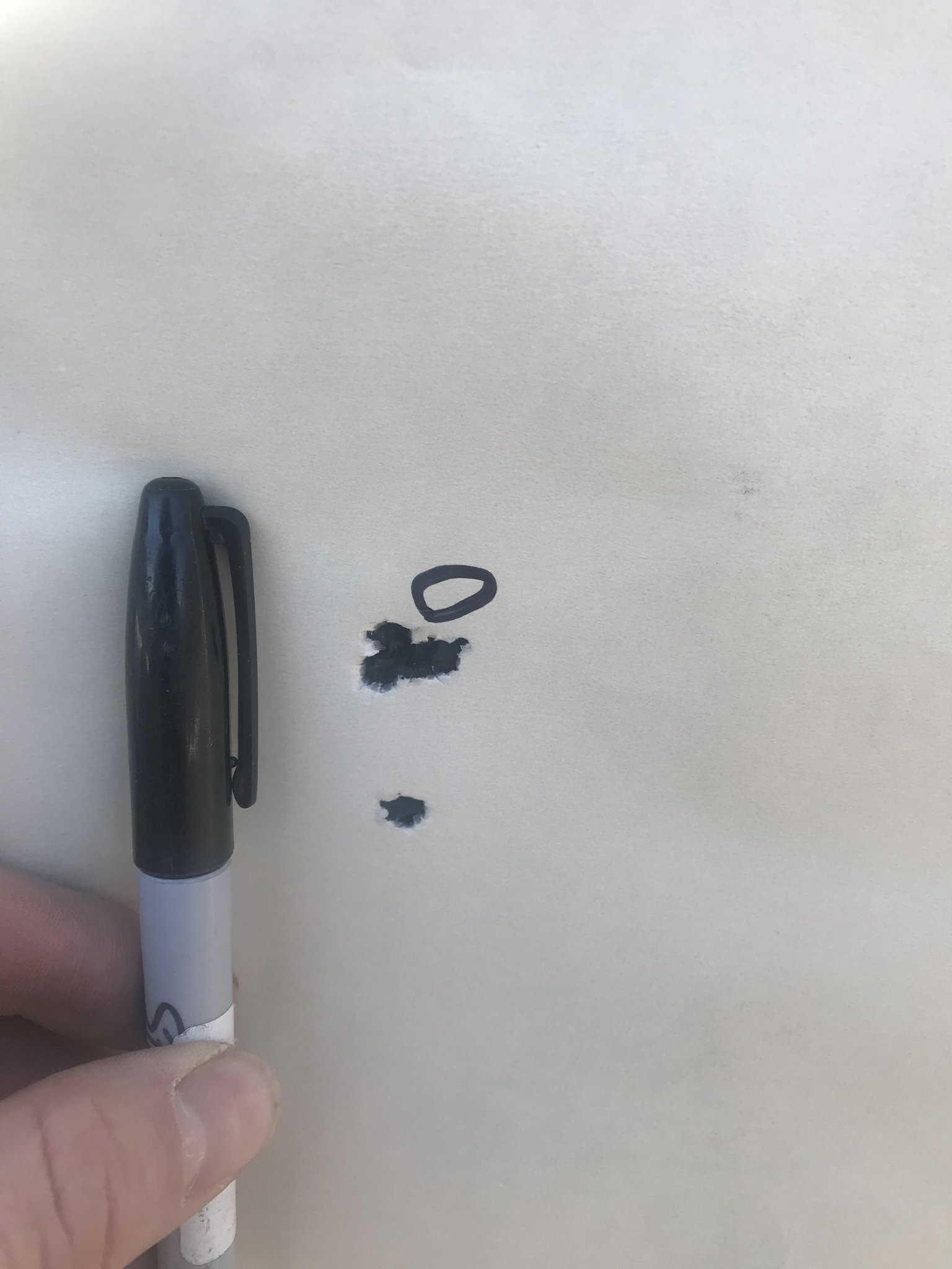

I think I've finally finished my load development for my C6 18" sendero in 6.5CM. Tikka pre fit.
Shooting .3-.4" groups on average with 140 ELD over 40.5 gr of H4350, 2680 fps avg @ 30-40 degrees. SD of 7-8. Impressive speed for an 18" barrel suppressed.
As someone else mentioned earlier in this thread, my barrel sped up about 150 FPS total. It settled in after 150ish rounds and has been stable the last 100 rds to 250 total at this point. I've only been reloading/in this game for a little over a year now and wasn't expecting that. My previous PVA barrel only sped up about 50 fps total. Not that I'm complaining, it is fast, accurate and light. Exactly what I was looking for in my "all purpose" groundhog to whitetail field rifle.
Now I just have to slow myself down some compared to my previous PVA light palma. The C6 does heat up a bit faster, but it also cools faster.
Reactions: 260284

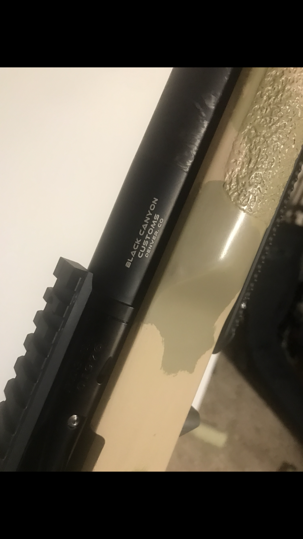

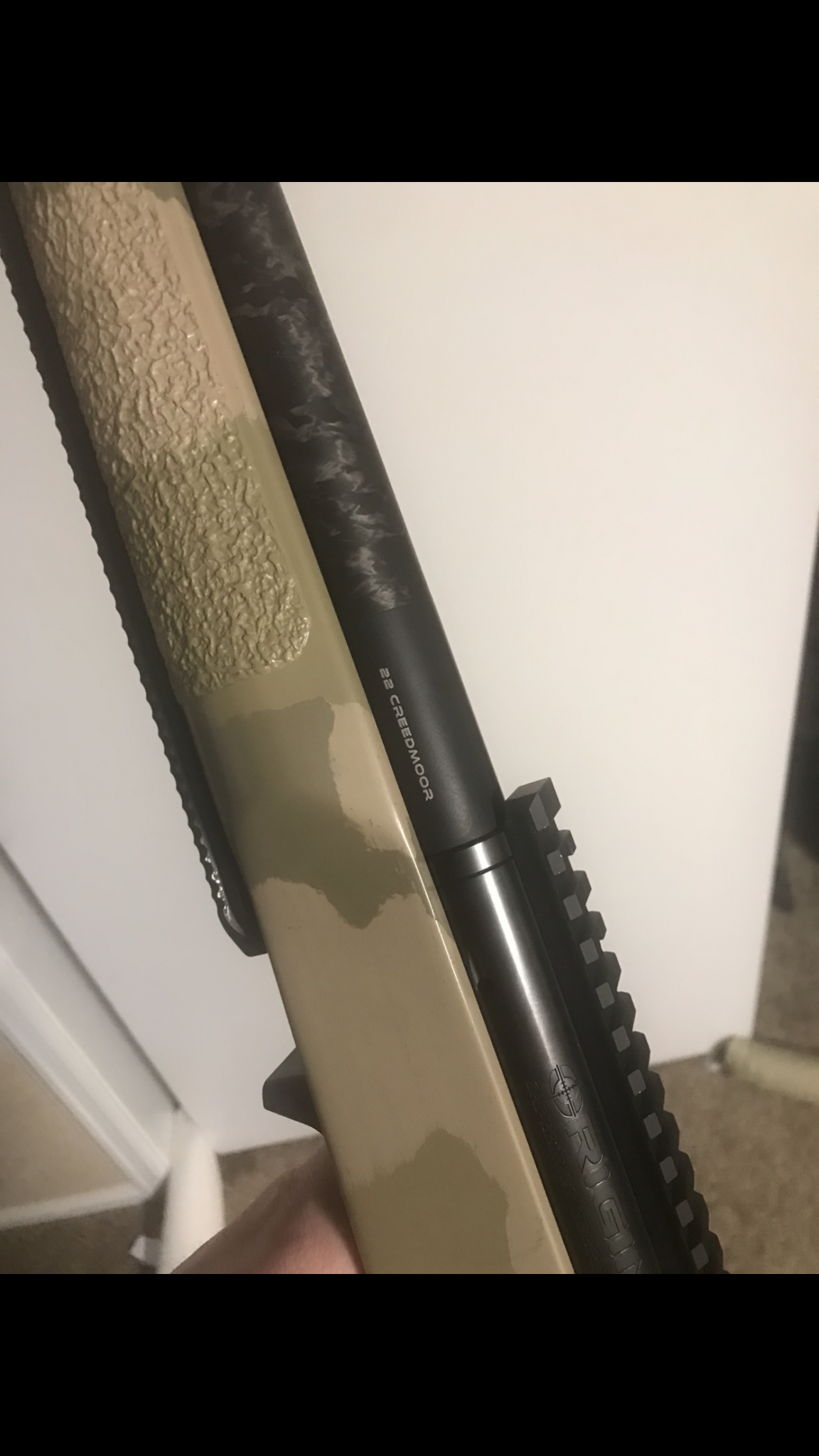

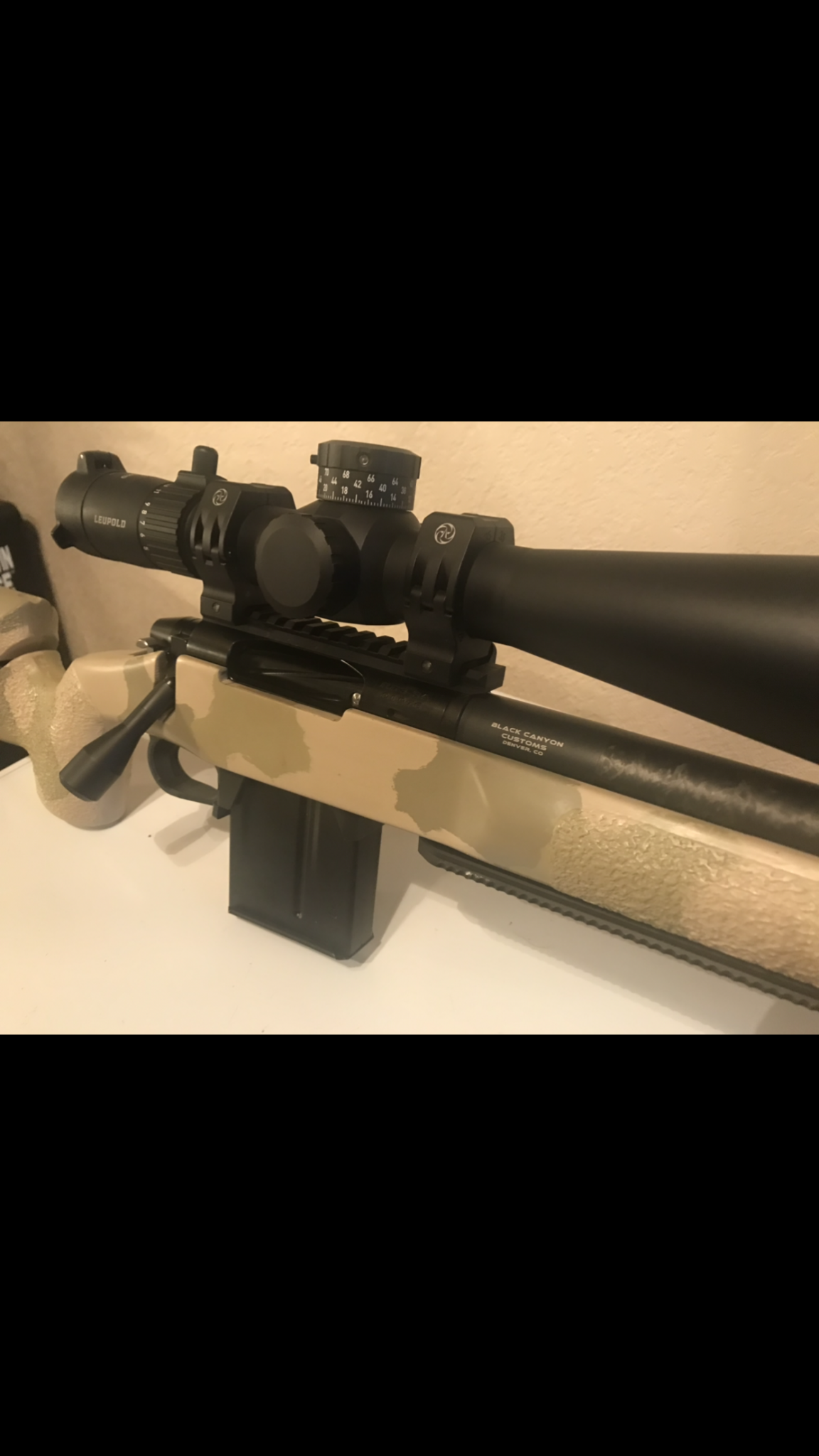

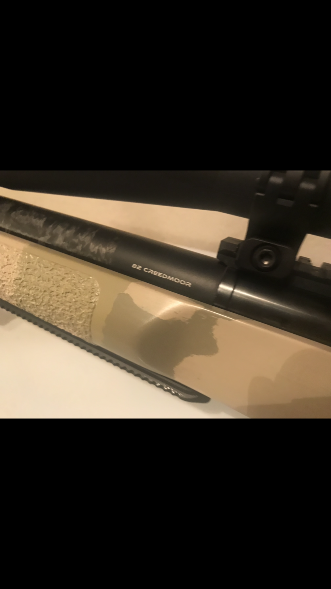

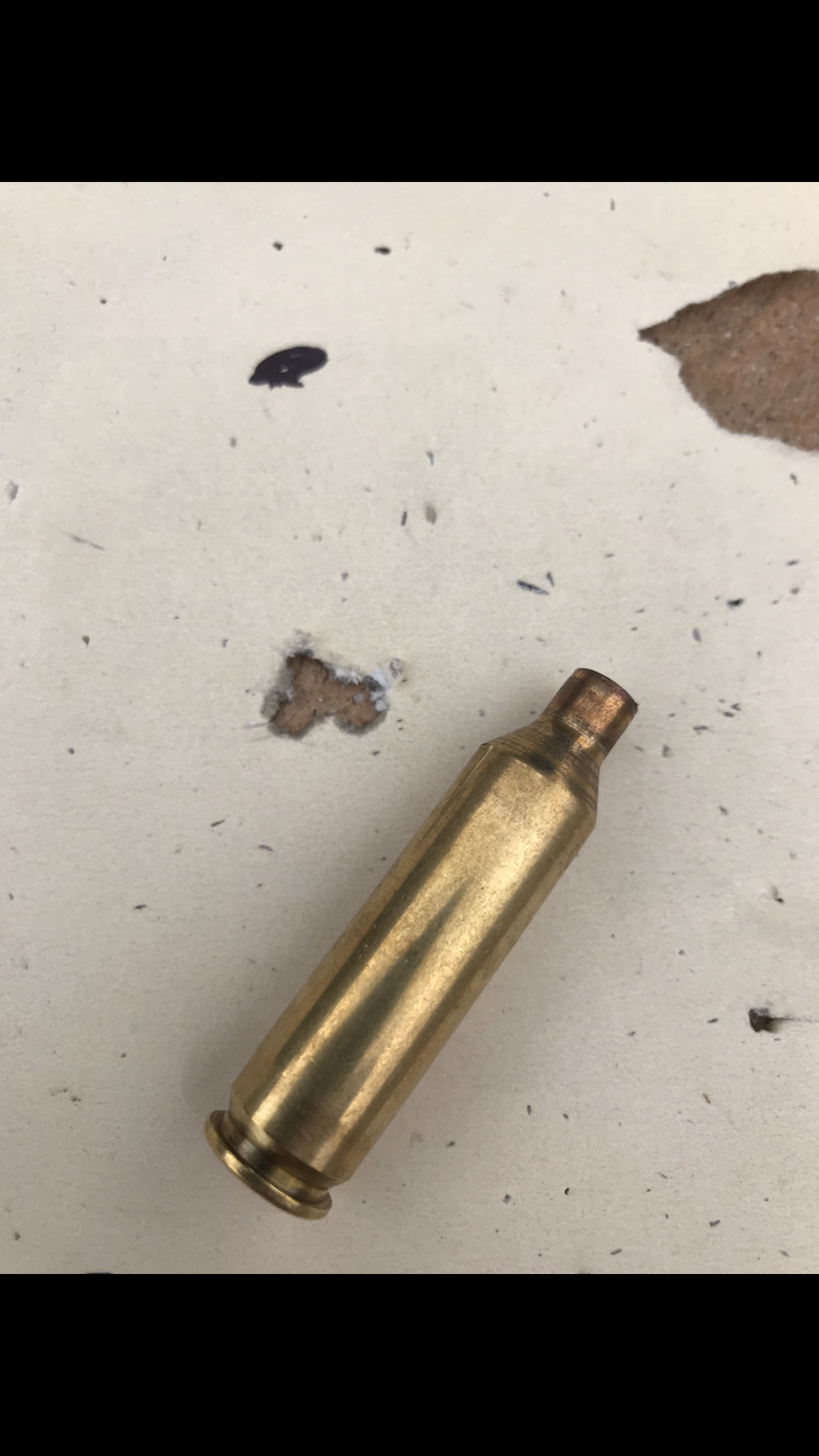

I have one chambered 22 creedmore. 22” on my origin. By black canyon customs.
First shot to sight in and then a 5 shot group. With a guess at a load with 75 ELDM at 3400ish FPS.
Coyotes don’t like it much.

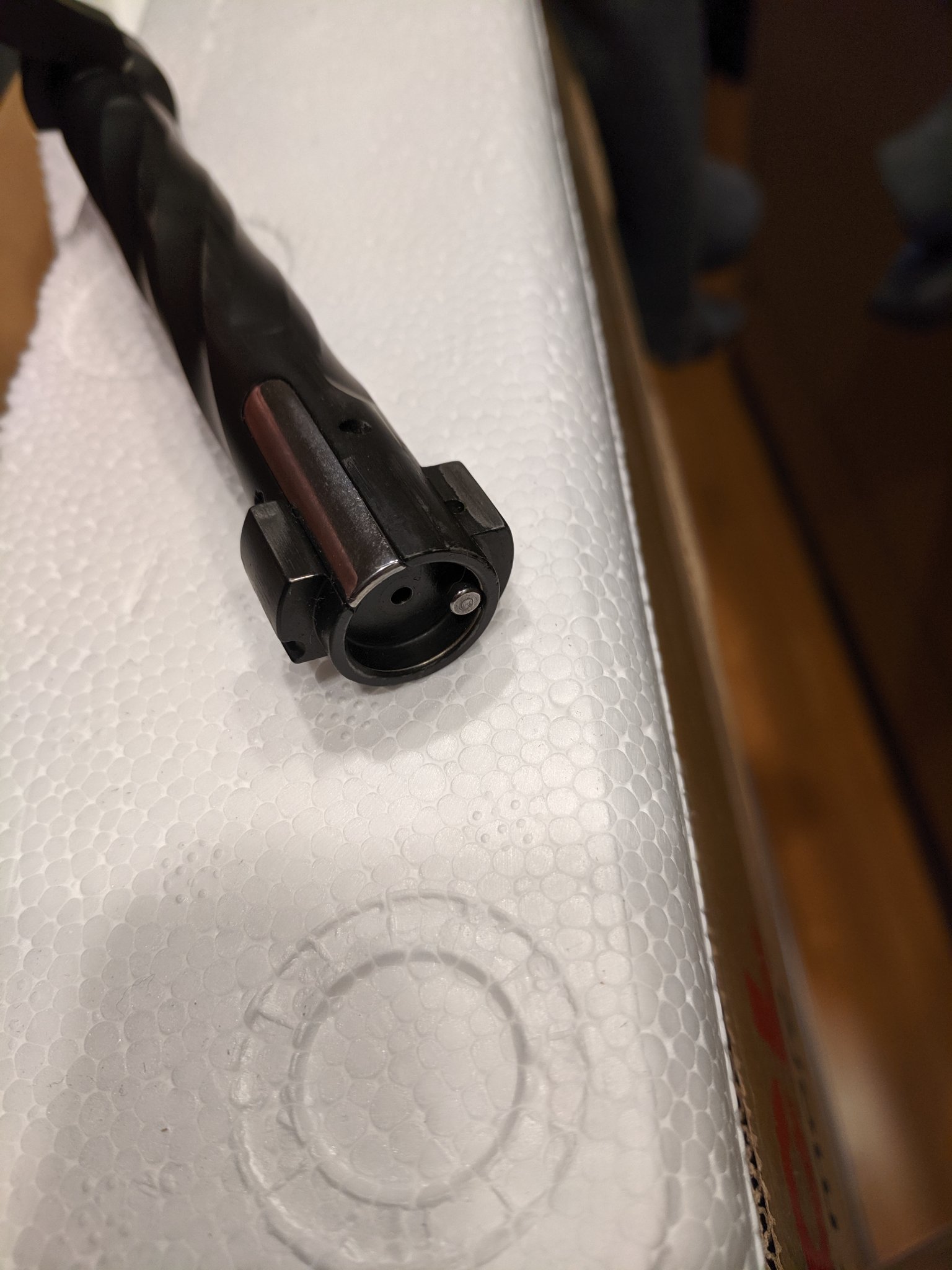

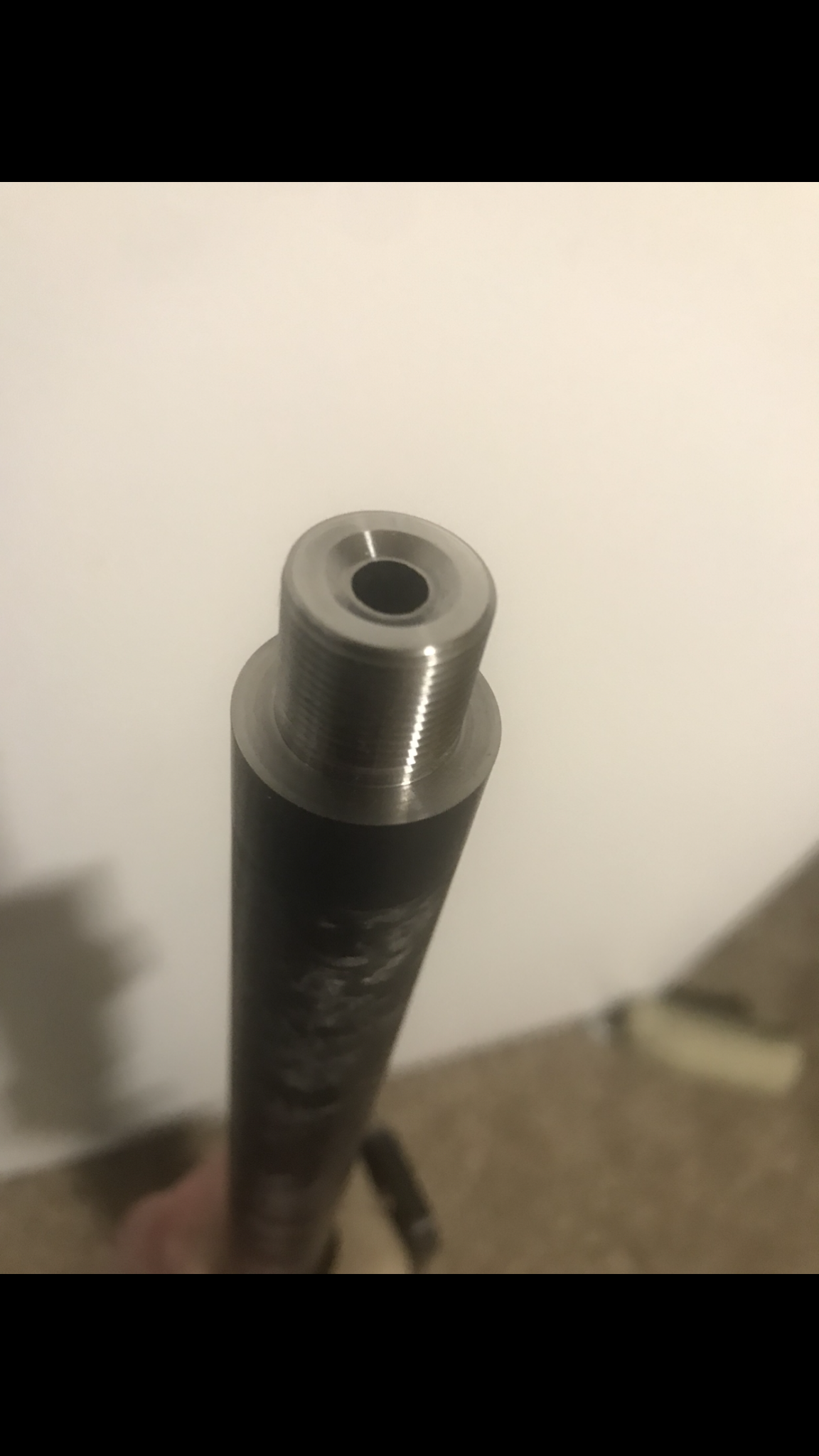

I’m having a tough time figuring it out. When I put something in the bolt face and push out the extractor as far as it will go, the largest reading I am getting is like .710
I have a 6.5 Max barrel with counterbore .71 and the m16 extractor will not make it over the case rim. If I push my extractor open with a fingernail, I can measure all the way to .79 or so, but all of that isn't needed (at least with my bolt) to make it over the rim. C6 already sent me a UPS tag to send it back for a reamin', and I'm going with LRI's recommendation of 0.75.
factory bolt?

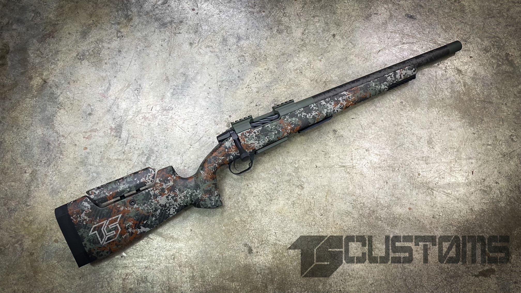

My Feb 12th order is shipping, should be in MI Wednesday next week! 17.5” 45p… going to send it off to Travis at TS Customs to chamber and build me up a badass straight wall deer slayer
  • Wow
Reactions: reubenski
Travis just bolted everything up, should be shipping in the next couple of days here to have all set up just in time before Nov 15th here in MI.
Weighs 7lb 3oz, but will be using some Hawkins rings, TT315M, and a dead air primal suppressor.
Specs:
• TS Customs KS1A stock
• LonePeak Fuzion Titanium
•Carbon Six 17” 45p 1:16tw barrel chambered in 450 bushmaster
• Hawkins bottom metal w/ hunter flush mag, TT Special 2 Stage

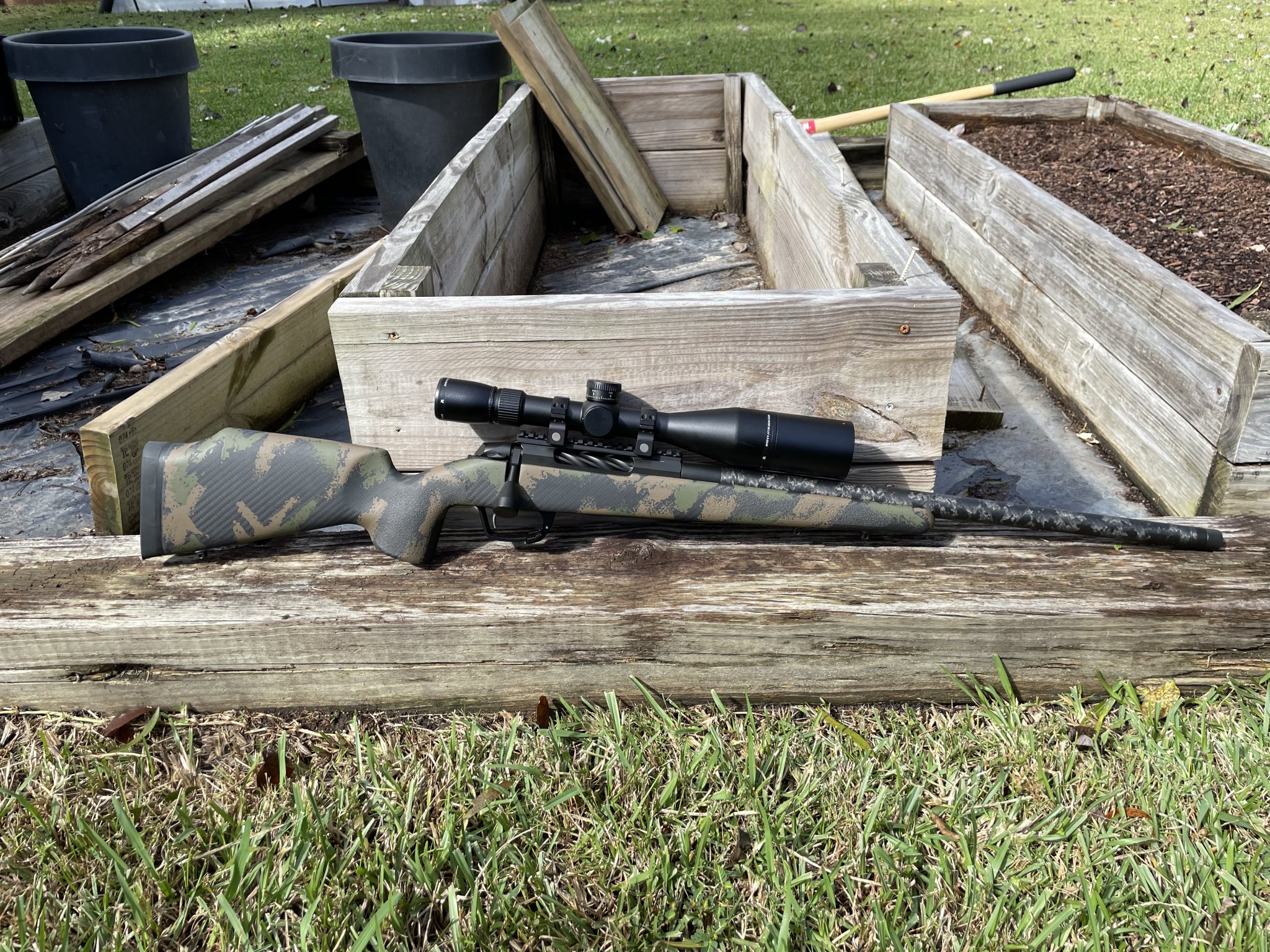

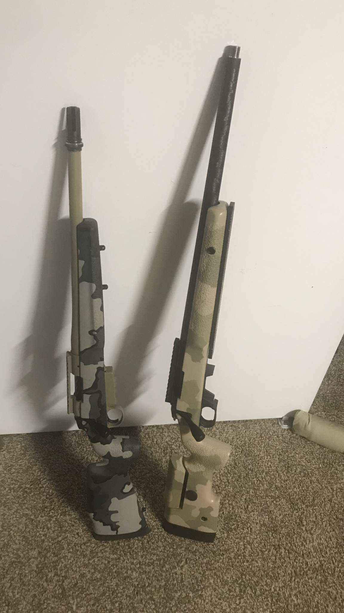

A pic of mine in the wild. Build is as follows
7rem mag
Stock Tikka action
AG composites stock
Atlasworx bottom metal with 3rd AICS mag
C6 27” barrel SAAMI cut chamber 1:8.5 twist
Rifle weighs in at 7.5 lbs before glass
Glass is Zeiss LRPS5 with Spuhr rings.
I intended to shoot 175 Bergers but the supply was non existant. Luckily a friend had an abundance of 195s so I figured I would try em out. I am able to send them out at 2900 fps even seating them way deep in the case due to the saami throat. 1/2 MOA and better depending on the shooter. I will throat this after the season here ends and see if I can squeeze another 100 fps out of it. I am tickled how well it actually handles the 195s
Reactions: 260284

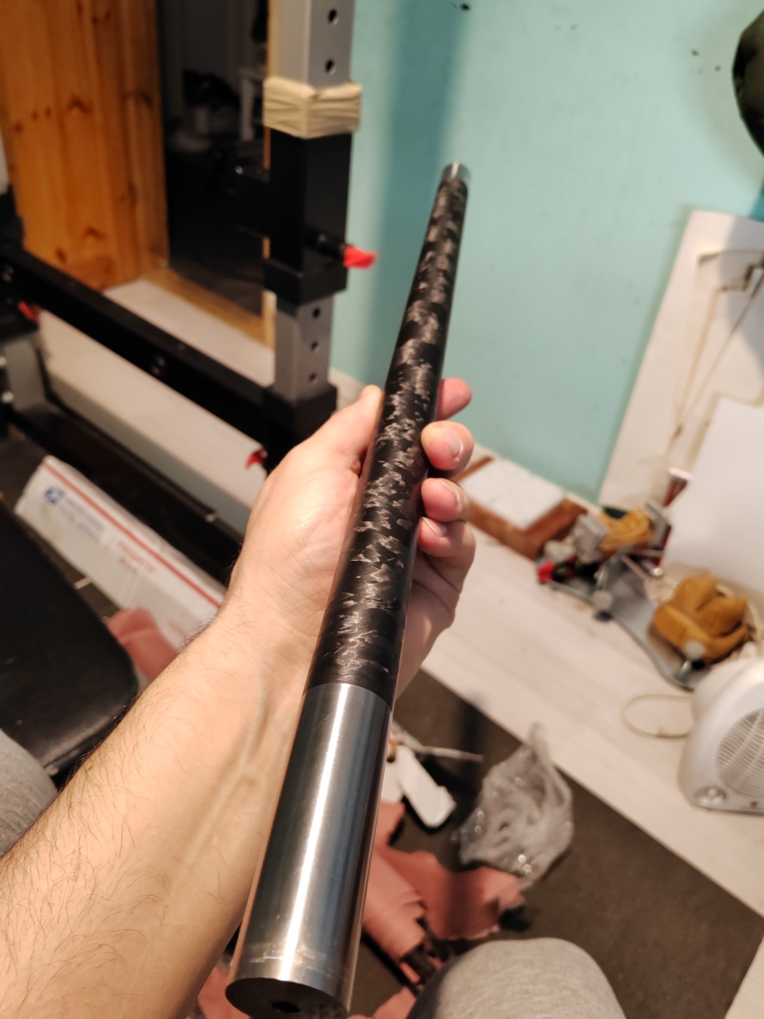

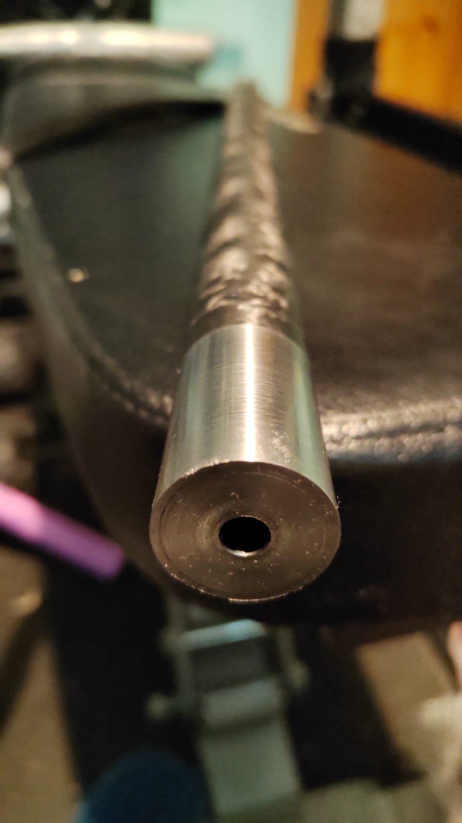

We ordered 4 blanks, one is going to be mine.
I dont know im a crazy, but i have always wanted a carbon wrapped bull barrel, so one of those is coming for me :D
6,5mm 1/8" and 24".
I know some people do not break in a barrel, so should i not do it with this either?
I have a Krieger SS barrel same specs, and i did not break that in either.
If the barrel is hand lapped, is it just a waist of time, to break it in?
Maybe few brush in and out with an oil, cleaning and just shoot it.

Surpriced the quality, looking very nice.
Now i need to think, will i do it to .260Remington or 6.5 Creedmoor.
