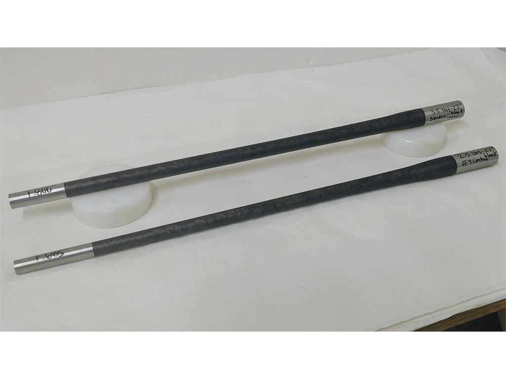

    Anyone used these? I've read and seen some impressive results for the money on wilson barrels from a good friend of mine whom I trust. Seeing as Cooper owns Wilson barrels I have no doubt they'll shoot. I'm curious if anyone has used the raggedholed carbon wrapped wilson barrels though? We have a 700 KS Custom in 300wby that I'm going to rechamber in 7PRC since it is collecting dust and am wanting to keep it light weight without going pencil thin so it's still a decent suppressor host.

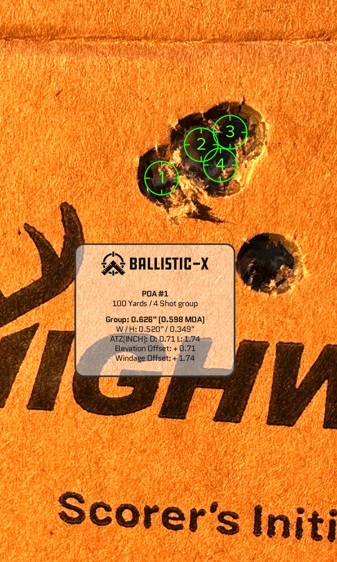

    Well I recently tested these SS Wilson barrels in 6BR and was a tack driver on my tl3...

    Buddy of mine who’s a hider also has had great success with them. Which has me sold just not sure how the carbon fiber performs. Granted my proof and Carbonsix have been fine but this would be thinner for a CF wrapped barrel

    Probably not i saw some proofs for $600 but the issue for me is fitting a CF into this browns precision stock on our 700 KS custom. Which is an ultralight build. #4 will be pushing it. John at ragedholes says the carbon fiber barrels are nearly a 1 to 1 contour match.

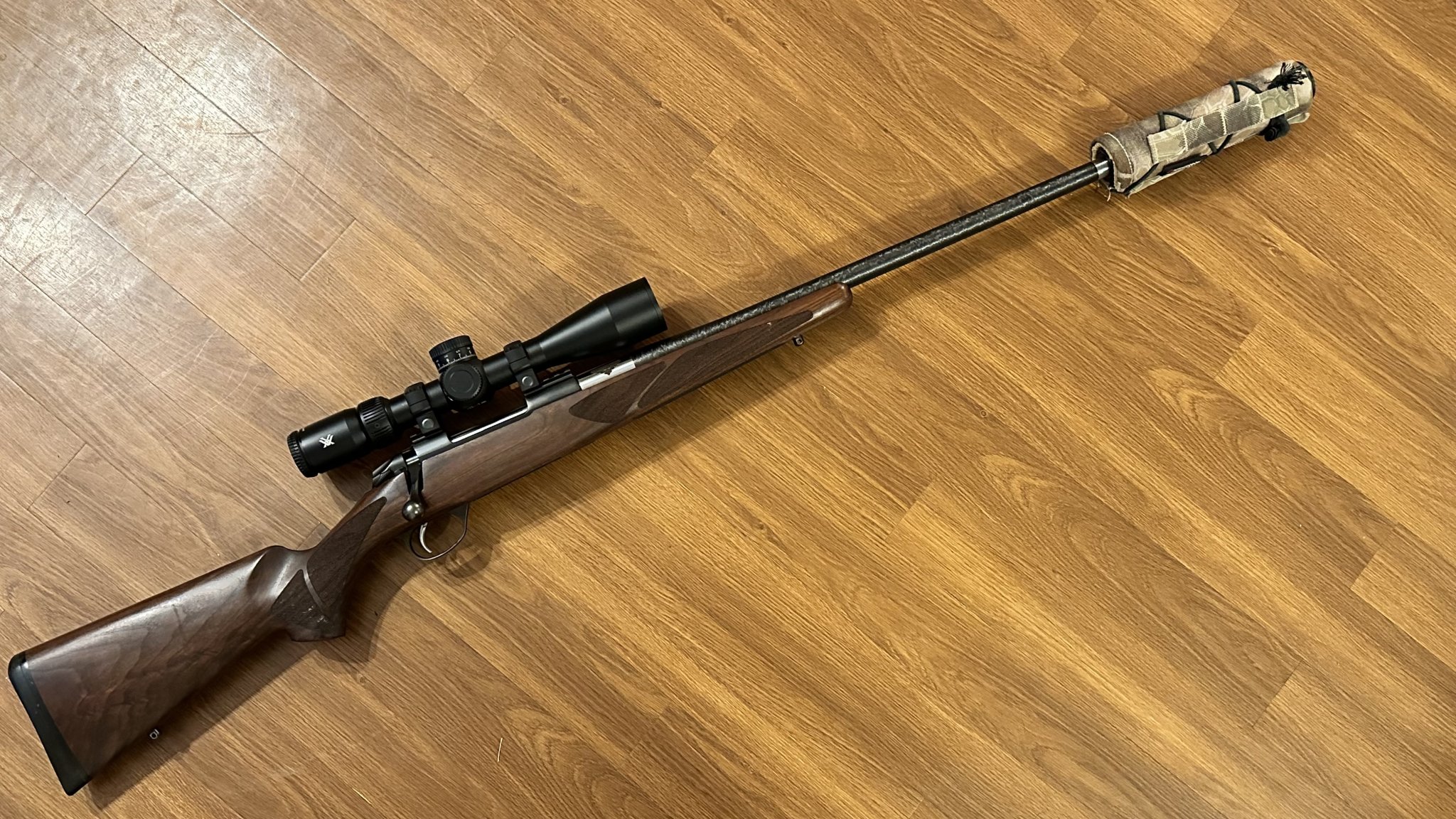

    So after talking to Brown's precision that stock can't be opened up without getting into the foam shell. I pivoted changed it to a #4 6.5mm for finish at 22" and am having LRI open up my Sako 85 bolt face to fit a 6.5 SAUM, and will rebarrel my Sako 85 to 6.5 SAUM. So i should be getting it sooner rather than later.
    For the 7 PRC I'm going to have to sell the Brown's precision stock and pick up a Manners UC and then likely a bartlein #4 for finish at 23".
    Wow nice stick and shooter . How did the break in go? 5 groove or 6 on the wilsons
    Thank you definitely unique. I don’t really break in barrels anymore just shoot. So I’ve got like 30rds down it at the moment. Have dies and 135gr classic hunters now just gotta find time to load them. Not sure on the groove, neither John’s site bore Wilson’s stated what it is.
