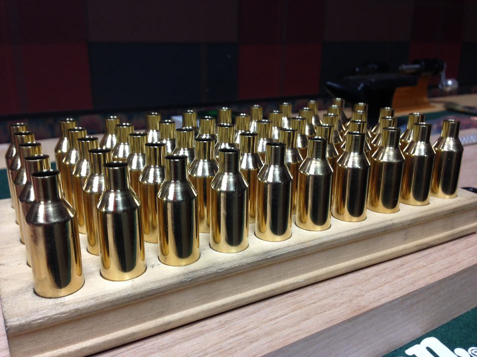

Not knockemdown but here's how far I turn into the neck. You can see where the bright ring stops on the shoulder. I turn all case necks pretty much like what you see here.
To add, I am sizing this cartridge all the way to the neck/shoulder junction then turning into the neck as shown.

I've been turning the entire neck as well. I thought that I would share a little bit of what I have learned about relaoding for this rifle. I started out with some used brass because you all know that situation. I had terrible luck with it. My preasure was all over the map, I even popped holes in 3 primers and broke a sear in a Jewel trigger. I couldn't get the thing to group very good. I did finally get my hands on some virgin brass and instantly my problems were over. Right now I'm loading Remington 7mm rsaum brass, Federal 210M primers, 63.5 grains of H1000, with the BTO of 2.169. I am still playing around with seating depth, but this load shots 1.5", 3 shot groups at 400 meters.
Good pic Aeon, thanks!
BTW, I found some fired Norma brass to mess with before gettin' after it with virgin stuff that's stashed away. Reckon I'll turn the whole neck also, as pic'ed.
Steve, this K&Mneck turner has a pretty decent radius at the leading edge of the cutter, so not particularly worried about going too deep into the shoulder with it. I will snap some pics & follow up...

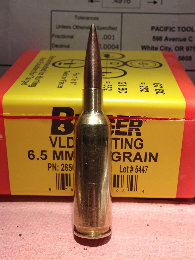

Got a question for those who have processed and loaded rounds using this proceedure? What does your neck measure before and after you seat your bullet? My math calculates .015"X2 + .264" is .294" and given the brass contracts say .001" after turning and when you seat you come up with .295" (.002" neck tension) and the chamber is .296" seems very tight like that would be BR spec's on chamber clearances, but... I could be way off base thus the reason for my question
Not sure where the "brass contracts" comes in to play. After you turn to .015 you have .015X2+.264=.294 loaded round. There isn't .001" growth. Neck tension also doesn't effect the dimension of the loaded round, just the grip on the bullet. The reamer I ordered is .2962 or something like that, so there will be .0022 clearance, which I've never run into a problem running.
So your loaded rounds measure .294"? What does your cases measure after turning before loading? Just trying to get this all straight that's all.
If you turn to .015 (I've found to be precise I turn necks twice at the same setting. Second time cleans up a little and gives more consistency) then you would just take the .015x2=.030 + .264 (if your bullet is truly .264) = .294. Of course all is dependent on how accurately you turn your neck thickness measurement.
Diameter of the neck after sizing does not matter except for neck tension. Regardless of how much neck tension you have, the loaded round will measure the same. There will just be a tighter or looser press fit on the bullet.
