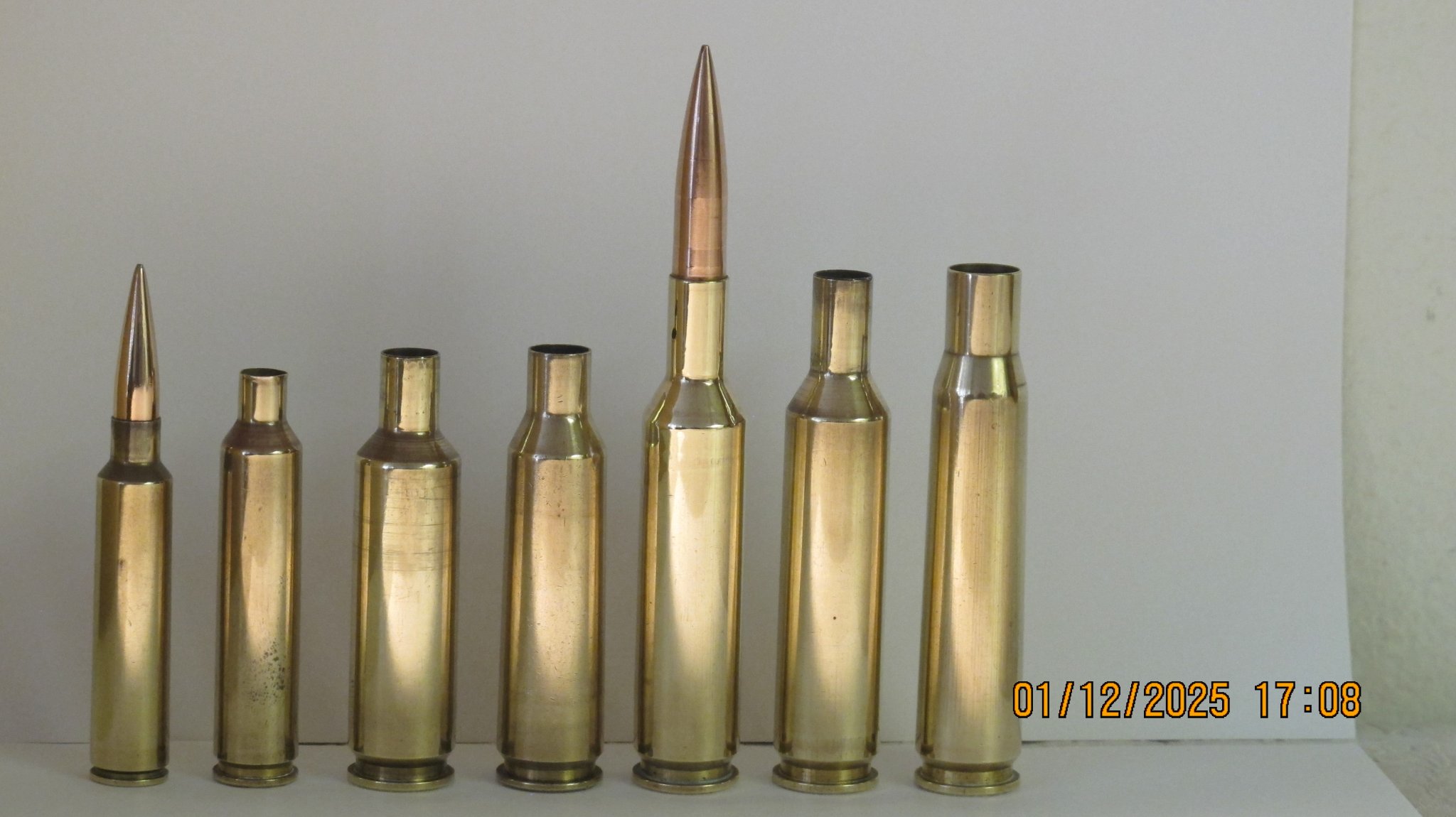

Was doing some early Spring cleaning and decided to polish up my ELR brass collection…and took pics of it.
Smaller stuff (left to right):
.338 Allen Xpress +P (Allen’s 338 LM Imp+, 3244 fps w/ 300 gr. Berger OTMs from a 36”, 1:8.5 twist barrel, 8 ES, consistently – do not recall the exact load, thinking 113-114 gr RL33)
.338 Big Baer – comparo only (CT parent)
.400/.416 Barrett Imp – built but went a different way
.416 Barrett – comparo only
.400/.50 Imp – built but went another way (shown with a custom 480 gr CEB)
.400/.50 Imp – fire formed
.50 BMG – for ref

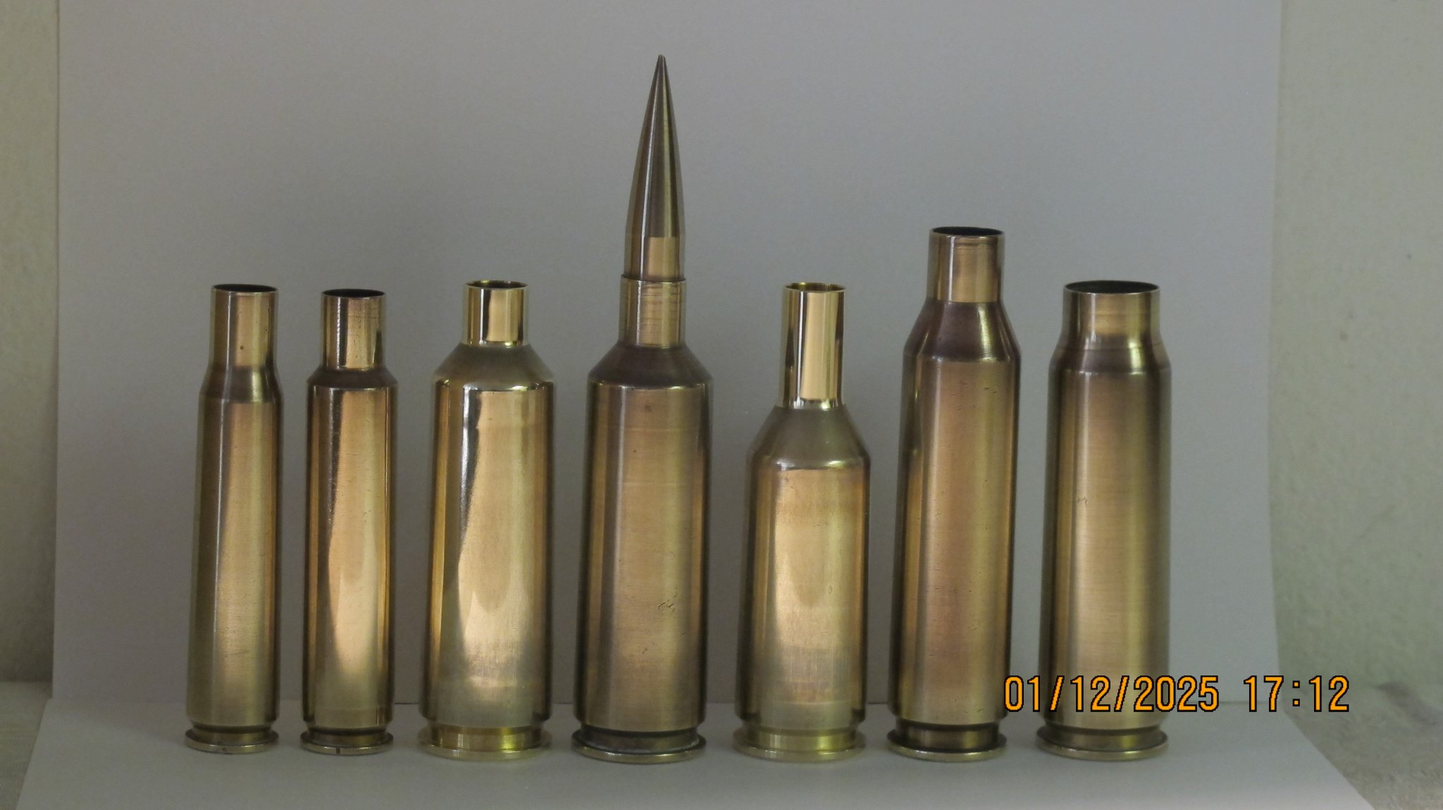

Larger stuff (left to right):
.50 BMG – for ref
.50 BMG Imp – comparo only
.50 T.W., turned and prepped – 20x102mm (20mm) Vulcan parent, never completed project (selling the JGS reamers + Warner Tool dies and prepped cases at https://www.snipershide.com/shooting/threads/50-20-rifle-project-–-component-set-tooling-presses-brass-set-or-part-out-most-recent-reductions-in-purple.6944186/)
.50 T.W. – sample from original owner, bullet ukn
.50/20 Oscar, turned and prepped – 20x102mm (20mm) Vulcan parent, never completed project (selling the PTG reamers + Warner Tool dies and prepped cases at https://www.snipershide.com/shooting/threads/50-20-rifle-project-–-component-set-tooling-presses-brass-set-or-part-out-most-recent-reductions-in-purple.6944186/)
14.5 x 114 Russian – comparo only
20x102mm (20mm) Vulcan – comparo only
