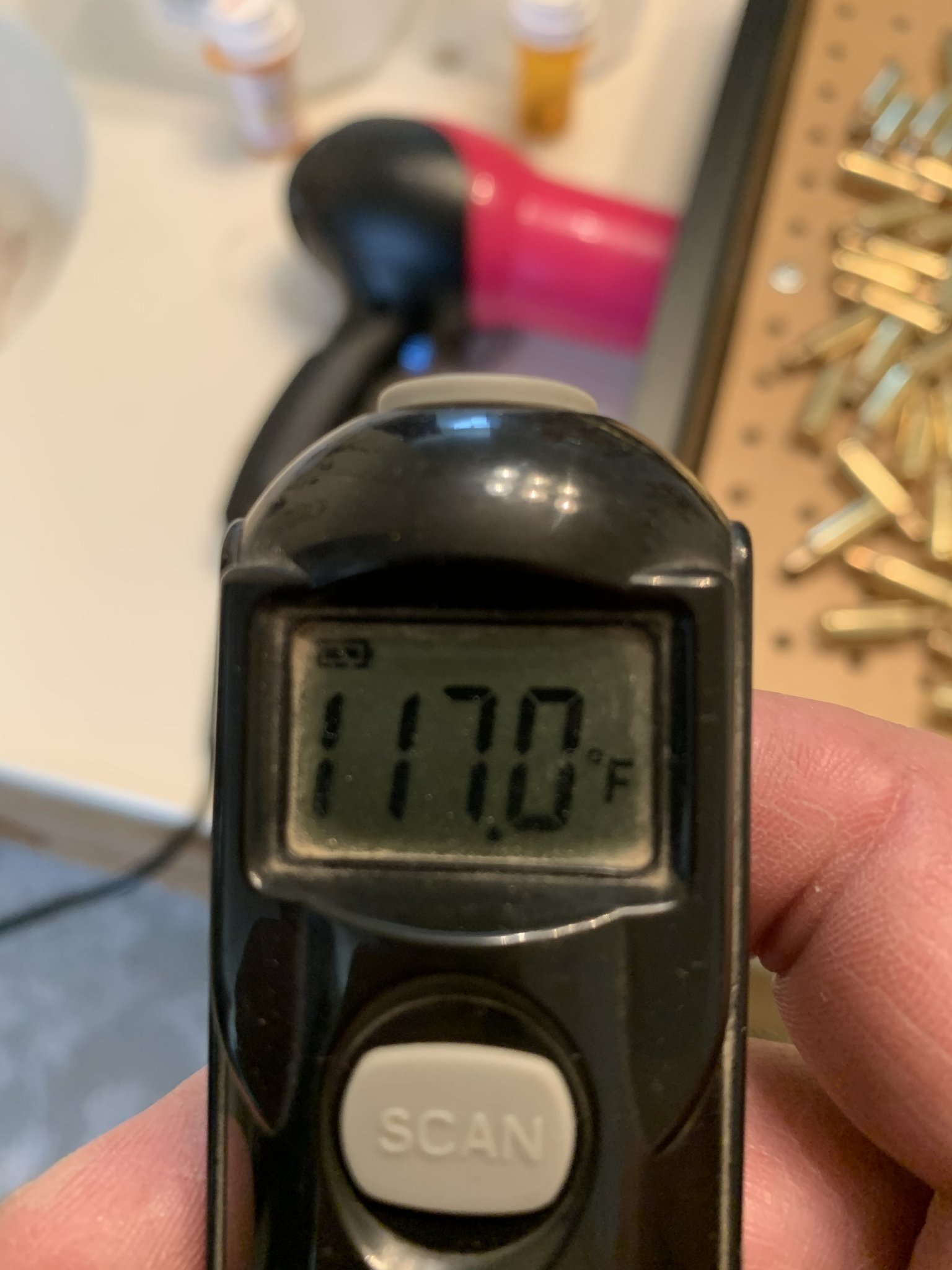

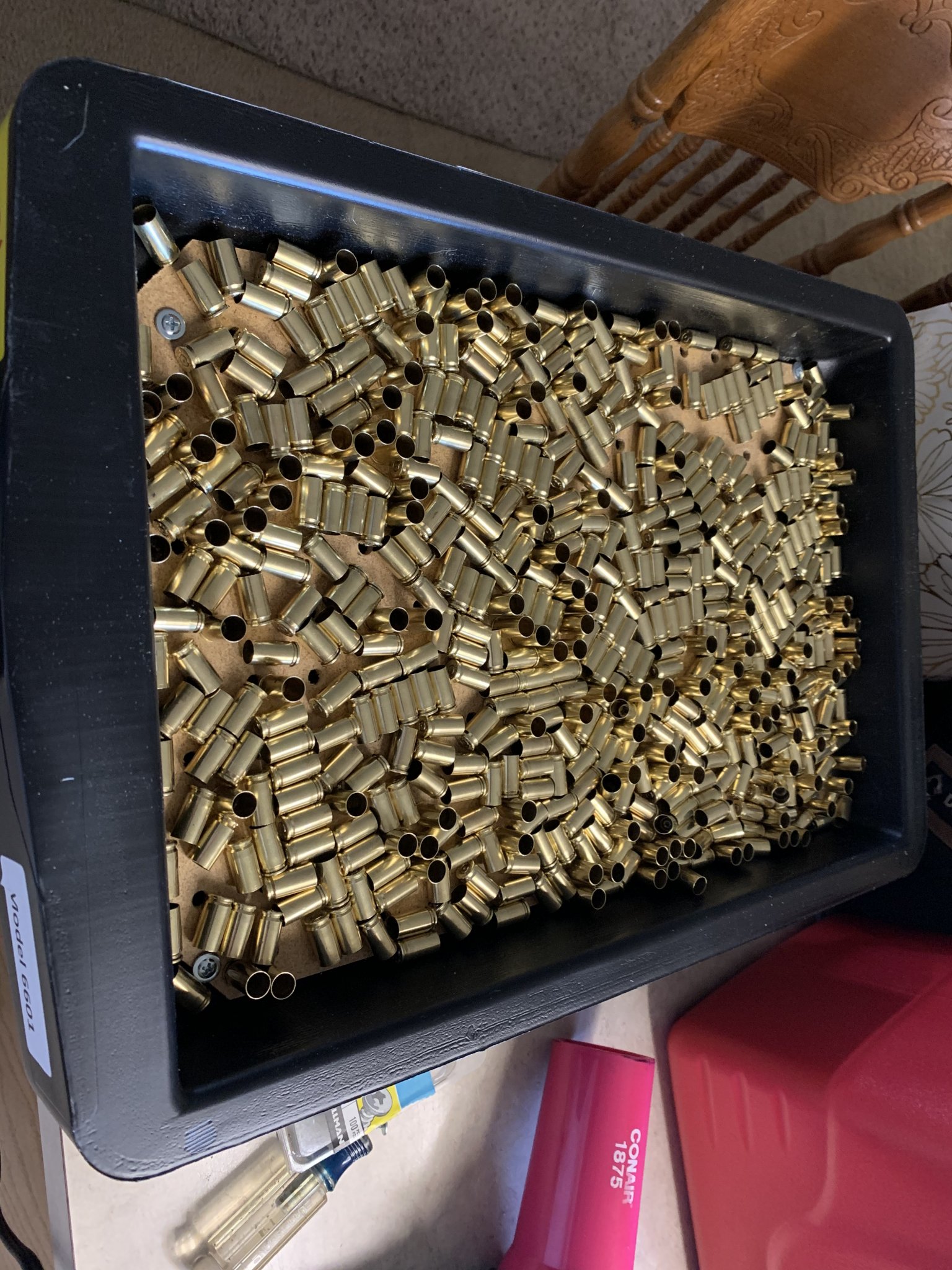

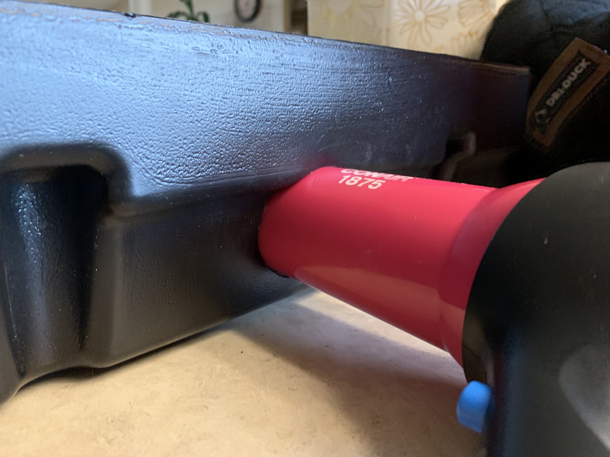

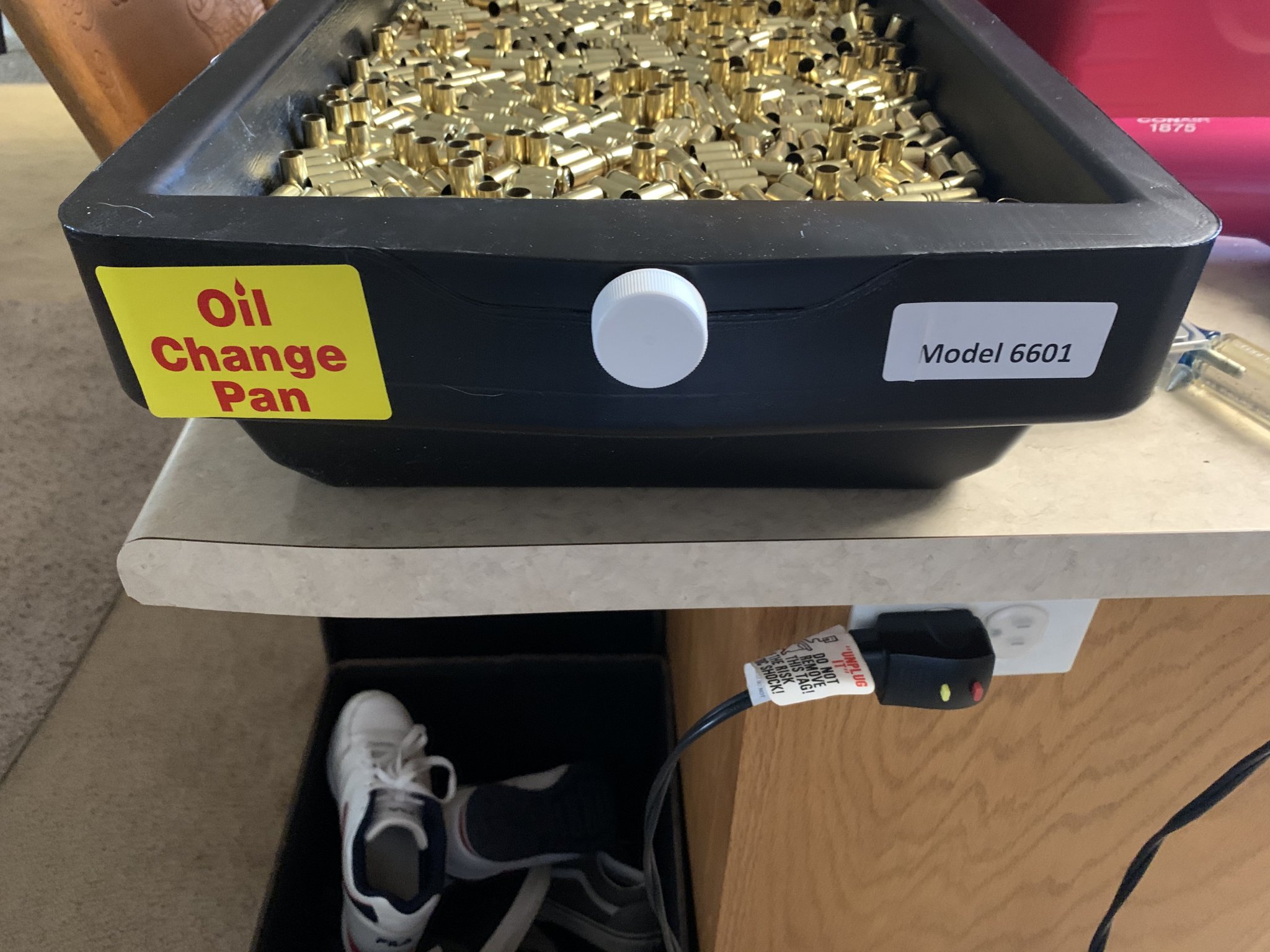

I have a second faster method: Wet tumble, rinse, small pancake compressor from Harbor Freight. I grab about 10-15 cases at a time in my hand, blow them out from primer and neck. Then I take a whole pan of cases and anneal them, natuarlly one at a time. Trust me no moisture. Just another way i do it, because I anneal after 1-2 firings. Just my two cents.

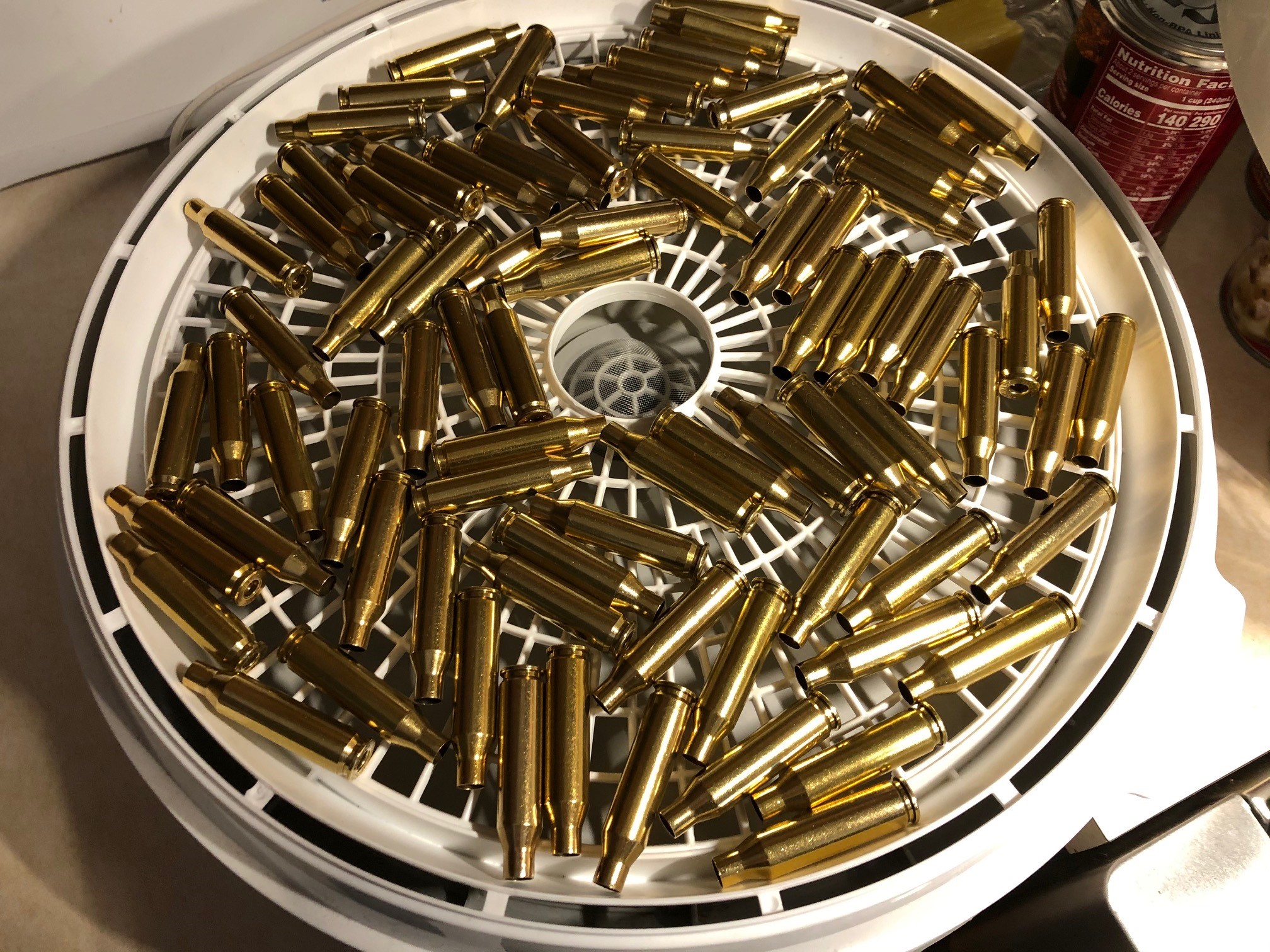

Depends. But 1st lets address you not asking for my Jerky Recipe. :ROFLMAO:
You can get a number of different Dehydrators that have different numbers of trays on them, and many are upgradeable to add more trays if needed. But to specifically answer your question regarding the one I posted a pic of, only cuz it's a popular model at that price point, I'd say around 30 per tray, so around 150. BUT, there are larger ones that will hold more per tray.
I pretty much stopped wet tumbling years ago though, so I don't deal with the pitfalls of it. Just like ultrasonic's. You'll probably revert back to media just like so many others for all the same reasons.

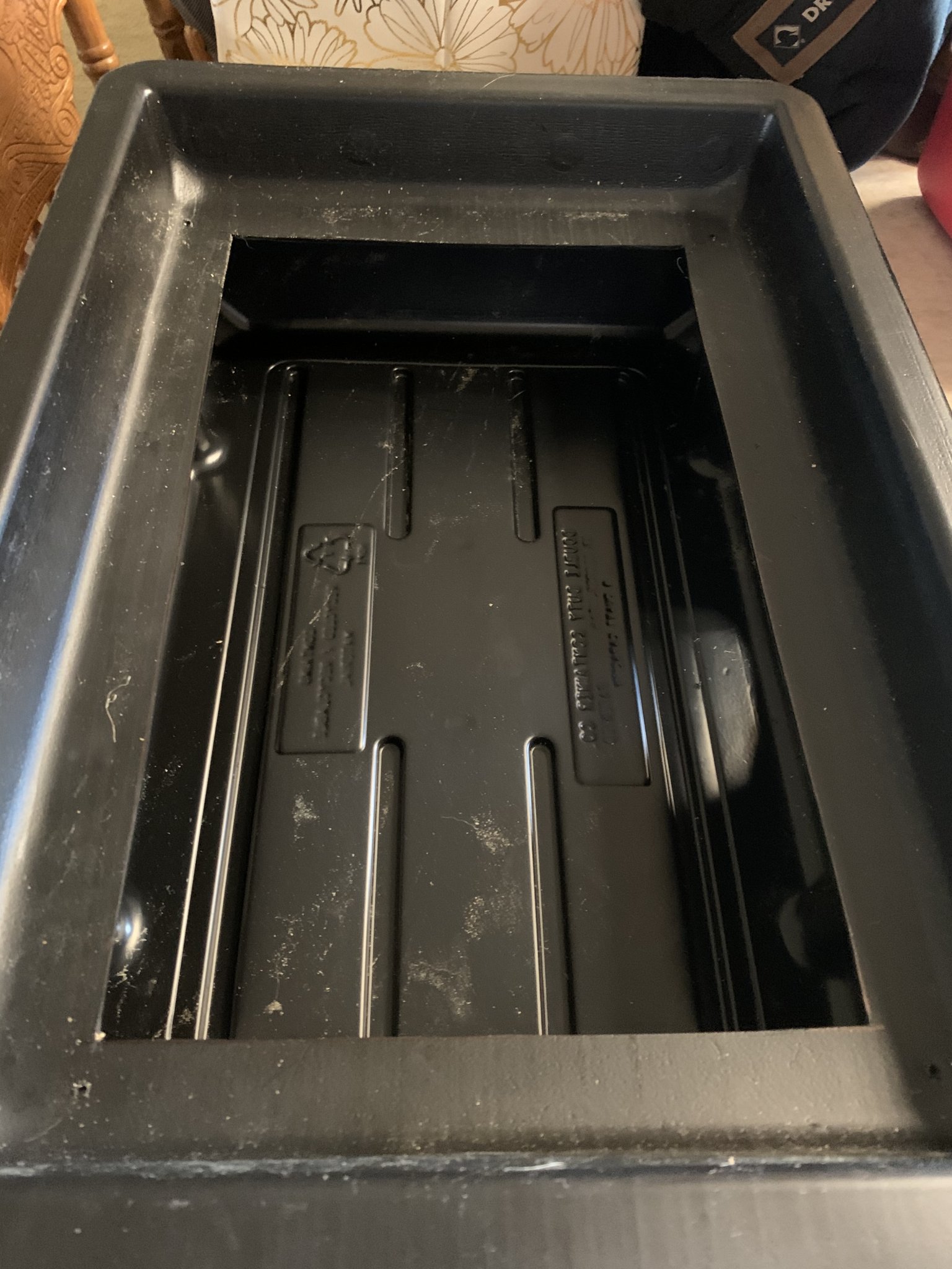

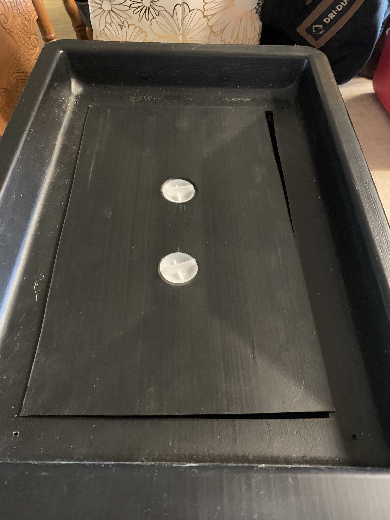

Here’s a cheap easy fast case dryer...oil drain pan $9 bucks...peg board $10 bucks? my wifes hair dryer free...theres 400ish 9mm on there in the pic and they get up to 117 deg.

Walmart dehydrator. I think I paid $25 for the four-tier unit, it does 300 .260 cases and you can buy additional trays if you desire. I let it run for 20 minutes and cases come out dry.
