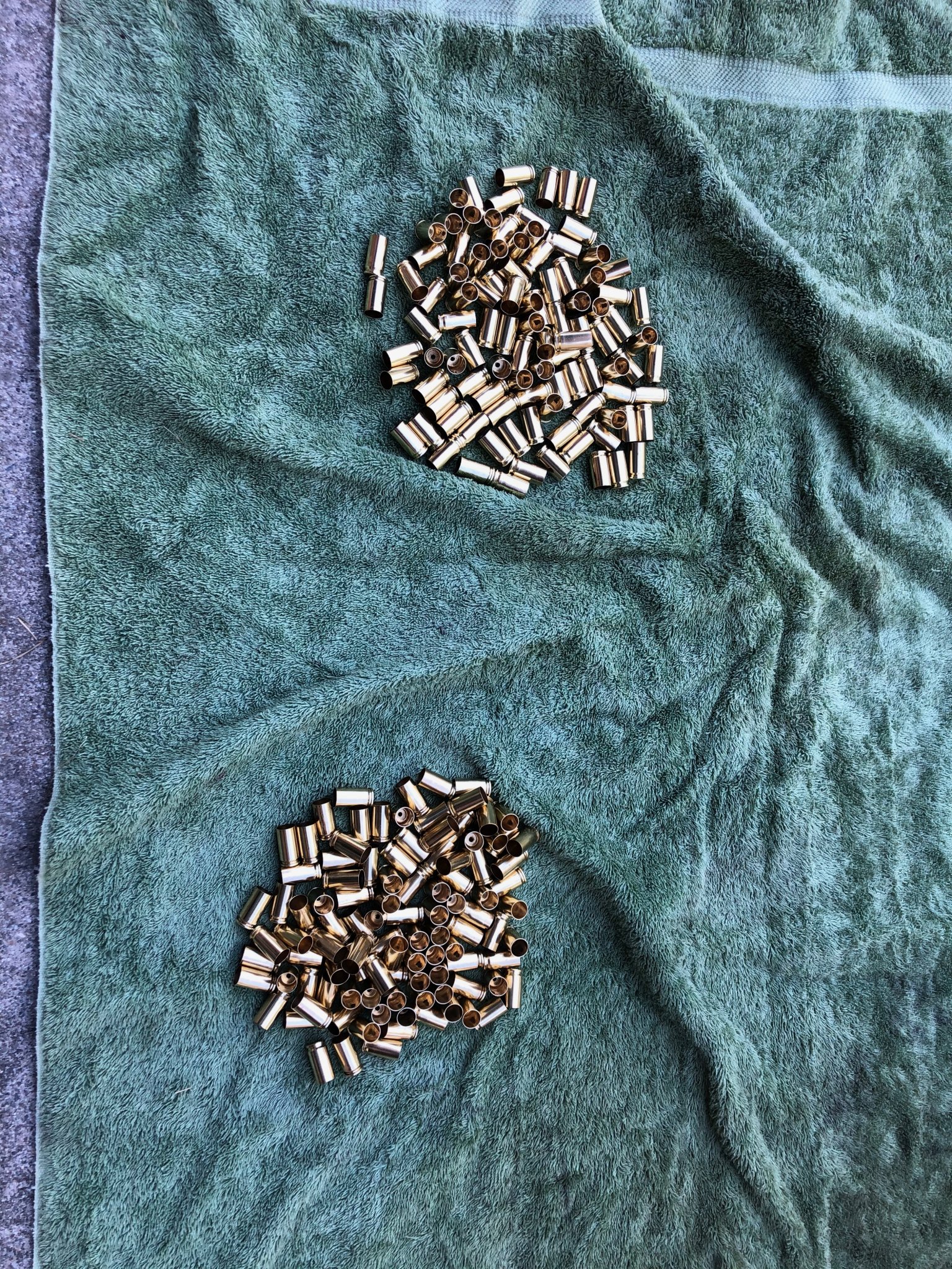

Just started with re/hand loading myself but been using a double can rock tumbler I bought at Harbor Freight for less than $60 and steel pin media with dish soap and a tiny amount of Lemishine. I've only tumbled pistol brass (9mm and 45ACP) so far, but the cases come out looking like new, primer pockets included. I use a Lee universal decapping die to remove primers before tumbling. After, I set them out on a towel in the back yard in the shade and they dry really quickly but it's hot and dry now here in UT.
The longevity of the tumbler has yet to be seen but for the price, I figured I couldn't lose and so far it's doing just fine (about 500 cases cleaned so far), no signs of issues.
