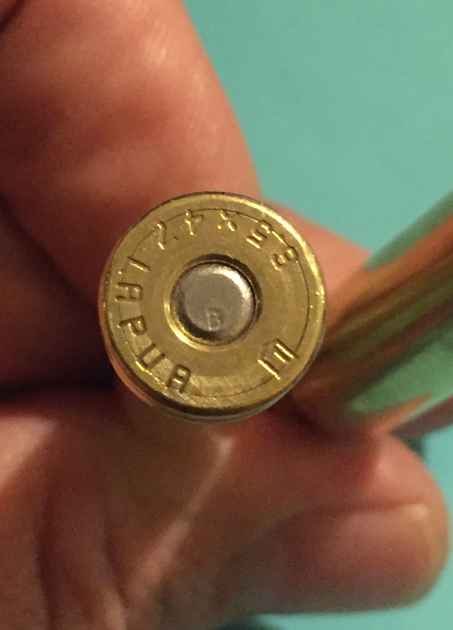

Case rim separation?
Helidriver
Dec 6, 2009
380
111
Surprise, AZ
I'm at a loss as to the cause of this and I'm shocked I didn't notice it while I was loading up these rounds. I was shooting today and while I was checking for signs of pressure I noticed these rings around the case head. Every round in a lot of 100 looks like the one in the pic. My first thought was that they were scratches from the from the bolt face. I stopped shooting and when I got home I cycled a fresh case through the gun several times with no signs of this. It almost looks like the case rim is starting to separate. I've never heard of this. This was the 4th reloading of these cases. Any ideas? Has anyone seen this before?
There’s no way the rim would come off. It’s a solid piece connected to the head. That’s an imprint from the bolt face
The boltface has no corresponding markings on it. The gun is a Desert Tech and it is a little hard on brass but I've never seen this before. After some thought I agree, the web of the case is solid and these marks are well below where the solid part of the case head begins. I think I'm going to go ahead and shoot these. I have no signs of pressure with the exception of some mild primer cratering that I attribute more to the firing pin hole on the Desert Tech and not over pressure.
