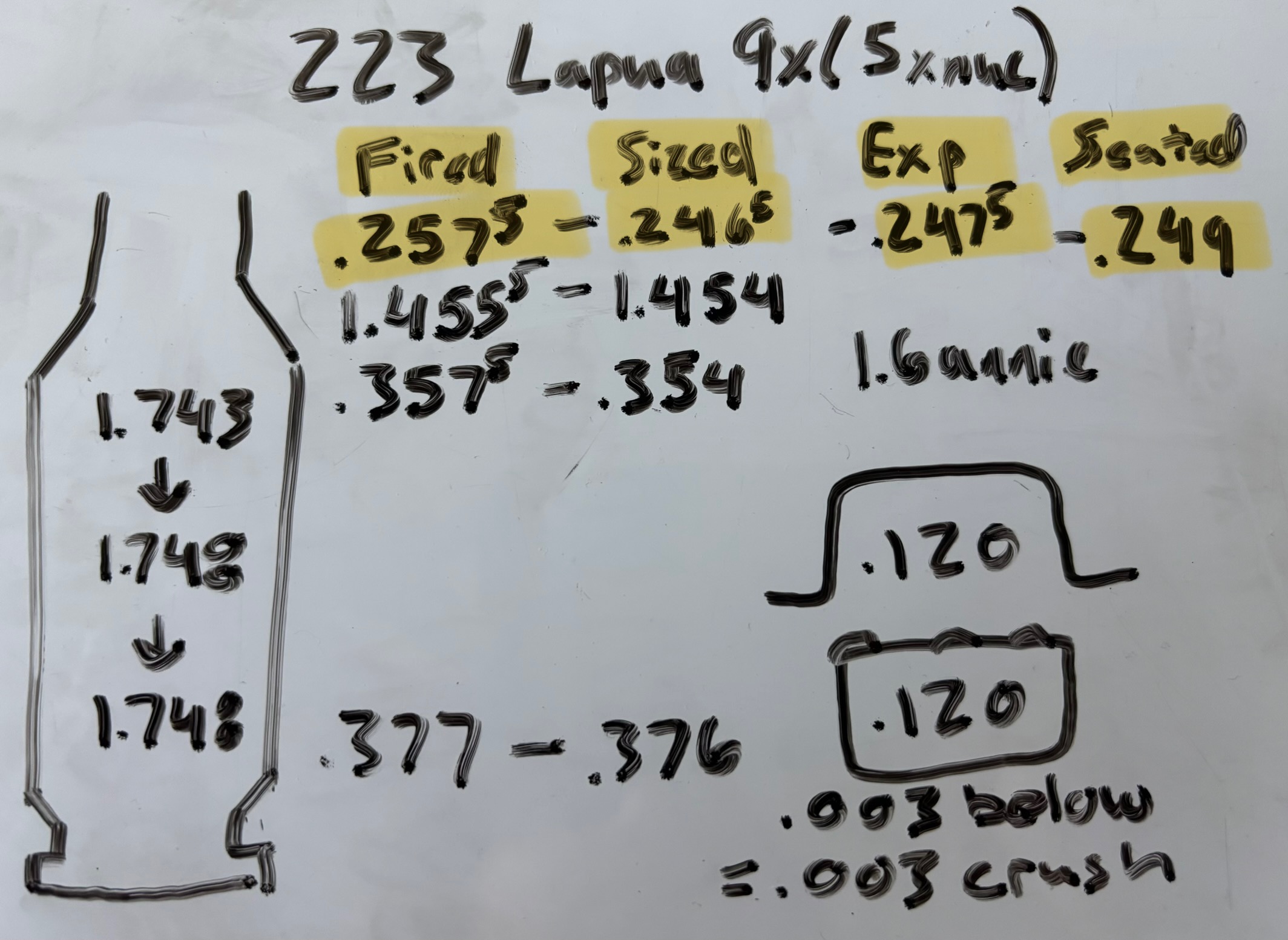

With Alpha 6GT 1x brass your issue is not lack of annealing or trimming.
Also, did you take proper measurements to determine your mandrel? Or just got what you read. Take a piece of fired brass, measure the neck, write that number down... Now size the case in your Forster FL Sizing die and measure the neck and write that number down... Now run that case in your mandrel and measure the neck once last time and write that number down... Now seat a bullet in this case and measure the neck one last time and write that number down.
Now take your once fired brass neck measurement and subtract the Forster FL sized neck measurement. This tells you/us how much you are squeezing the neck down from fired.
Now take the final number from above and subtract the number you got when you measured the neck after mandrel.. This tells us how much you are opening the neck back up after sizing with the Forster FL sizing die.
Now take final number from the above question and subtract the number you got when measuring a loaded case neck. This number tells us how much neck tension you have...
This will tell you how much your squeezing your neck down from fired with the Forster, how much your opening it back up with the mandrel, and finally what your loaded neck diameter is so we know how much neck tension you have. Non-honed Forster FL sizing dies are known to excessively squeeze the neck down way too much. This is so the die works with all types of brass...
Just to illustrate the fired, sized, expanded, seated neck diameters
Reactions: R_A_W and padom
