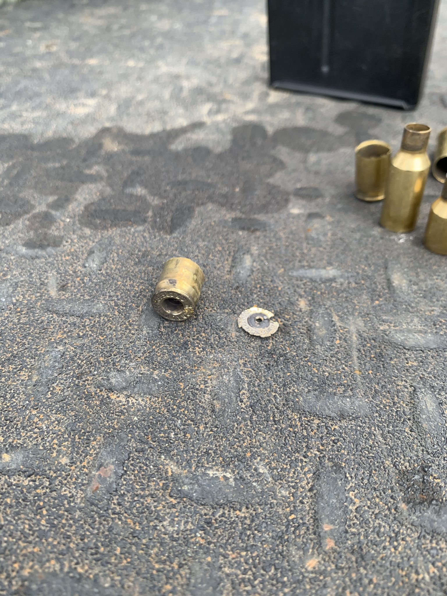

I’ve got a savage 12 FV in 6.5CM (Bare with me)
The only thing I’ve done to this rifle was cut the barrel down to 20” and drop it in a MDT chassis. It came from the factory with a 26” barrel and a cheap stock.
Today was the first time shooting it since I got the barrel and chassis completed.

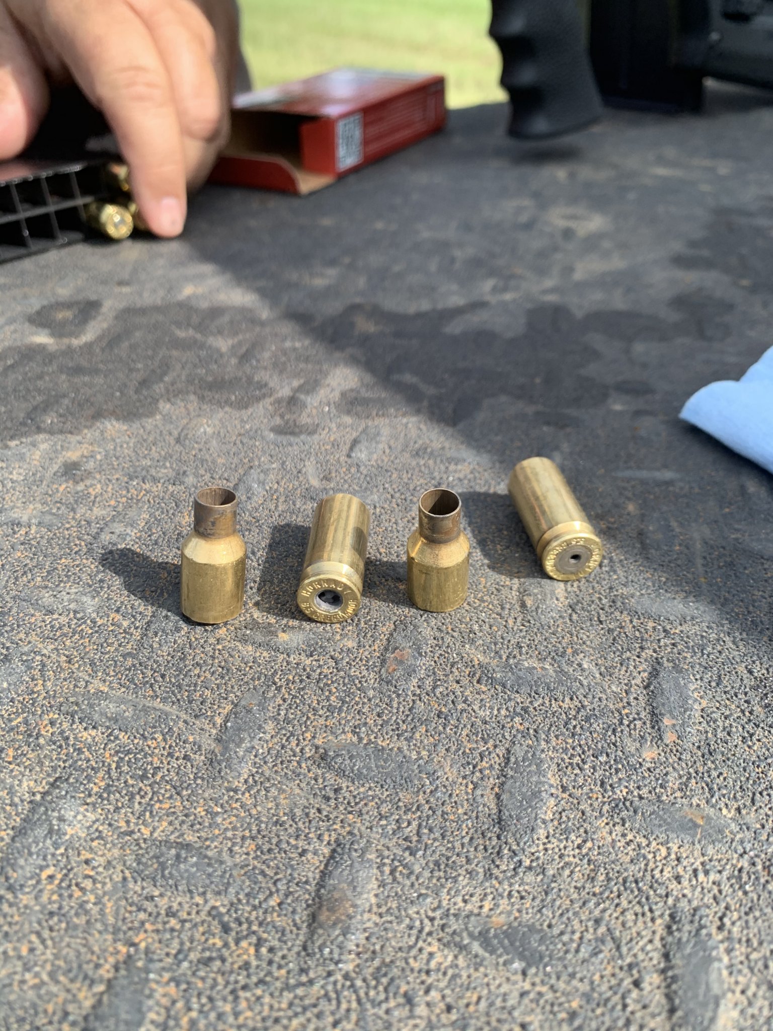

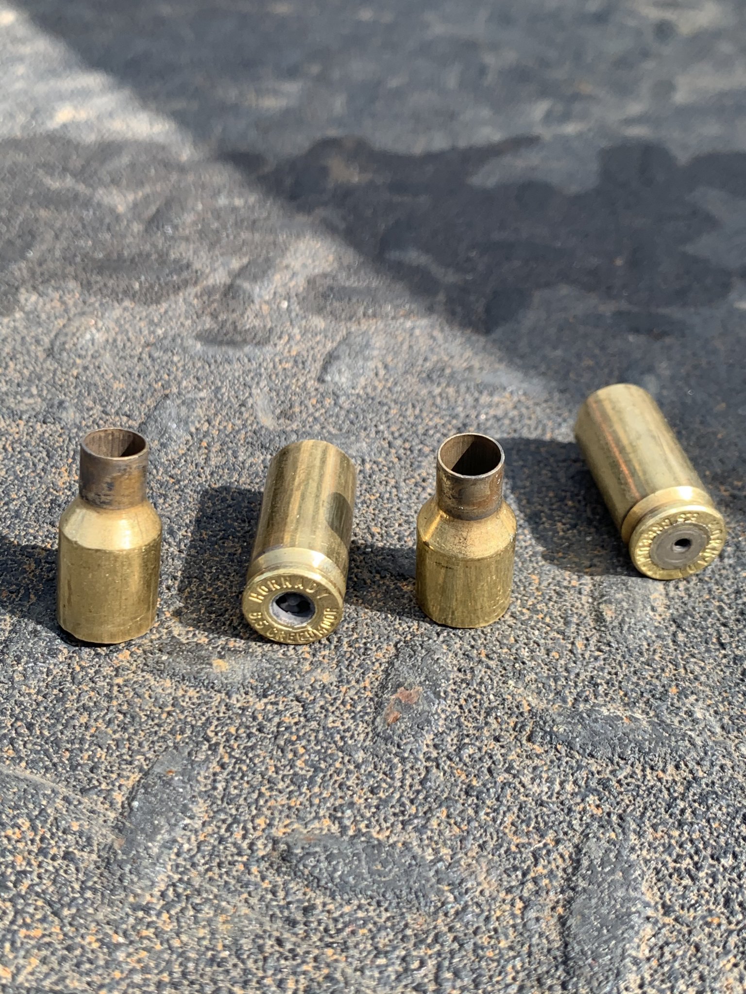

The picture attached is the first 4 shots.
Extractor is broke as well.
I was shooting suppressed and Hornady factory ammo. (140 and 129gr)
Wth is wrong?
Thank you.

Headspace issue or over-pressure loads. Is that factory ammo?.
Loose barrel?
I didn’t personally cut the barrel, so I’m awaiting an answer from the gunsmith for that.
Yes, I’m not shooting the rifle anymore until I figure out the issue.
Yes, factory loads from Hornady.
Just like the others have said excessive head space issue.
Look at the pic of the brass that still has a primer in it but is blanked, it was slammed back into the bolt face and smeared all the way around the primer pocket.
Glad you weren't injured and if the GS put the barrel back like that I would be having words with him.
Two thoughts, the first one is a real outside guess and both are way outside the box of conventional thinking.
First, Is the threading true on the muzzle of the barrel? And is the suppressor the correct size for the caliber?
Second, we were getting case splits when shooting very light handloads. There was not enough pressure to force the case to grip the chamber walls and the firing pin shoved the case forward stretching the case. However, I have never seen or heard of this with factory loads. So, have you fired this particular lot of rounds before?
Finally, are sure this is your barrel that you sent to be cutdown.?

So, I see at least 6 pieces of cartridges in one pic, and that box of ammo in the other pic has at least 7 empty slots, possibly as many as 17. How many did you fire before you decided there may be a problem?
Hornady brass may be underwhelming, but it is certainly reloadable a number of times. One case separation should be enough to stop...

I agree with most of the others about it being a head space problem. I would get a "good" gunsmith to look at it. I saw something similar when a guy put a thicker recoil lug on a Remington without doing anything else. Duh!!!

Gunsmith claims he did remove the barrel but checked against savages specs when he spun it back on... I’m also calling bullshit because obviously there’s an issue that wasn’t there before. It came with a 26” barrel and it’s a hunting rifle so I didn’t want it so long when I ran it suppressed. Figured it was a simple request that could be completed with no issues since he’s done dozens of my rifles in the past with no issues.
Bolt face is destroyed and looks like I’ll be ordering a new bolt tomorrow.

I'd have found / purchased a field gauge / no go and some shim stock so I could find out just how far off that barrel was before he put his hands on it again....
If you feel he is trustworthy then disregard, but I'd have a good idea before has was alone with that rifle again

So I have two of these rifles. Both are model 12’s FV. This one in 6.5 CM and the second in .308.
They LOOK to take the exact same bolt, is it possible for this to happen if the bolts got switched? I believe they are the same bolt face but I’m also trying to eliminate any errors on my end.
