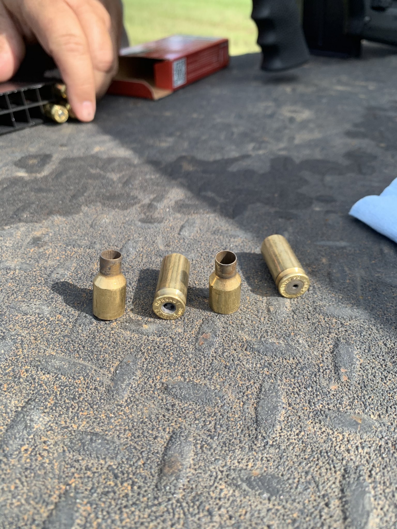

okay so spoke with the smith late last night.
everyone on here was right (never doubted that) it was a big headspace issue. he claims while recrowning the barrel that some shavings must've gotten around the threads which didn't allow him to torque the barrel back to the correct headspace. he's admitting to not checking the headspace since he "figured" he spun the barrel back to the same place as before. he said he was embarrassed of this and apologized 400 times. he offered to replaced my bolt but I declined since savage didn't charge me for the replacement parts. he also offered a big discount on the next project.
I will be more cautious next time and I think he will too. mistakes happen, I'm just glad I or anyone around me wasn't hurt. I appreciate everyone's time and help with this.
Would like to know how he "figured" he spun it back to the same place. It takes very little threading to start making big changes in the spacing. Sounds like this is his normal operating mode, not really an honest mistake. Who spins a barrel back on and does not at least run some gauges in it?
Don't go back to him....ever.
You never "spin it back to the same place" with a barrel nut system, i.e. Savage 12 (any 10/110 series). You do that with a fixed shoulder type system, i.e. Rem 700, Win 70.
I agree with what was said earlier that not only is this a headspace issue, it's also a high-pressure issue. If you fired those with the suppressor on, I would check that out before you fired again. You may see a bullet strike in there. If you don't and still want to fire this, I would put it under a sandbag with a string on the trigger to fire it.
There is the possibility you got high pressure from a secondary ignition when the case separated.
All told, I hope that rifle is coming completely apart and is fully inspected before you attempt to fire it again.

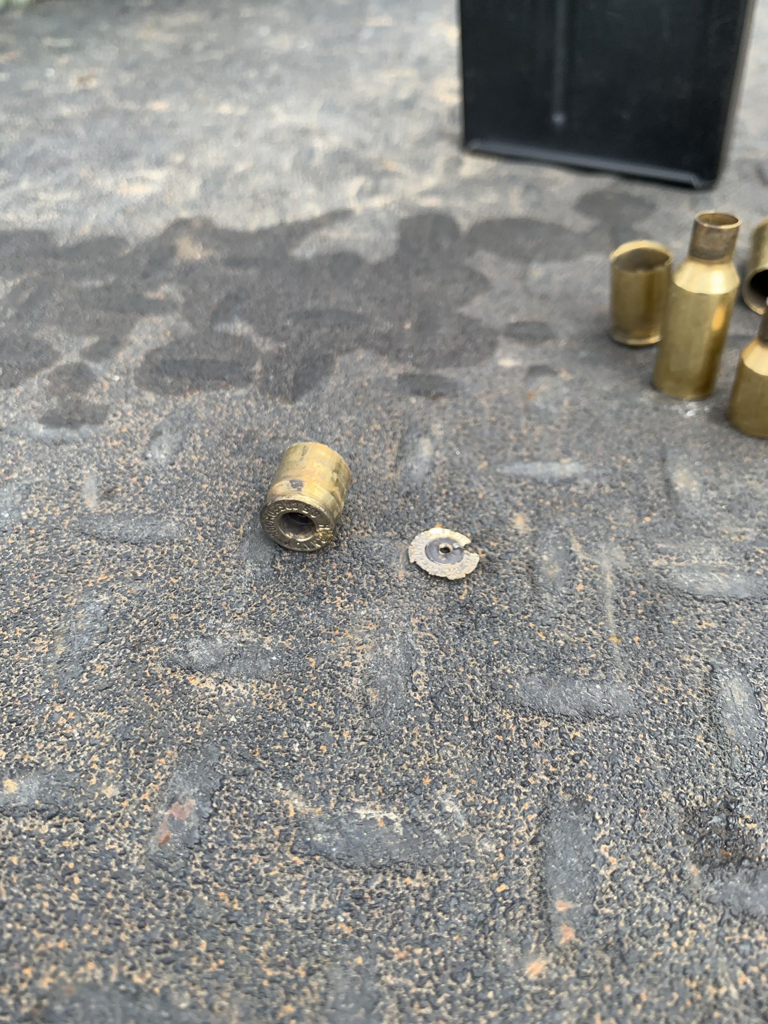

after the case splitting's, I was getting light FP strikes. so it went from firing to nothing. I was annoyed at this point. I've learned from this though.
Maybe we can all learn something.
The light strikes could be from the disc blanked out in the middle of the primers. On blanking the firing pin travels to the rear. That's what breaks triggers. If the firing pin has enough rear travel and the tip comes out of any support area the disc gets inside the bolt.
That smith is a fucking idiot. I guarantee you that he just spun the barrel back on and torqued the barrel nut where it looked good without ever taking a measurement.
With over pressure like that from his fuck up that dude would be buying the barreled action from me for what I paid and reimbursing for his services.

You could also measure the unfired cases in this batch to see if the cases are short. Don't know if you plan on realoding, but if you do I would get some good measuring tools from Brownell's or any other good supplier. A simple Wilson case gauge will tell you a lot; if the cases are too short shoulder to case head, you have definite headspace issues related to that batch of ammo. I see a lot of short cases with Lapua and Wolf in 6.5 Grendel (factory loads and loose brass). It's probably a safety feature (according to them); maybe it ensures feeding, but raises hell with cases and case life if you reload. Lapua cases come apart before the case head after a few firings in the Grendel and it is because the short cases stretch too much. When you resize and squeeze back all that stretch, again giving you the headspace issue, the case walls will soon fail. Eventually you will see a protrusion when you try to resize, almost like a small belt, something less than a belted magnum forward of the case head; the case has failed and will no longer chamber. Hope this isn't too much, but it IS very stasifying to now all you can about your gun and the ammo you fire. I forgot if you are shooting a semi or bolt, but if it is a semi, there's a whole other world of knowledge waiting for you if you're going to be successful. Enjoy and don't get blown up!
The “gunsmith” said he pulled the barrel off and Inspected everything. Said he didn’t see any signs of excessive pressure from the few rounds I did shoot. He said he also didn’t see anything on the borescope. Headspace is now “perfect” and it was off A LOT. He took the fault and admitted it.
Suppressor is also fine as I didn’t see anything wrong with it or any baffle strikes.
The gun shot great before the barrel was cut down. All I’ve had done to it is cut the barrel down from 26” to 10” crown and thread. Dropped it in a MDT chassis and those where the first 3 rounds.
I’ll get it back Friday and once the parts from
Savage arrive, I’ll rebuild the bolt and see what happens.
Worst case, I’ll replace the barrel sooner than expected...

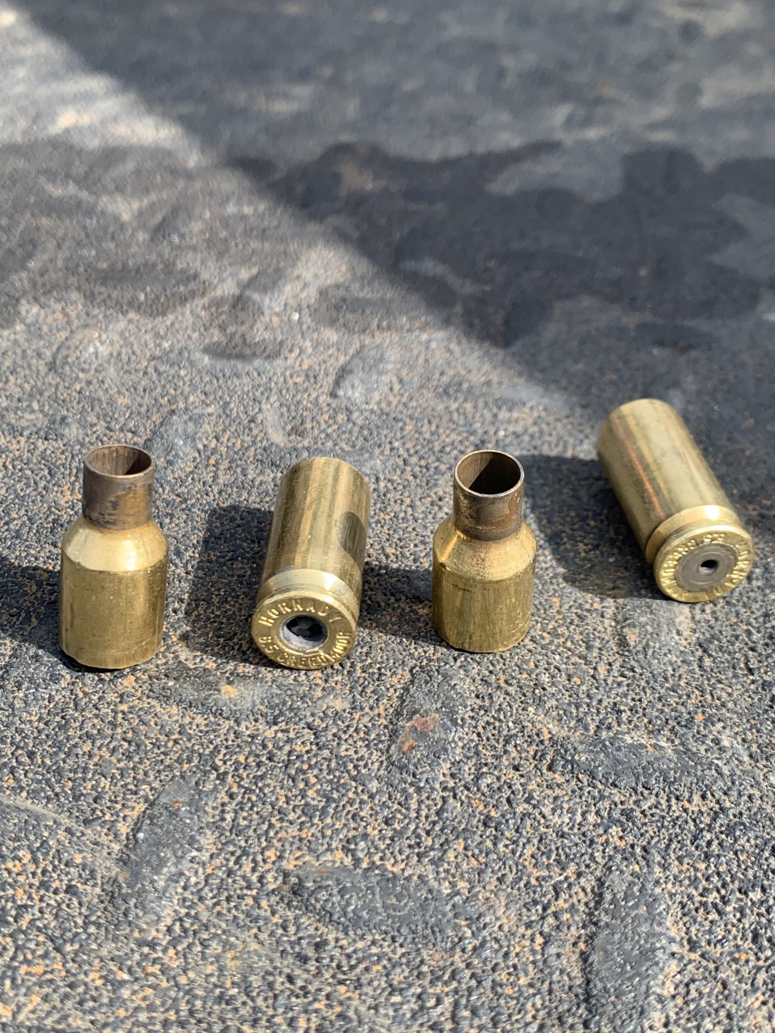

I’ve got a savage 12 FV in 6.5CM (Bare with me)
The only thing I’ve done to this rifle was cut the barrel down to 20” and drop it in a MDT chassis. It came from the factory with a 26” barrel and a cheap stock.
Today was the first time shooting it since I got the barrel and chassis completed.
The picture attached is the first 4 shots.
Extractor is broke as well.
I was shooting suppressed and Hornady factory ammo. (140 and 129gr)
Wth is wrong?
Thank you.
Had you ever shot this rifle before cutting it down? If so, what results did you get. I would hope your smith removed the barrel for cutting on a lathe rather than by hand. If he did, the head space problem lies with him. That's why I asked if you fired the rifle out of the box. Many shooters like shorter barrels on their rifles. Happen that a 26" tube with a 1:8 or paster twist with 140gr. bullets is a great accuracy combination.
Last question. Did you cut the original barrel or replace it with the shorter tube?
yes, shot it for two years no problem. once I finally got my can I wanted to cut this one down so the overall length wouldn't be stupid. this is the original factory barrel. just sliced off 6"
I've got a .308 in the exact same model and I had the barrel cut down from 26" to 16"... shoots great suppressed or not.
