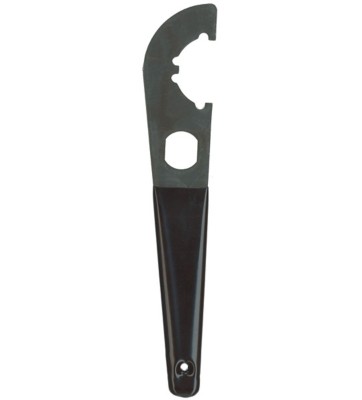

As the title suggests, I'm looking for recommendations on Castle Nut tools. I have a standard AR armor wrench, but it chews up the buffer tube threads when torquing the castle nut.
Does anyone know of a tool that won't chew up the buffer tube threads? Hopefully, at a reasonable cost.

The Magpul one is nice from the standpoint of encircling the castle nut to minimize slipping. Also, when using any tool on it, "anchor" the tool by exerting force forward to keep it engaged in the slots.

I own several and the Midwest Industries wrench works best.
More importantly, how are you securing the lower? The NCStar Lower vise block is a great and inexpensive way to secure the lower while using the wrench.

I was using the NCStar tool that aligns the buffer tube on the last two that I was rebuilding when I made this thread. In the past, I've just used a mag well vise block.

My favorite castle nut tool is the echo Zulu armorers kit. I got it from Brownells (#430104730) but not sure if they are still available. They also sell the individual pieces of the echo zulu kit. Echo zulu might be selling them direct now?
