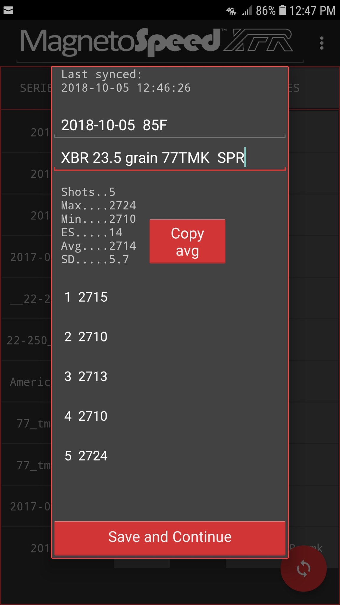

I haven't used the 41's but here's some BR-4 data
Unknown brass (most likely from American eagle)
CCI Br-4
XBR 8208
77 TMK
Rifle is a WOA SPR 18 inch, suppressed, JP SCS...etc....
Reactions: JimmyT
