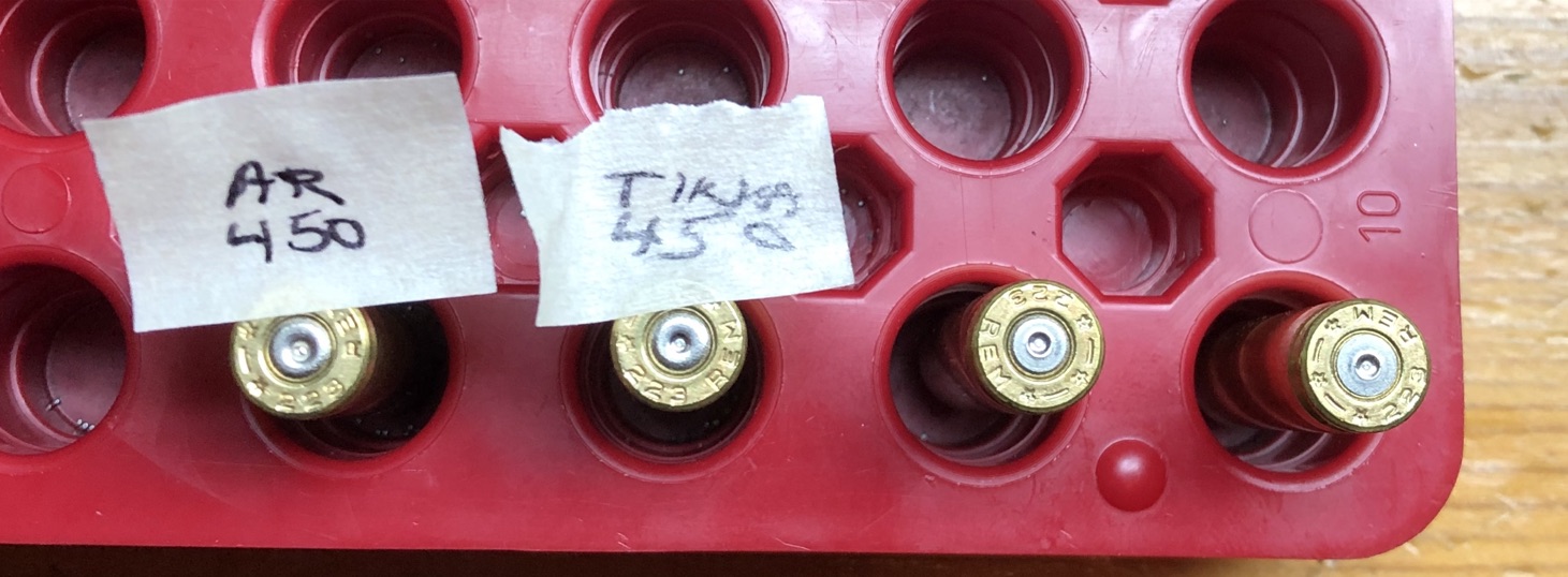

In the image below, the left two primed cases were "fired" without powder/bullet for comparison - one in an AR with milspec fire control unit, the other in the Tikka. The primer strikes look sufficient to me. The case 2nd from right was loaded with CCI450, 24.0gr H335, and 77gr SMK - a bit stiff. The rightmost case was loaded with a mild charge of 22.3gr H335 behind the same 77gr SMK, but with CCI 400. Note the degree of flattening. With a CCI 450 primer, I don't see that much flattening short of 24.5gr H335. Edit: the H335 load data specified Winchester SRP, which reportedly has 0.021" cup thickness. CCI 400=0.020", CCI 450=0.025" thickness.

There are a few possible reasons:
-Bum primers from the factory. But a failure rate of 15-30% seems really, really unlikely.
-Contaminated primers.
-Primers not seated deeply enough. Accurate Shooter Link Inconsistent pocket depth may cause seating depth issues if you're using a priming tool with a fixed depth.
-Cartridge not seated fully in chamber due to dirty chamber, bolt, or ammo.
-Weak firing pin spring.
-Firing pin too short.

A trip to the range gave me a 100% "bang" rate and the primer indentations are more typical - rounded, not flat, at the bottom (of course, an over-sharp tip could result in pierced primers). It appears the issue is resolved. Sample size was only about 20 rounds, but heretofore I'd get two or three FTFs out of 20 rounds.
