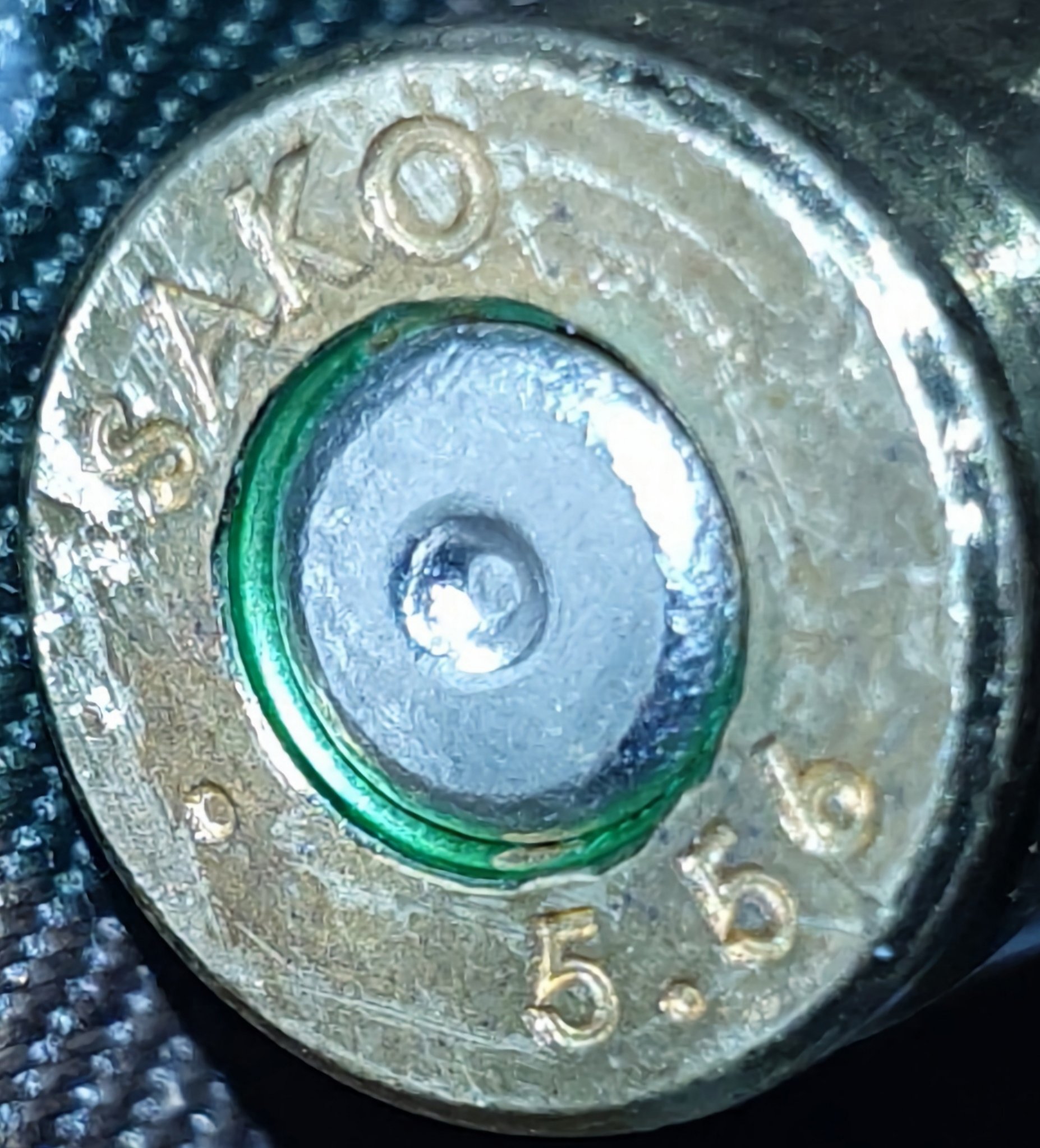

    I recently aquired few CCI 400 primers and having been using the CCI 450s I tested them a little bit.
    Again, I could not find solid information about the comparison between these and thought to settle this once and for all.
    Some commenters said they were piercing them and some said they worked well.
    I went to test them and they indeed work pretty well. For a beginner me they would have been better to use since they indicate pressures better than the magnums.
    I loaded slowly up from 23grs to that 25.5grs but I think the 25.5gr shows the best the difference between these too. In the picture you can find the CCI 400 in the left-bottom corner.
    *Bullet used was Scenar 77gr.
    Yeah, but calling them not enough good for 556 is stretching it. The 25.5gr load clocked 2770fps from 16". Not sure what the average MV would be, yet.
    I loaded 25.8gr too but did not shoot it, the primer is a bit flatter than can be seen from the photo and had a slightest bit of cratering. And, 25.5gr is way above my common load, 25.15gr.
    My take on it is that for 223/556 you can use the 400s well enough.
    It almost seems like 450s are meant for magnums..

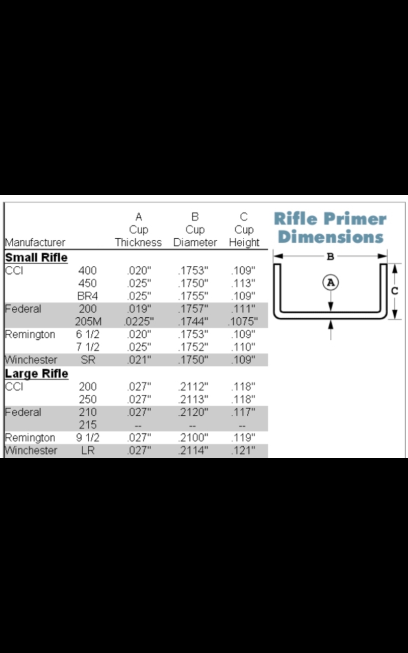

    I have measured both 450's and 400's and there is a substantial difference in the cup thickness, height and
    anvil shape. I would never use 400's in a gas gun or in something that has a large or loose firing pin or with
    high pressure loads.

    Looking at the OP’s pics I see a problem brewing. All my cases have a nice round FP indent marks even when the primers are flat. His primers are about to pierce. His 400s gonna pierce before his 450s will.

    They are when a bubble starts to form inside the FP indent.
    I have a rifle that does that with starting loads. Sorry but I'm not sorry for being unwilling to care about it. The spent primer is going in the trash anyway.

    I’m talking about the CENTER of the FP indent, not the outer perimeter.
    What should I be looking for if those indicators mean I'm well past?
    My FP is little bit worn, last year I shot few hundred Magtechs until I noticed they were piercing, around 4-6% of them. I returned them back.
    My FP was probably torched in that. I have not had problems since but I do have a spare FP if the current one produces problems.
    Reactions: 338dude
    The bubble forming on the inside of the indent isn’t caused by the condition of the FP. I’ve seen this with brand new pins. It’s a pressure curve thing. I think your load is generating too much pressure too soon in the combustion cycle.
    Reactions: 338dude
    I believe you but I want to add that I have seen this even in the lowest pressure charges I have done. I think this case is shot with the minimum charge VV lists for N540. But the pressure loads may make it more pronounced?

    It's not surprising to me at all. There is no need for a magnum primer to shoot 223 with extruded powders, which is what I've been saying all along.
    Well yes, and no.
    Why does the #41 exists then? I guess the reason is to go the extra mile, just as with crimped primer pockets.
    The thought behind this is the reason is that a customer making the order has noticed lack of quality in product (not necessarily with CCI, might be related to another manufacturer) but nonetheless, orders little bit stronger parts and fault mechanisms because it has experiences related to basic tolerances not living up to expectations.
