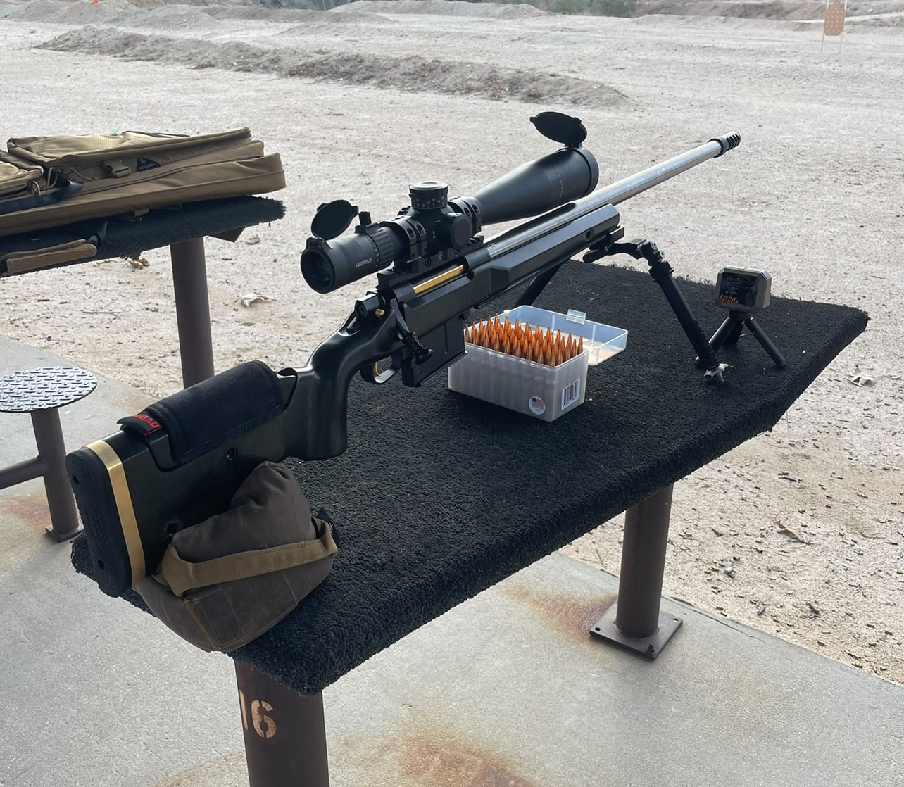

Also, Originally had mine in a MDT ACC chassis and it would not stay tight in the chassis. i ended have to cut a custom length screw. Once it came loose with the longer screw I then had to lock tight it into the action. I got rid of the MDT and put it in a Foundation and no more need for a custom length screw or lock tight. I dont think the aluminum is strong enough for the engery that the .532 casehead cartridges put out. Just my two cents.
What action inlet did you pick for that foundation? I’m about to order one and wasn’t sure which one to get!
for my build I have it chambered in 300 Norma improved 35deg. I originally had a tt diamond in it but it had problems not catching the sear, talked with arc about it they suggested the special or diamond 2 stage. Went with the 2 stage and that has functioned 100% so far. I have it in an mdt acc currently and I am also having action screws coming loose as mentioned above. I talked to mdt about it and they sent me a new acc base that I am yet to receive to test out. If the problem persists I will change chassis to something else.
