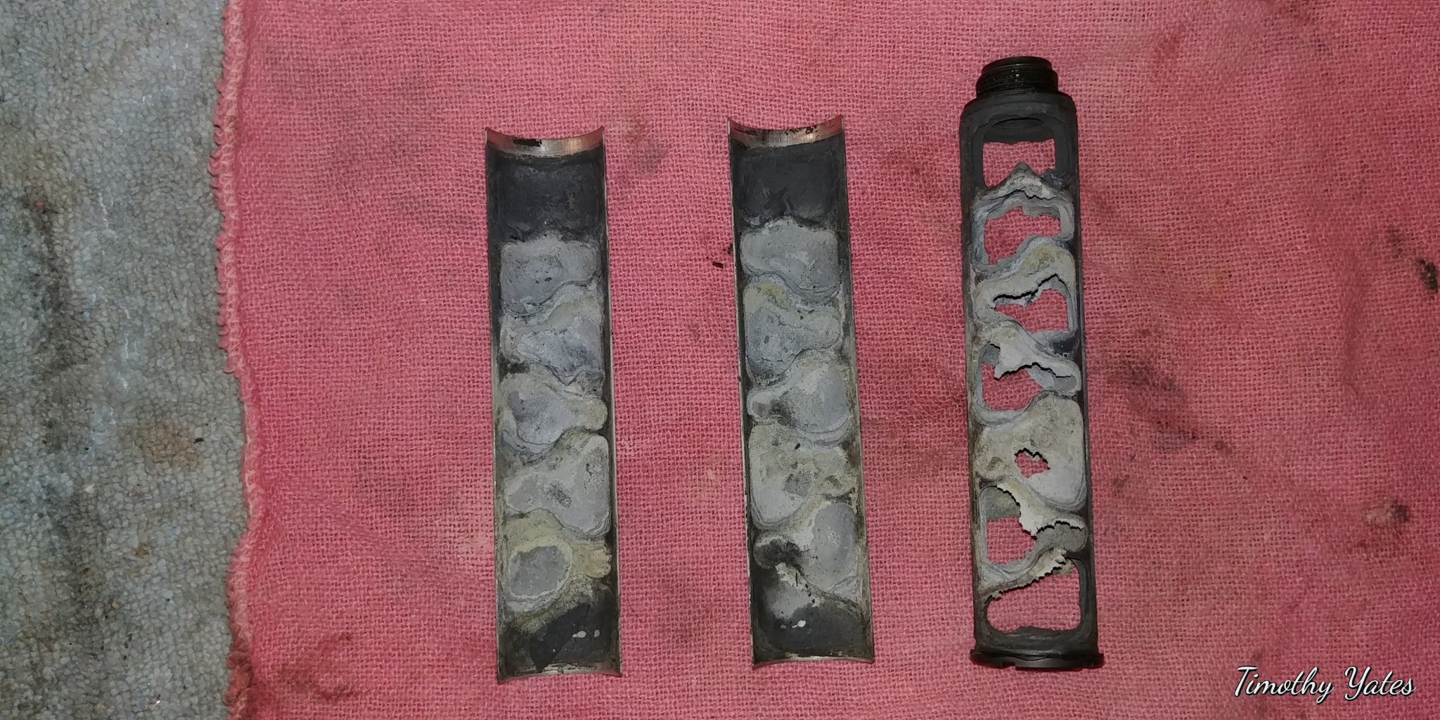

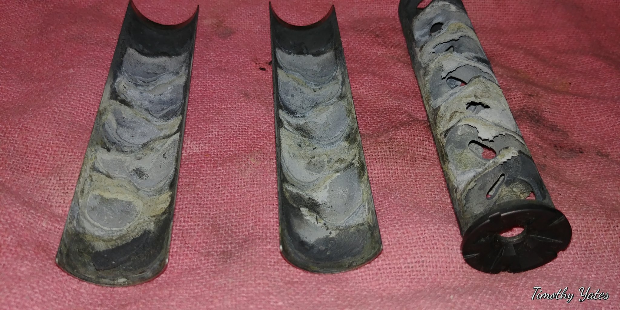

Well, if you shoot it too long before trying to clean it, itt could end up looking like this Sparrow.
I use a mixture of 50/50 white vinegar and hydrogen peroxide and let it set overnight. That solution is not to be used on aluminum.
Been mentioned but I'll say it again, that also forms lead acetate which is skin soluble and highly poisonous so be damn careful if you do that, it's the easiest way to get lead poisoning in a significant dose I know of. It's no-shit hazardous waste and should be treated as such. In presence of copper it'll form copper acetate which isn't exactly food safe either.
An ultrasonic cleaner is much safer and I'm sure works much better --I have one but prefer Kroil and brush and just a quick cleanout, no point in detailing one, but I'm talking about takedowns. I don't really clean the centerfire can past the blast baffle.
I wouldn't use a nice sealed centerfire can though, fuck that. Rimfire and centerfire are night and day. IF you MUST have a bigger can, get a Liberty Mystic X or some shit that's still takedown and still has other uses (they make fine 9mm SBR cans IMO). Or hell, just tape a lead weight to a normal .22 can where it threads on if you just want it heavier.
Most of these cans have lifetime warranties so last thing I'd want is to void that over something like this. Especially something like an Ultra 7. Hell, every summer Capitol Armory and/or Sico GIVE .22 cans away if you buy something else!
Bottom line, a person is going to do what they want to. As for the ultrasonic cleaner, everything I have used in mine doesn't get the Sparrow anywhere near clean. As for disposing of my mix, I pour it out and let it evaporate.
