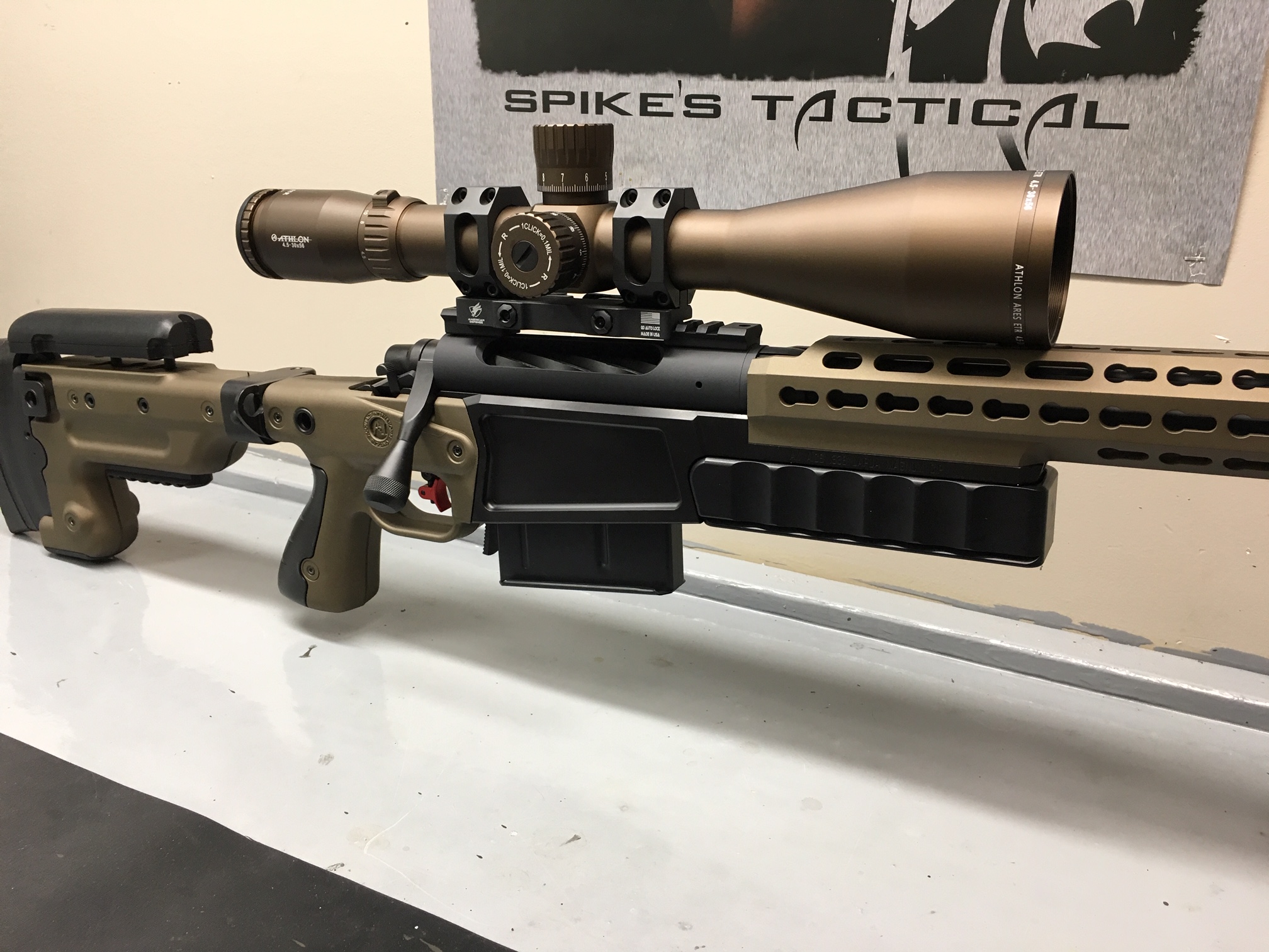

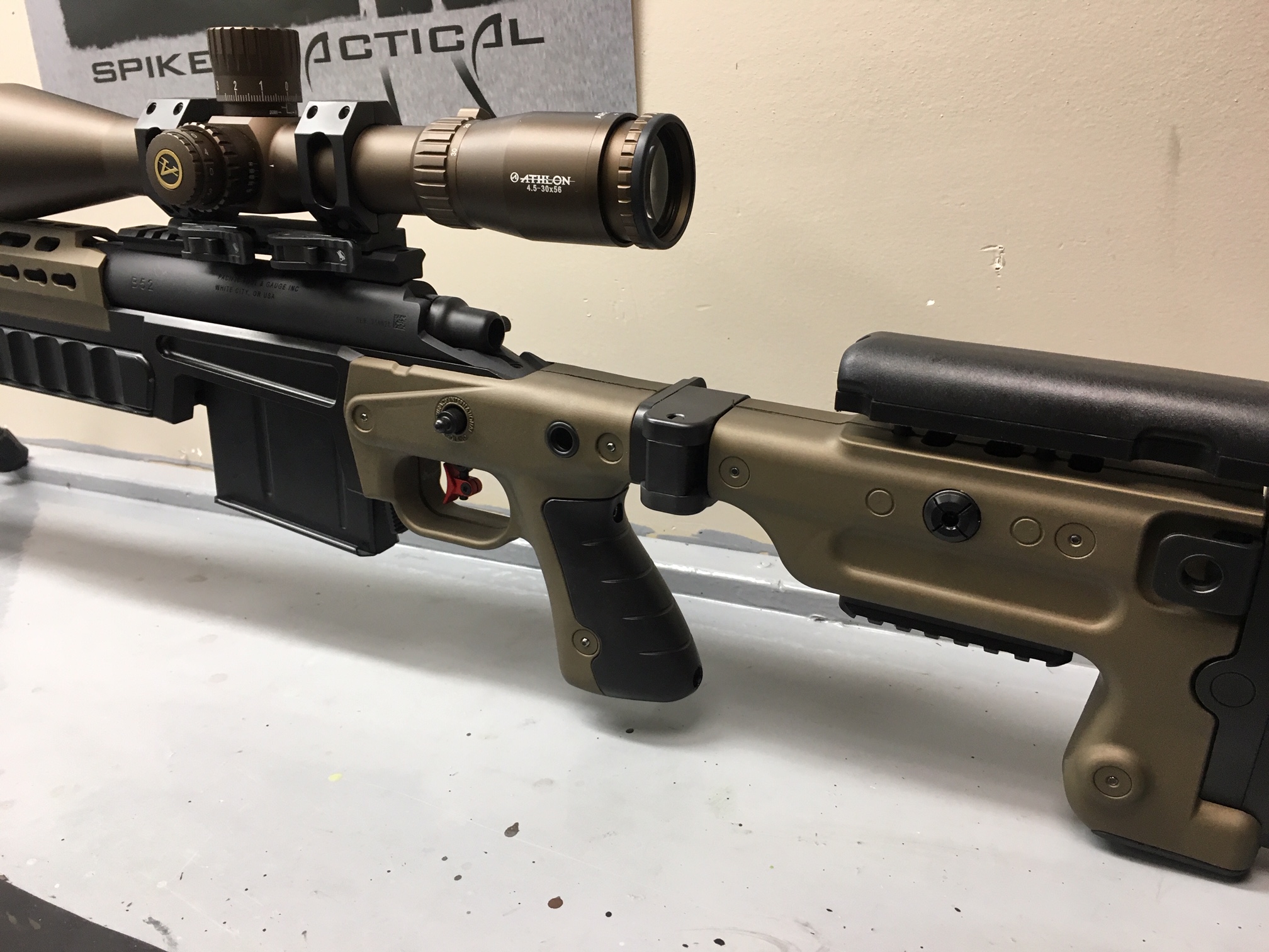

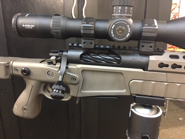

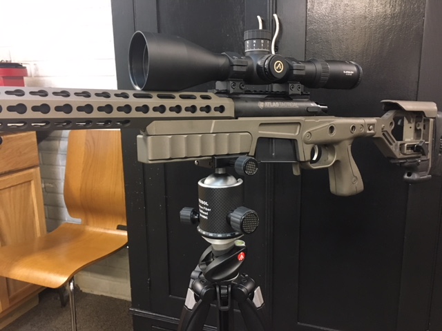

You can Cerakote anything! Here are few of my AI builds.
