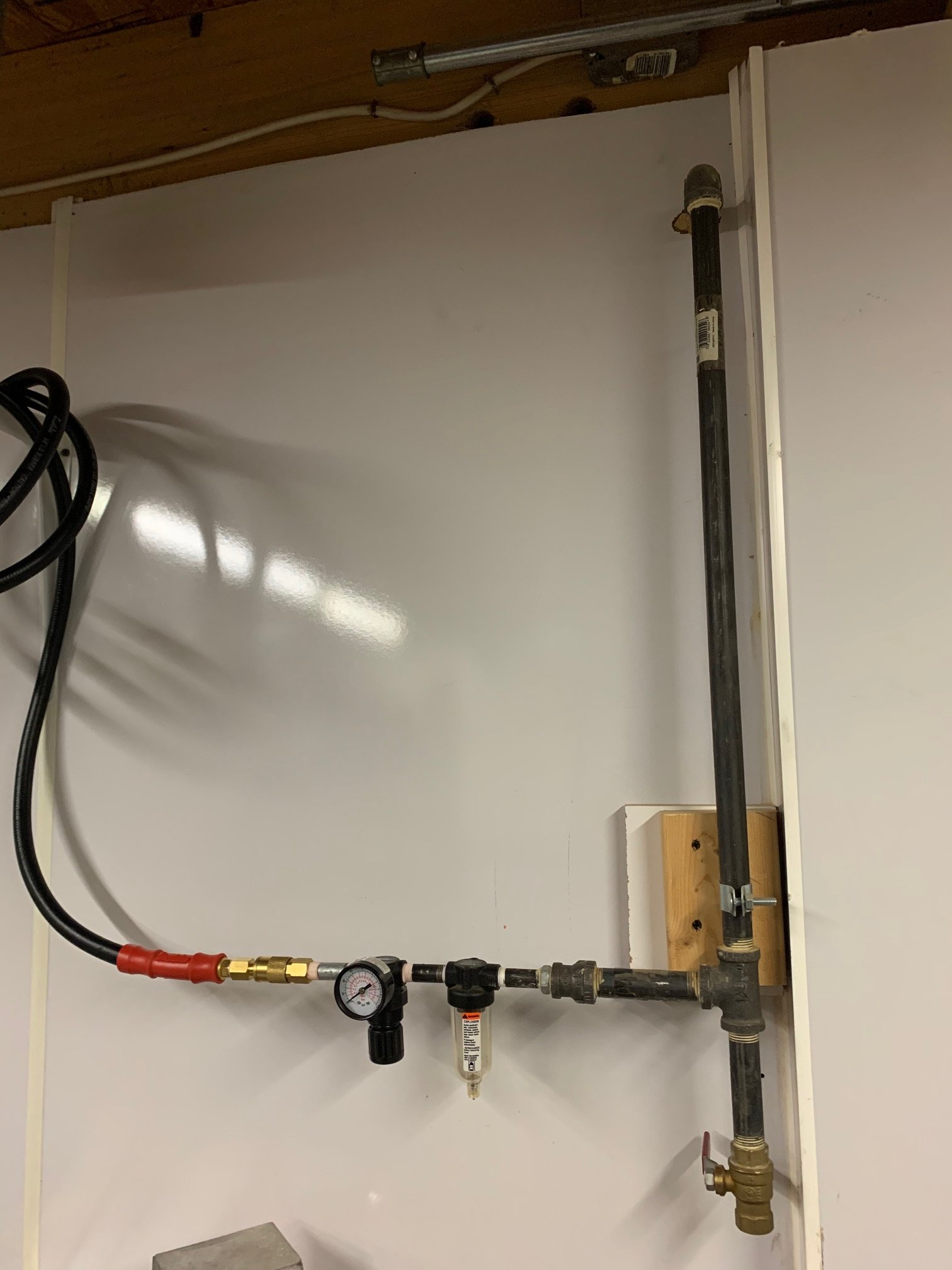

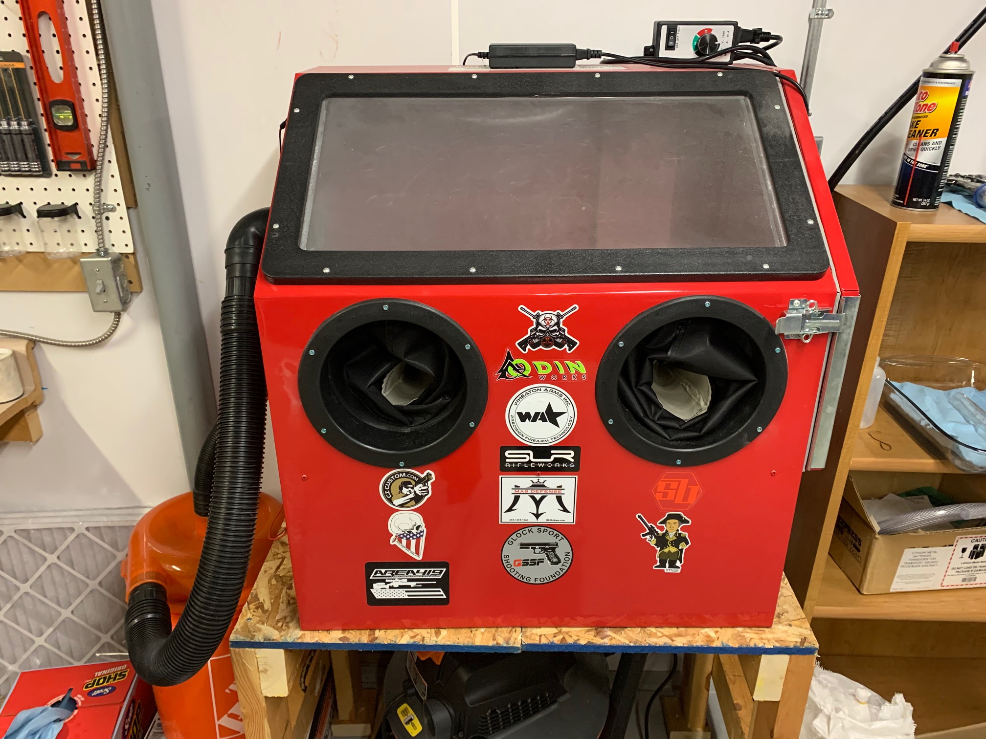

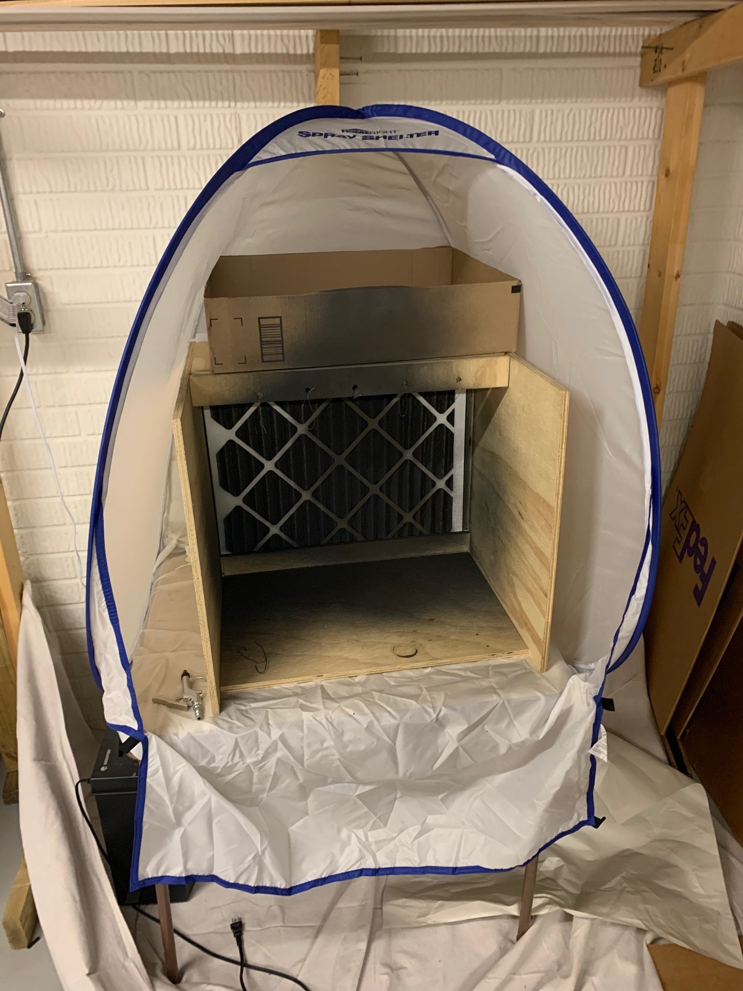

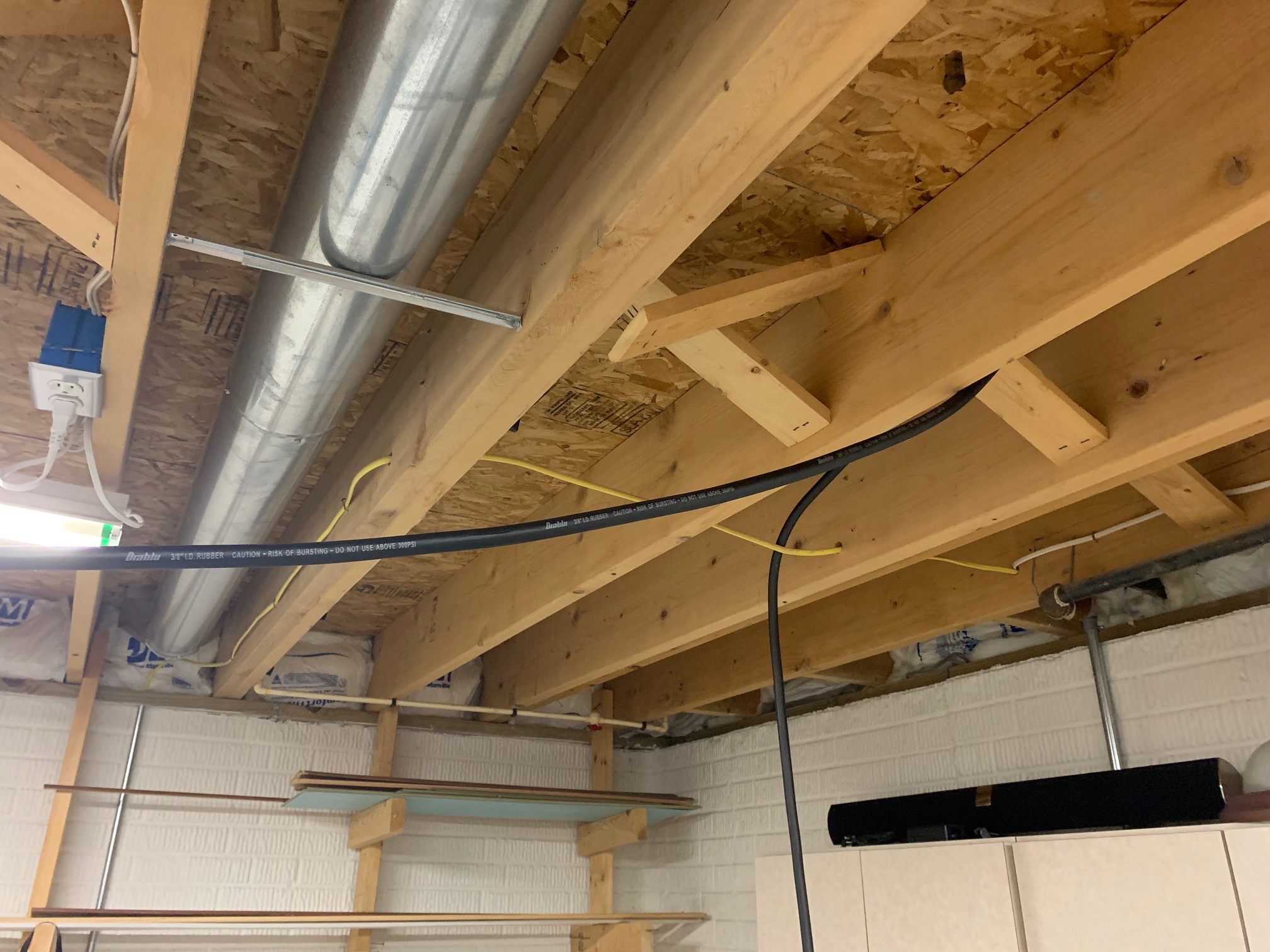

I have air plumbed into my basement. My compressor is in the garage. I have a two hoses. One to my media blast cabinet and a hose for cerakote. I have a simple water trap and haven’t had any issues applying cerakote. My paint booth is a simple wood cabinet with a fan behind the filter to draw overspray. Works great.
