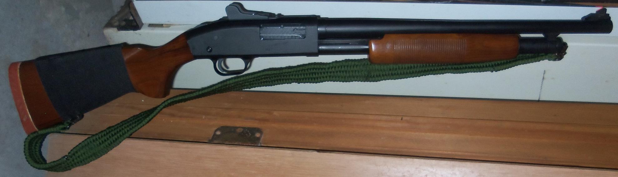

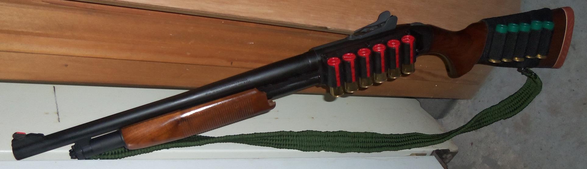

I know its a little late in the game, but here's my Mossberg I did Graphite Black/Sniper Grey 17.5:1 (70cc/4cc, I like round numbers).
