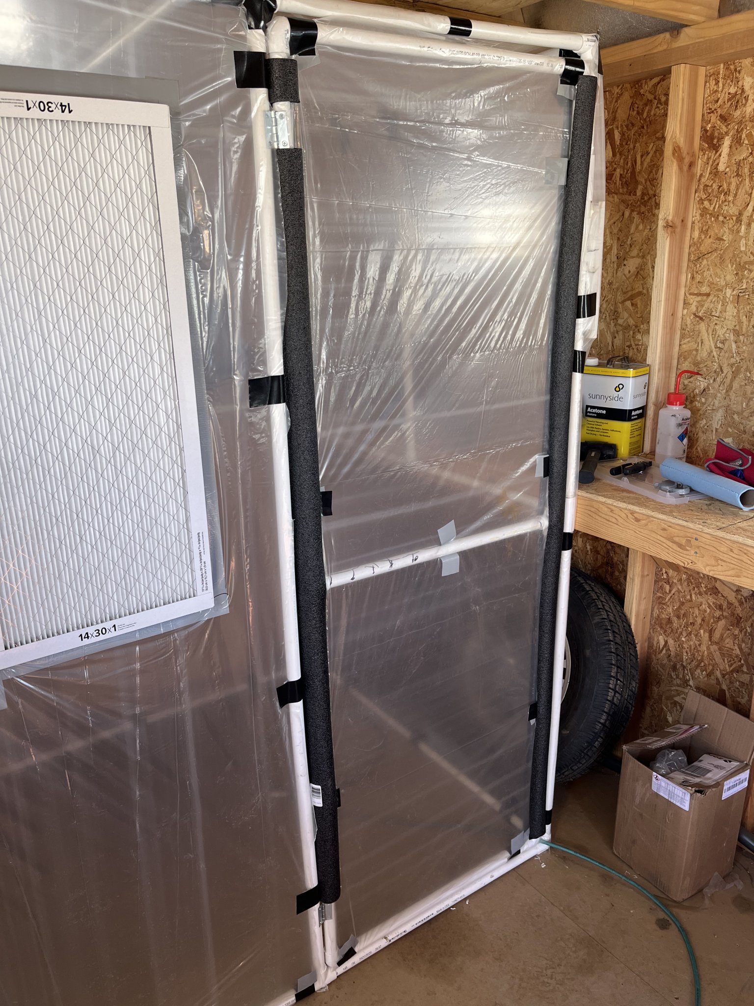

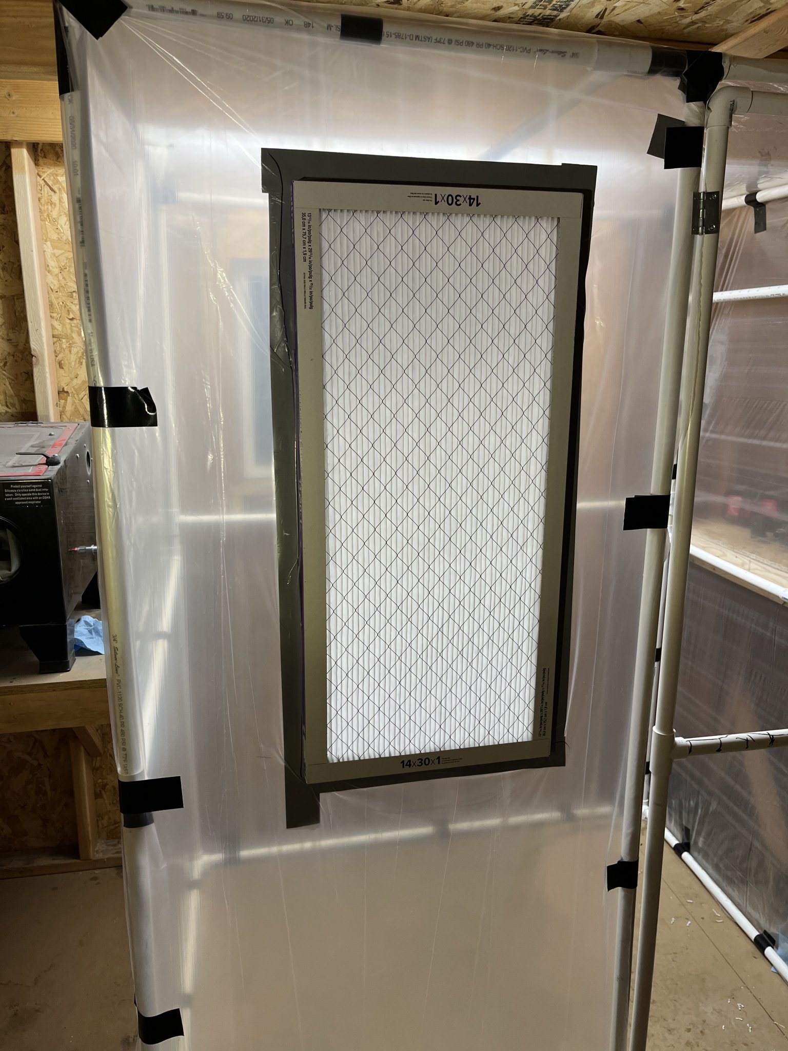

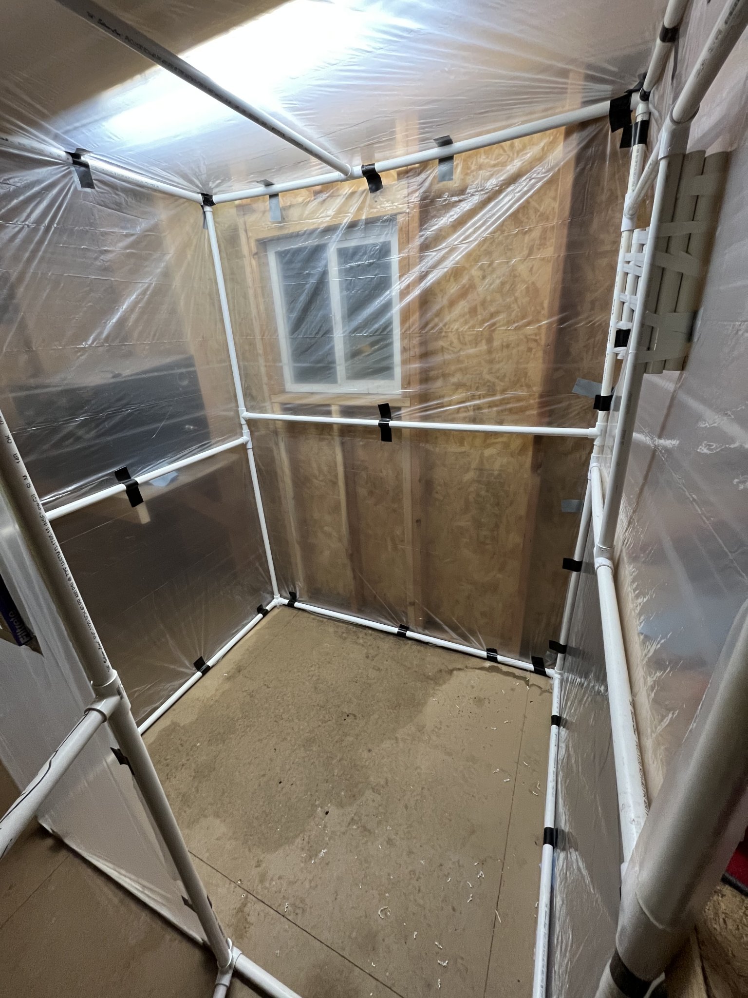

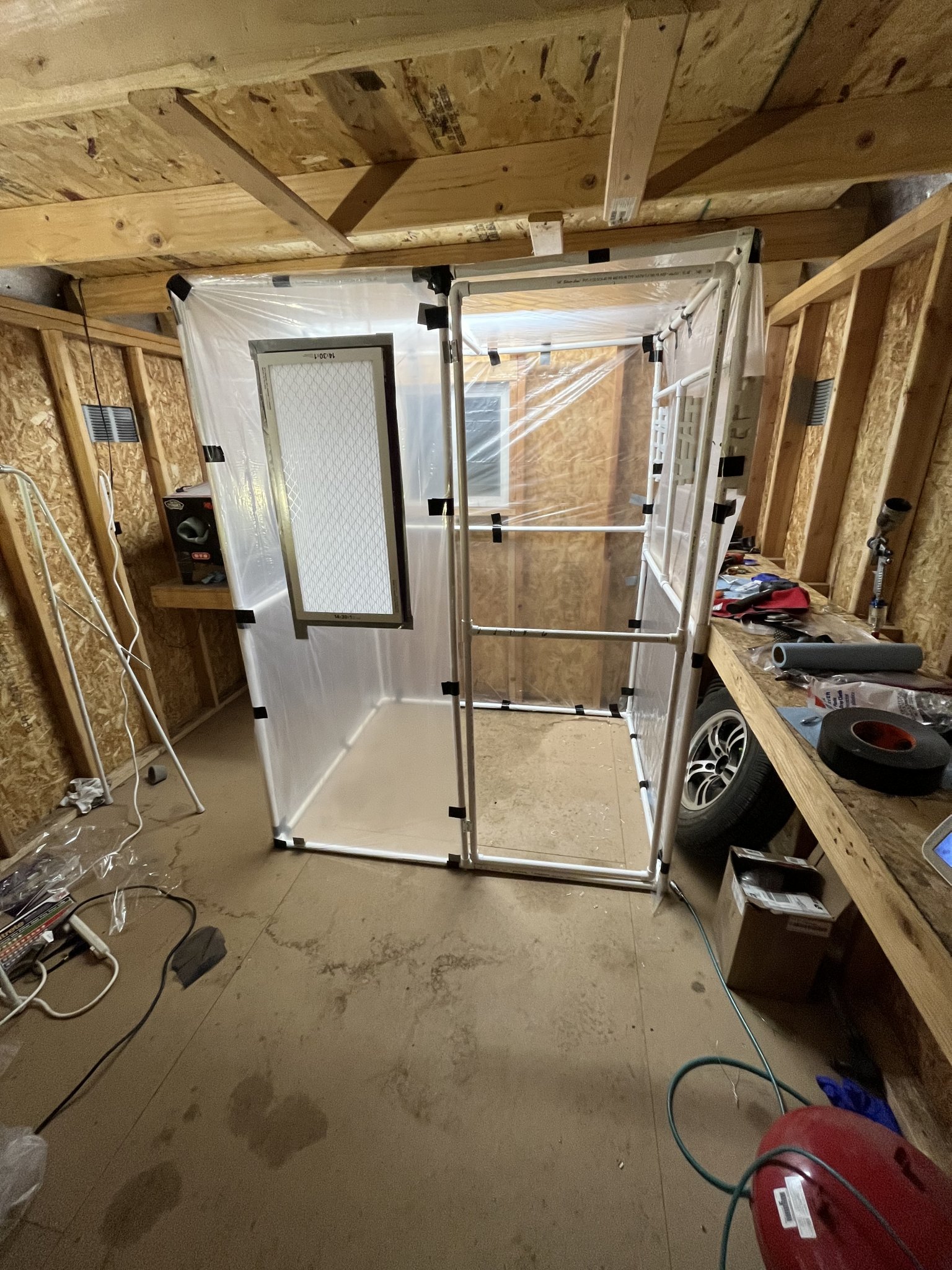

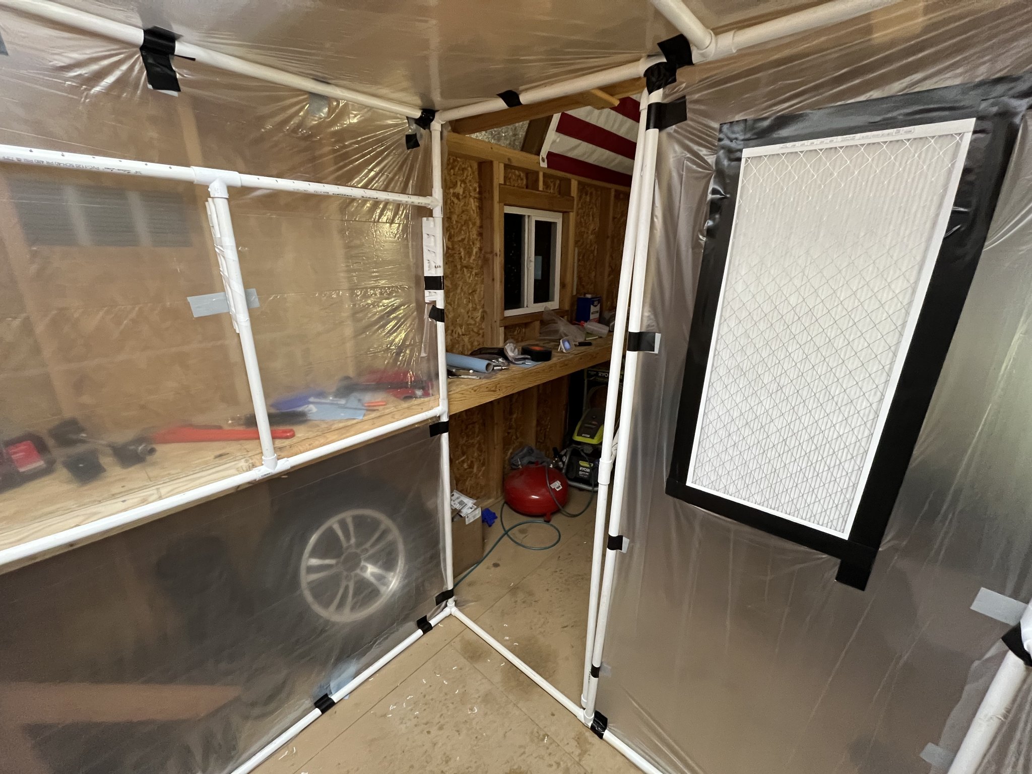

Have been cerakoting for the last year and just finally finished up a dedicated booth to start doing it full time. Really want to mitigate any and all dust particles if possible. 20sq/ft pvc booth wrapped in 2 mil plastic. Have a filter in the door wall, and a fan on the opposite blowing outside of a window. I’m still seeing a small amount of dust and would like Anyones opinions who have experience with paint booths. Thanks in advance
The pics show it unfinished but the door is also wrapped, and there is a fan sealed up to the window

I bring filtered fresh air in the top of my wall then exhaust it out the opposite wall on the bottom so it pulls the fumes and overspray down and away from my work.. 1 input fan and 1 exhaust fan…. i set exhaust fan on high and input fan on low seems to work very well for me
Reactions: Lucreau
That does sound like a good setup. Would you mind maybe taking some pics when you get the chance? My setup with the fan and filter isn’t pulling much out
