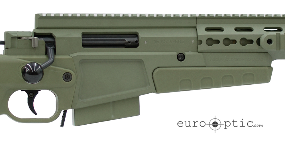

    Does anyone have a color match or close Cerakote recipe for the classic AI Green, seen on legacy AW's and original AT's?
    I'm working on color matching the other colors (Sage Green, Pale Brown, Dark Earth), but haven't started on the classic green yet. Hoping someone might be able to point me in the right direction!

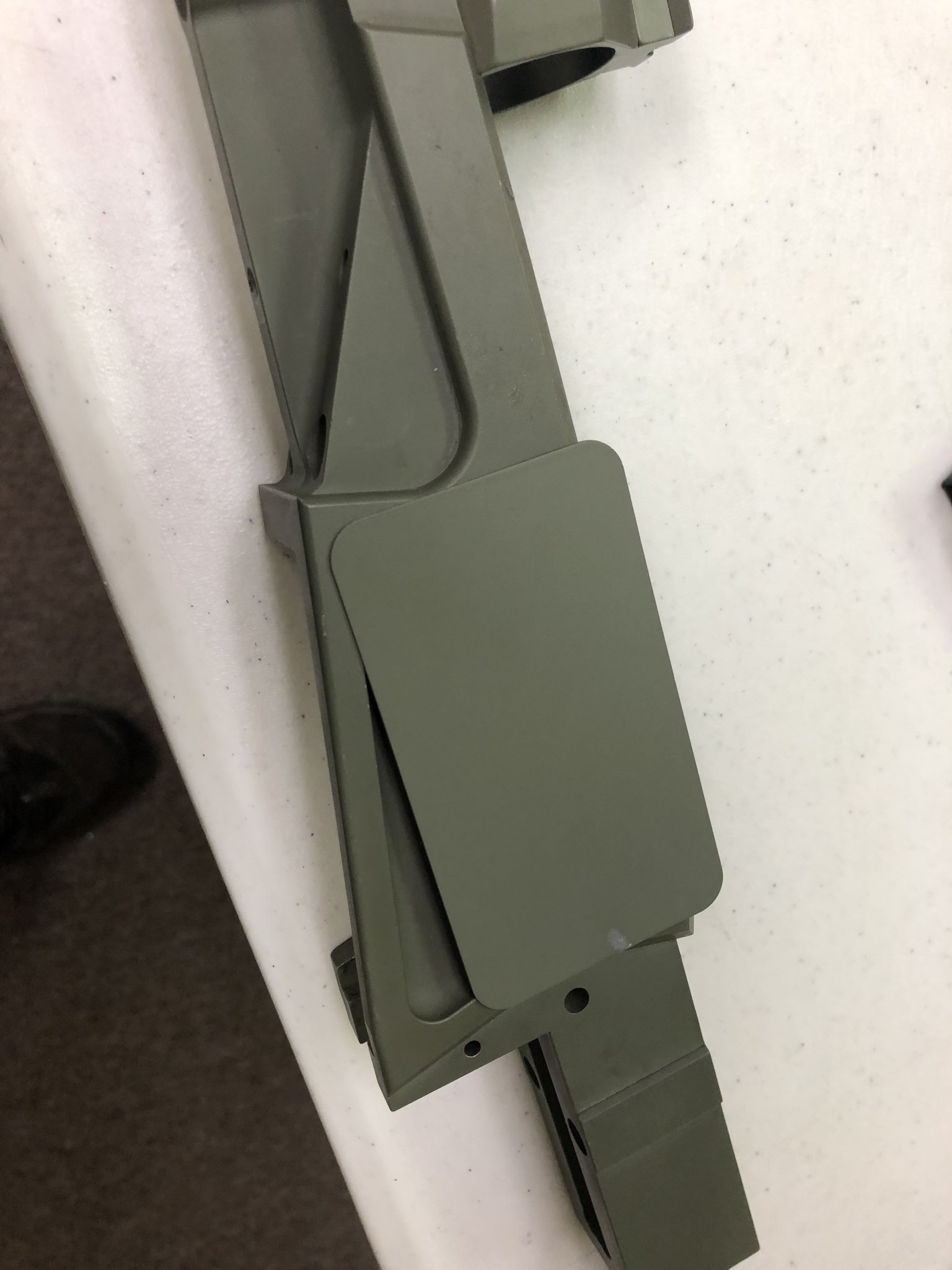

    I did a barrel for an AI AW the other week. 60% Milspec OD green, 40% coyote Tan. Came out amazingly close. I have squanch green and a bunch of others, I found this mix to satisfy the customer.

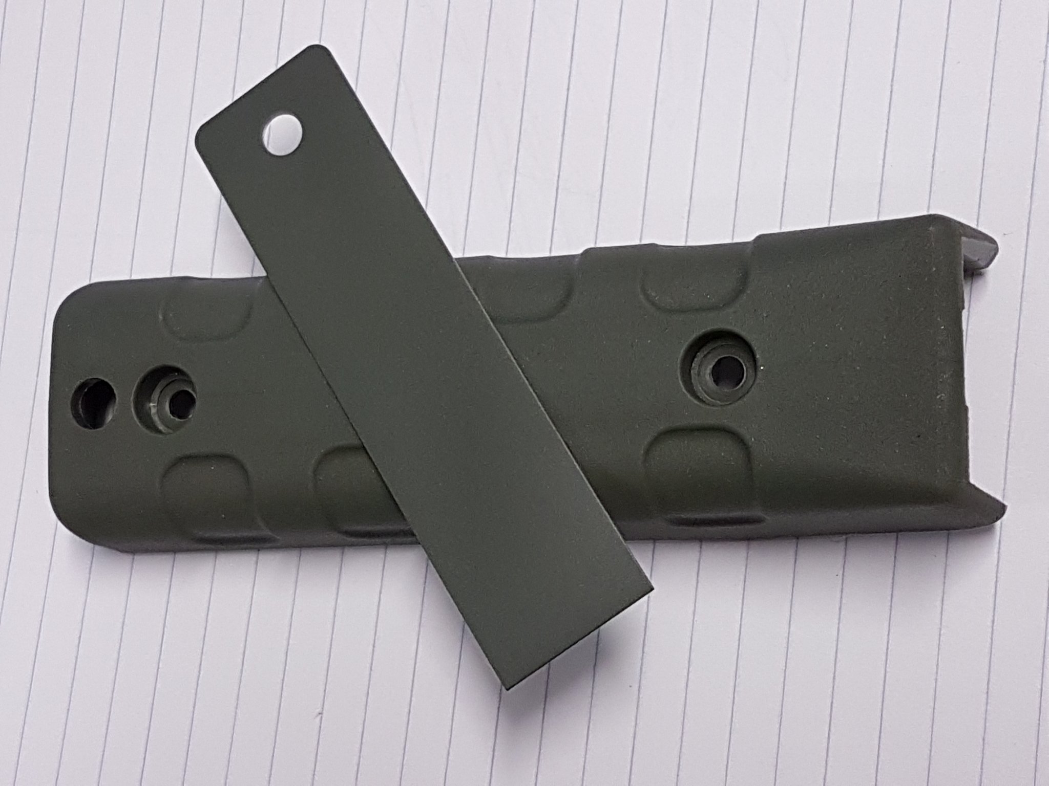

    Many years ago I sent the plastic handgaurd piece off my AX to the Cerakote dealer here. They returned it with a swatch that matched 100%. I believe the colour was called 'Foliage Green'. I just checked, the Cerakote website doesn't list this colour anymore.
    Only way to be certain it to send in a small part etc. for them to match.

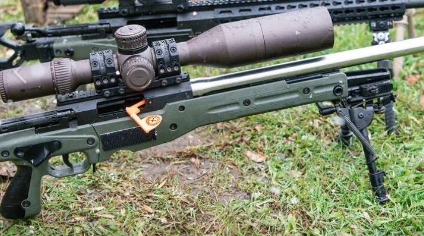

    Green is a VERY challenging color to photograph and be representative of what you would see in person. The top pic is obviously a professional job in a whitebox, the below is my rifle. I've had my rifle in APA Sage beside a Sage green AI in person and they actually are quite close.
    Interesting. Yes, green is really tough to capture, especially in grass or other foliage as the background.
