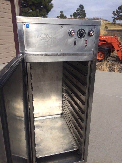

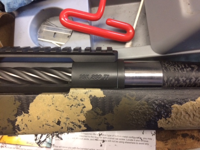

I picked up a commercial cook cabinet for $100 the other day. I saw a youtube video of a guy testing the toughness of the Elite series so I decided to try it. I bought Midnight, Earth, Jungle and Smoke. I used Smoke on my Pierce titanium action with a Proof carbon barrel. All I can say is that this stuff is tough. Smoke is a nice color, too. I'll be doing a Ray-Vin tripod in Earth and will add that to the thread when it's done.

They said they're working on some other colors but I'm not sure how long down the road it is. The Smoke color is a pretty nice matte finish. Certainly less shiny than semi gloss. I'm not sure how accurate I was on my mixing ratio. It took a solid 15 minutes to flash cure so I could sand the high points on the bolt flutes. I may have needed a touch different amount of hardener.
