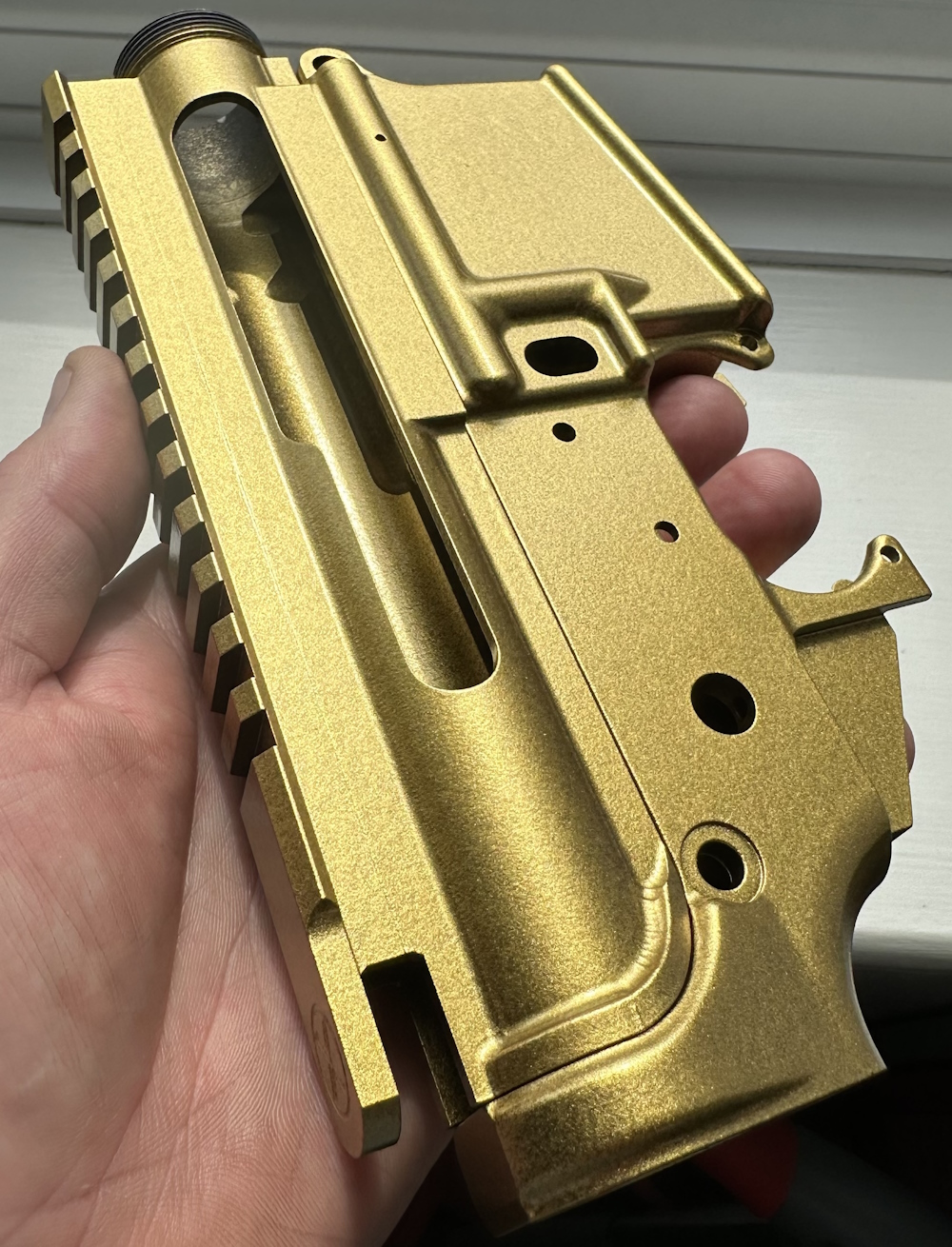

I tried FX Gold for the first time (never used any FX before, just started with gold!). All the Cerakote examples seem to use Graphite Black as a base - so I started there. Is there a particular reason for choosing the black?
The gold effect is pretty good in sunlight, but in shade it's definitely noticeable its got a dark base. I would have though a silver base would have been a better option, so I'll try that next.
Overall, it's quite a process to use it and it does look like a thick layer when you've finished...

Just assembled the lower. All the roll pins went in fine, so it definitely looks thicker than it actually is... It does seem to have a more noticeable 'layer' than just Cerakote - but then I've never used Armor Clear Gloss before either!

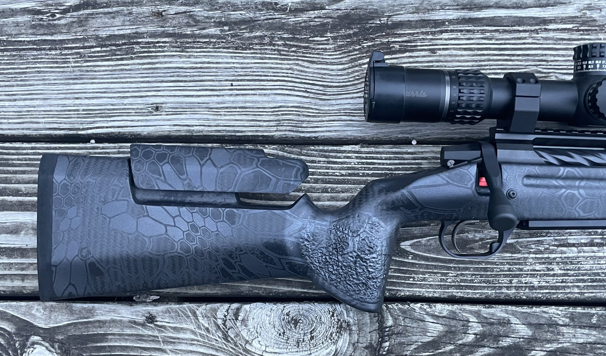

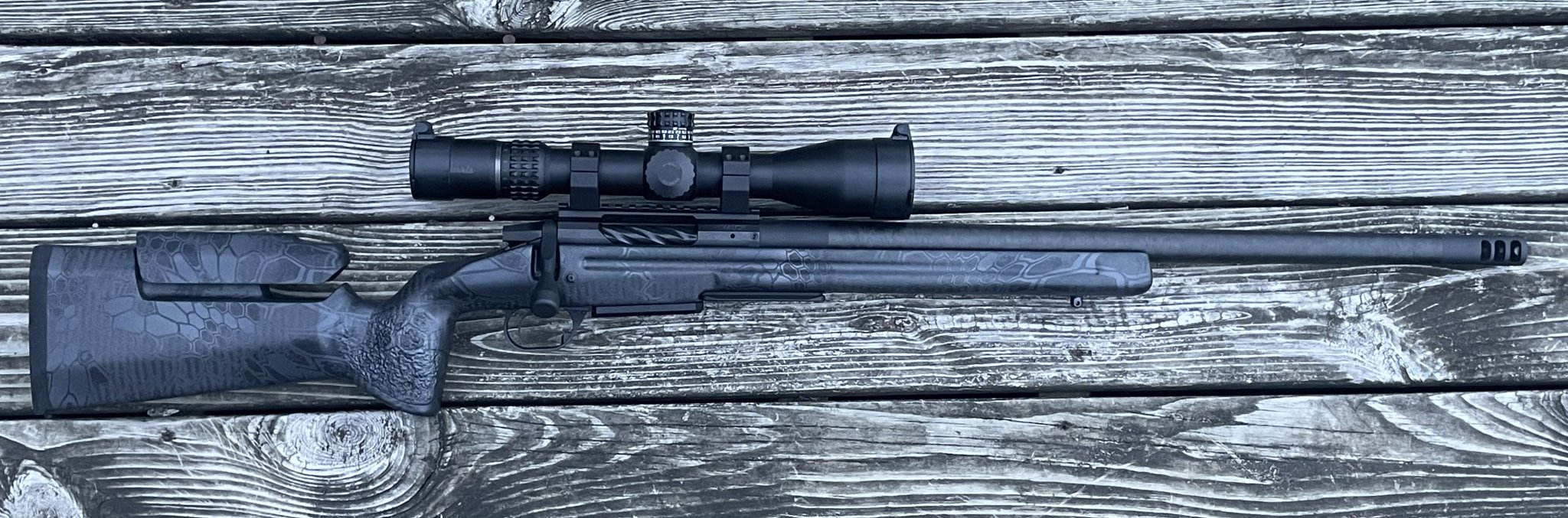

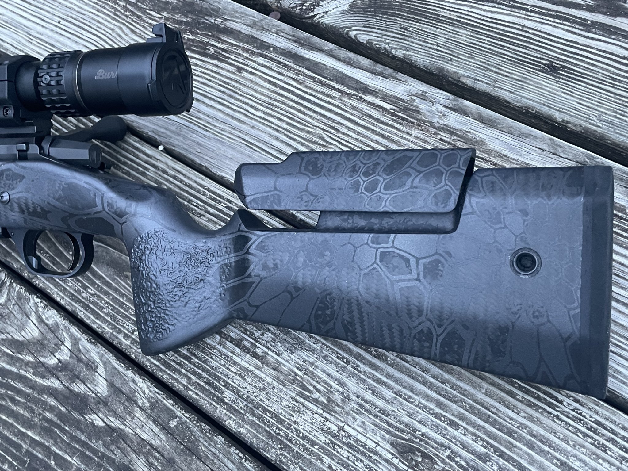

These are FX cosmic (which looks blue) over graphite back. The black Manners in “kryptek” is 25% concentration FX Cosmic and sprayed on the graphite black after “tacking out” (yes, you are supposed to spray it wet in wet, but this way gives a less “blue” more ghost grey color with the shimmer).
You don’t have to mix it at 100% the recommended concentration. You can vary the appearance with different concentrations.
I should have some examples over different base colors soon. I have sprayed test coupons in the past.

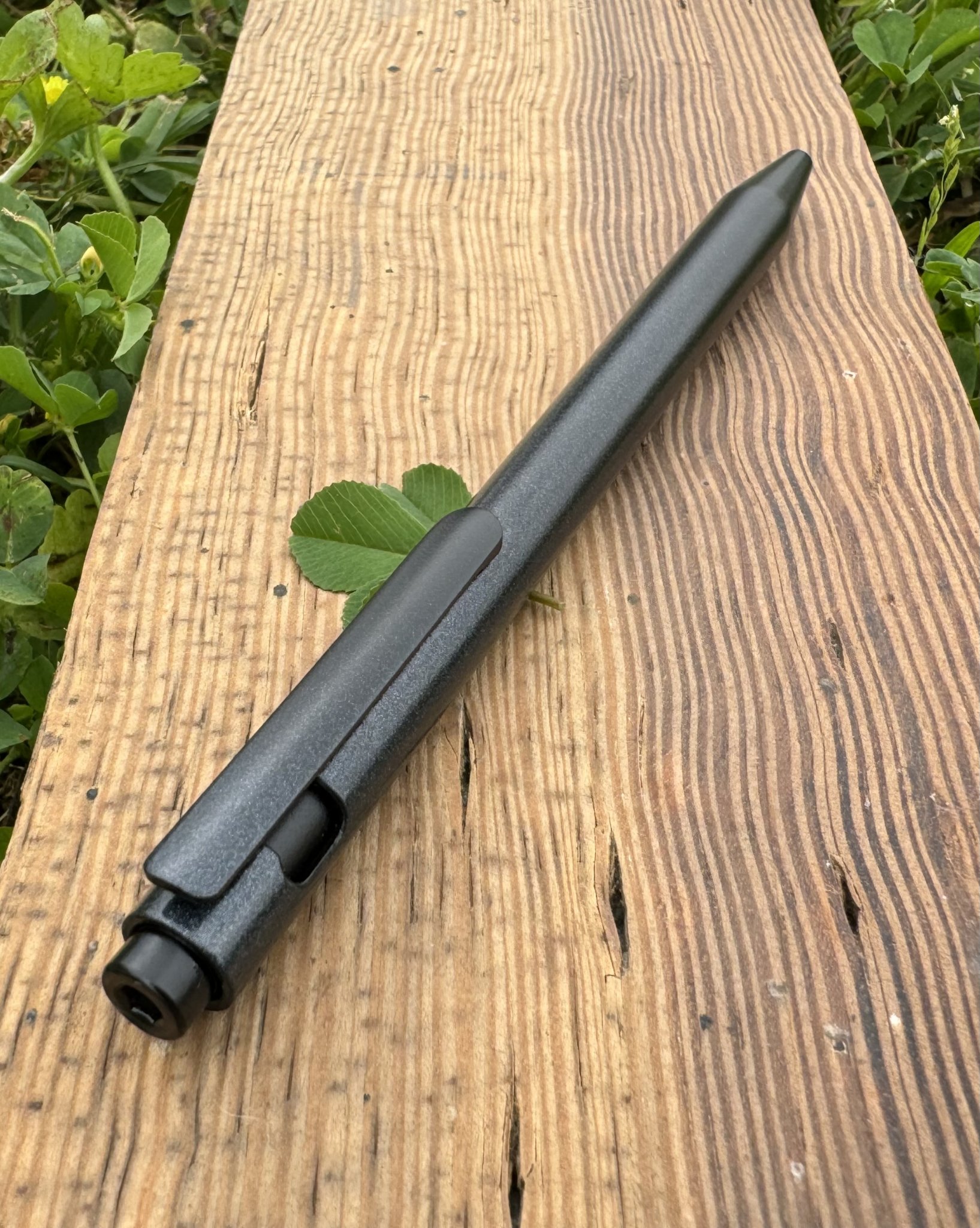

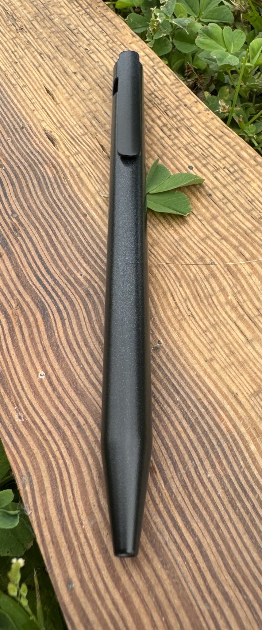

PS - the pen is faded from black to Cosmic at about 50% concentration if I recall correctly.
