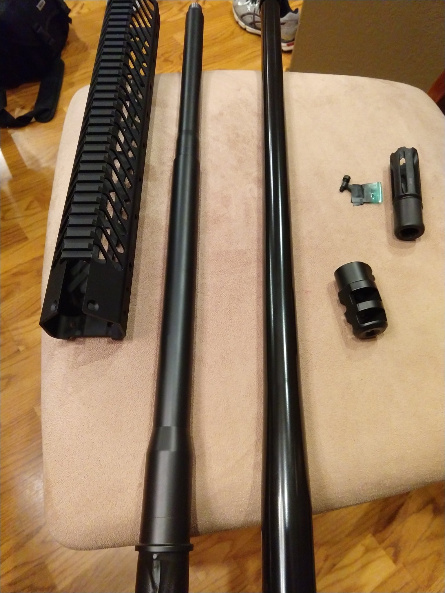

So 34:1 by weight is a good shine level for bolt guns, but is pretty glossy for an AR. Right is the original 28:1, middle is 34:1, which I'm happy with, matches my nucleus pretty well (unfortunately that is my ar10 barrel), left rail is my seekins handguard with factory finish.
So what sucks is I probably went through almost 4 ounces of cerakote to figure this out, but I have 28 left so worse case scenario I guess I'll use the new mix ratio till this bottle is gone.

The AR barrel looks like Graphite Black at the 18:1 volume ratio. The one on the right looks like Gloss Black. Maybe a labeling mixup?
Edit: Last year I got a pint of Titanium that was so thick you couldn’t strain it. They had an issue with that lot and sent me a replacement bottle.
