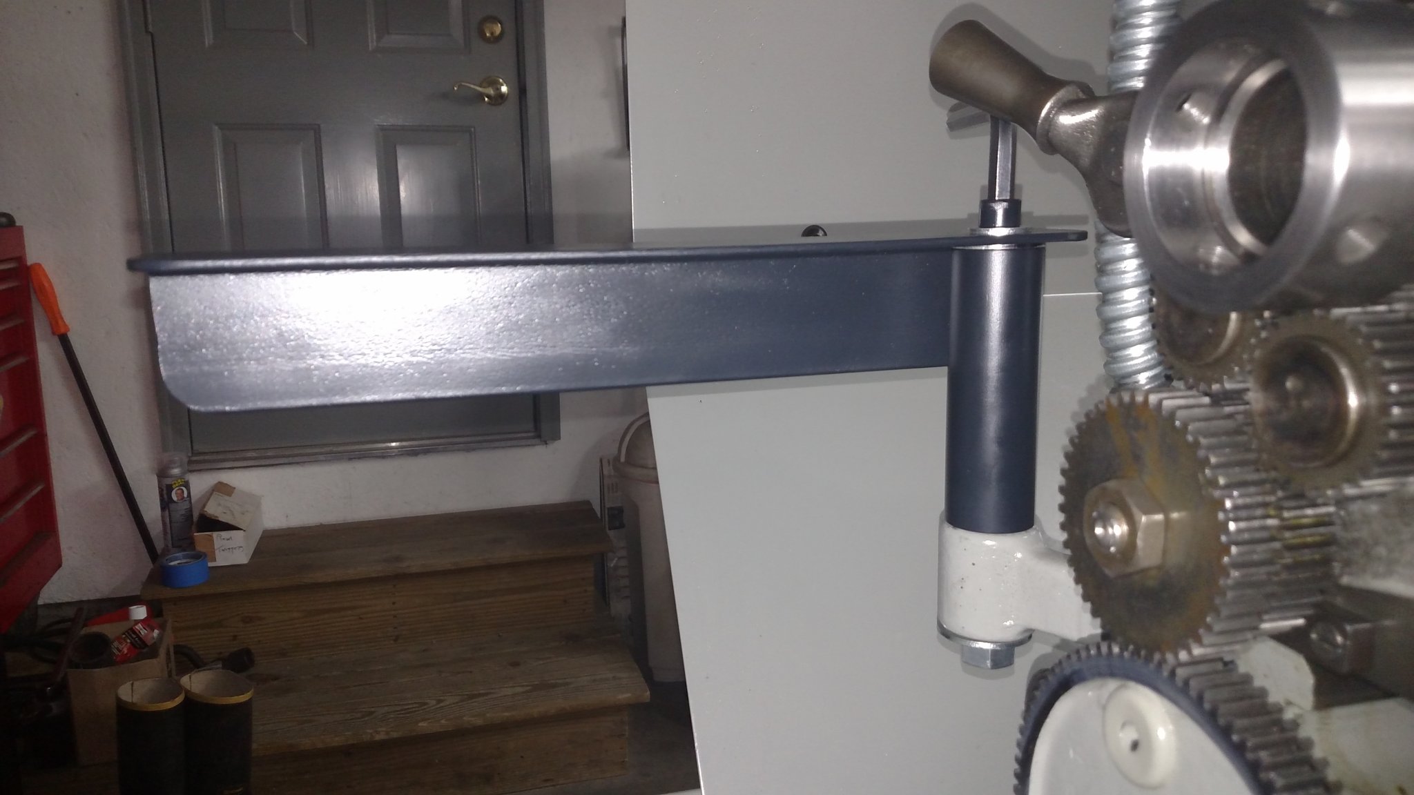

I coated this piece of aluminum shaft and angle iron that I use to set magnetic indicators on at the outboard end of my old South bend lathe. The cerakote is 3 years old, so thick I couldn't strain it through a paint funnel, but it sprayed very well and seems to be a durable finish. I'm happy to hear that we can thin this stuff with alcohol.
