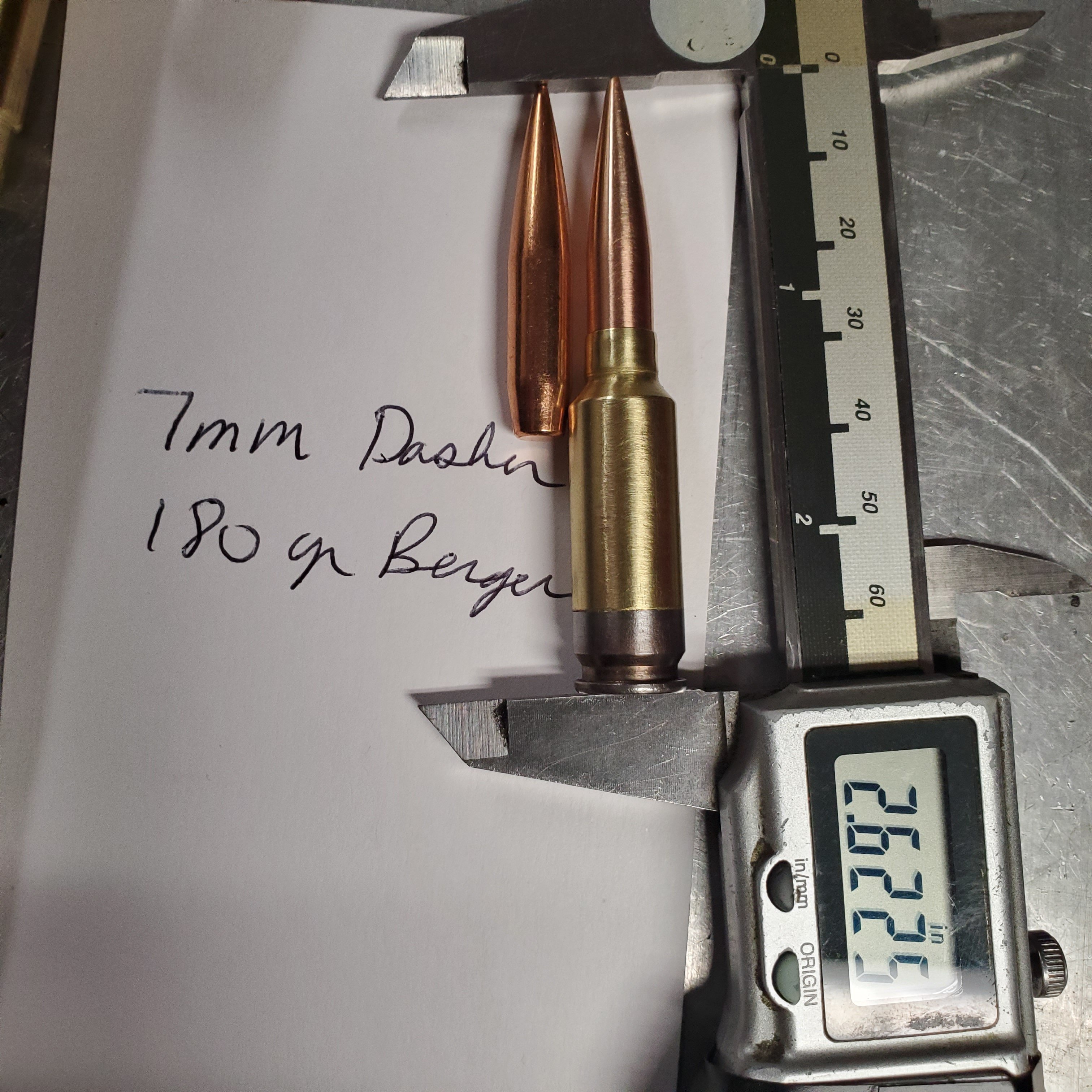

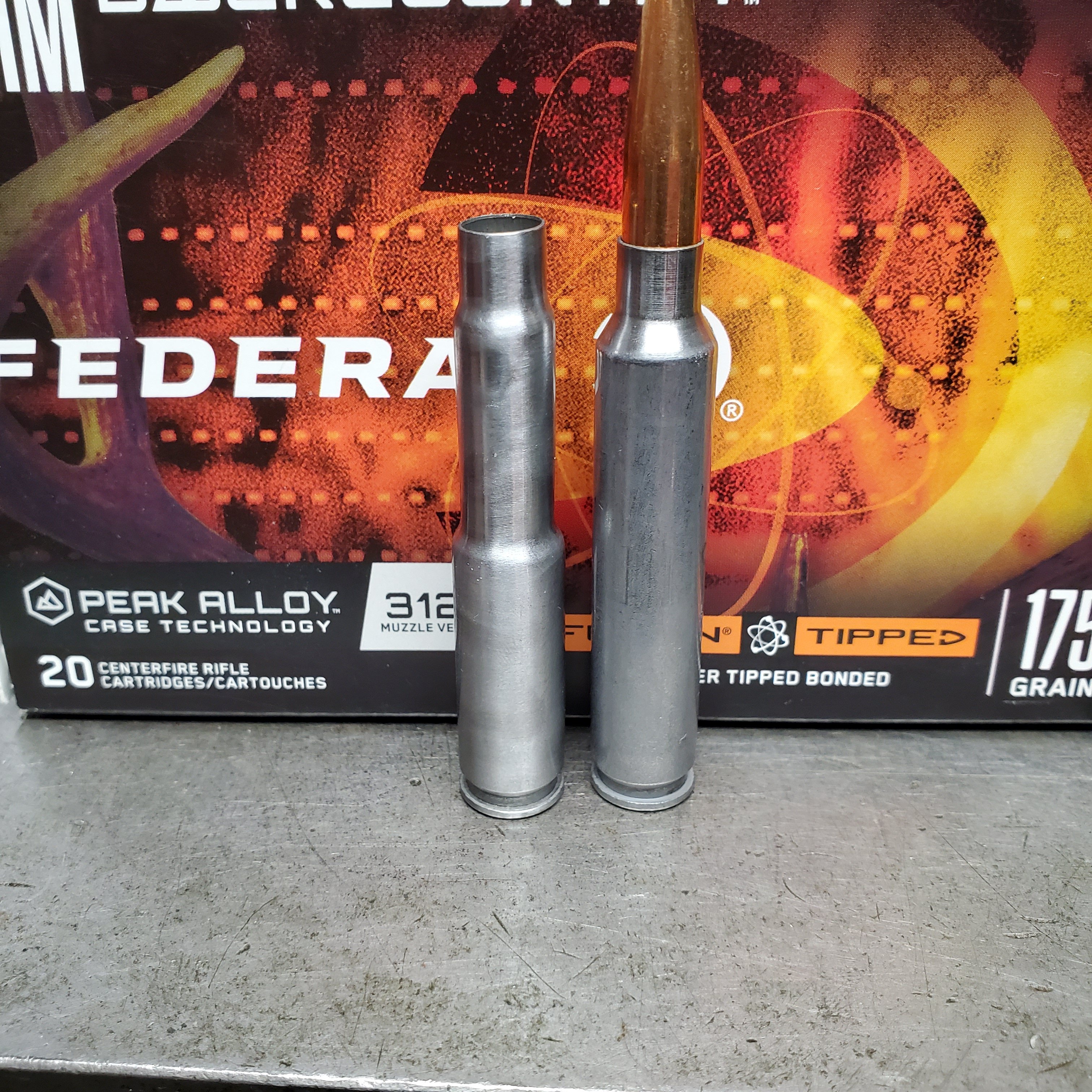

Since I have the 6 Dasher with hybrid cases I mocked up some with the 7 mm dasher and 180 gr Berger bullets, I have on hand.
It appears the loads you have are already over pressure for brass cases.
I ran the hybrid cases to 65,000 psi.
Most loads with the 180 gr Berger at 2.620" COAL will reach 2500 fps plus in a 30" barrel.
RL 17 will reach 2600 fps...with hybrid cases...according to QL.
It's a big chore for such a small case.
The 166 gr Atip might be the best bet.
As close as I can tell with my specs im under max preasure still at 64193, this is gotten by trueing ql up with the ba.
Maybe you dont view the dasher max at 65000,
I am also using fireformed lapua brass that has about .5-.75 gr more h2o capacity then alpha or peterson.
That being said, I use ql preasure as a guideline for ladders, after that as long as I dont see preasure signs and dont have any issues I'll shoot as hot as the rifle likes to shoot, if ql shows its 75000 and im ok with decreased brass life I'll shoot a hunting rifle there as long as it likes it and bolt lift is compromised.
The 180 berger is gonna have to be on the list to try tho. Also would love to find some Rl17 again but for now that experiment will have to be on hold.

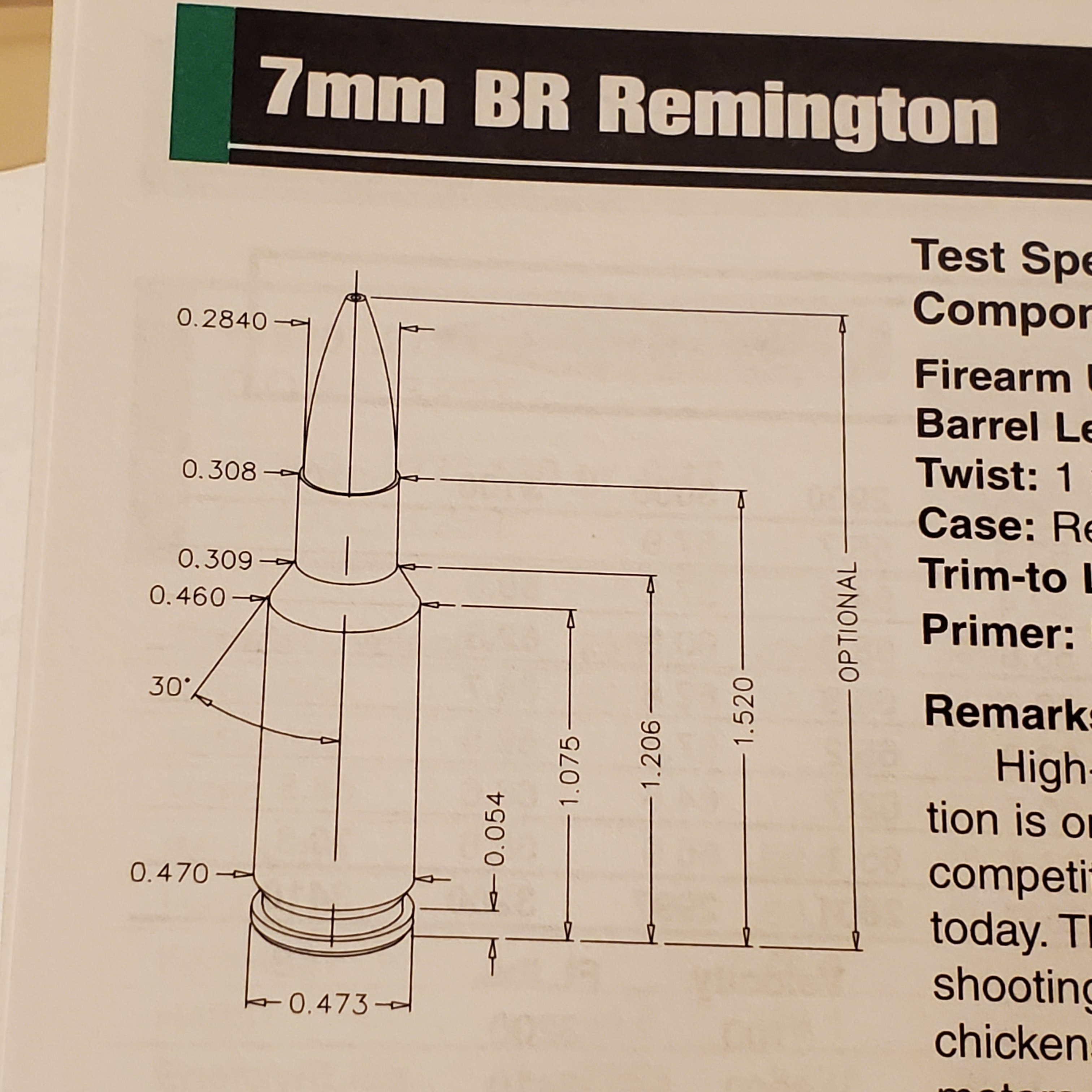

I Been thinking about it and my only hesitation is that its a little short, I would love it if somebody would confirm this but it appears like peterson 7 br case is 1.520. Lapua 6 br is 1.555. I really want to get as much neck as possible for this long bullet, my reamer is 1.555.
Maybe they would both be similar after being fireformed to 7 dumbo.
Reactions: Terry Cross
Homework done on the front end to choose reamer, brass and dies as compatible as possible will always minimize headaches and foul language!
Yep, ...7 BR specs out at 1.520"...so it'll come up a bit short.

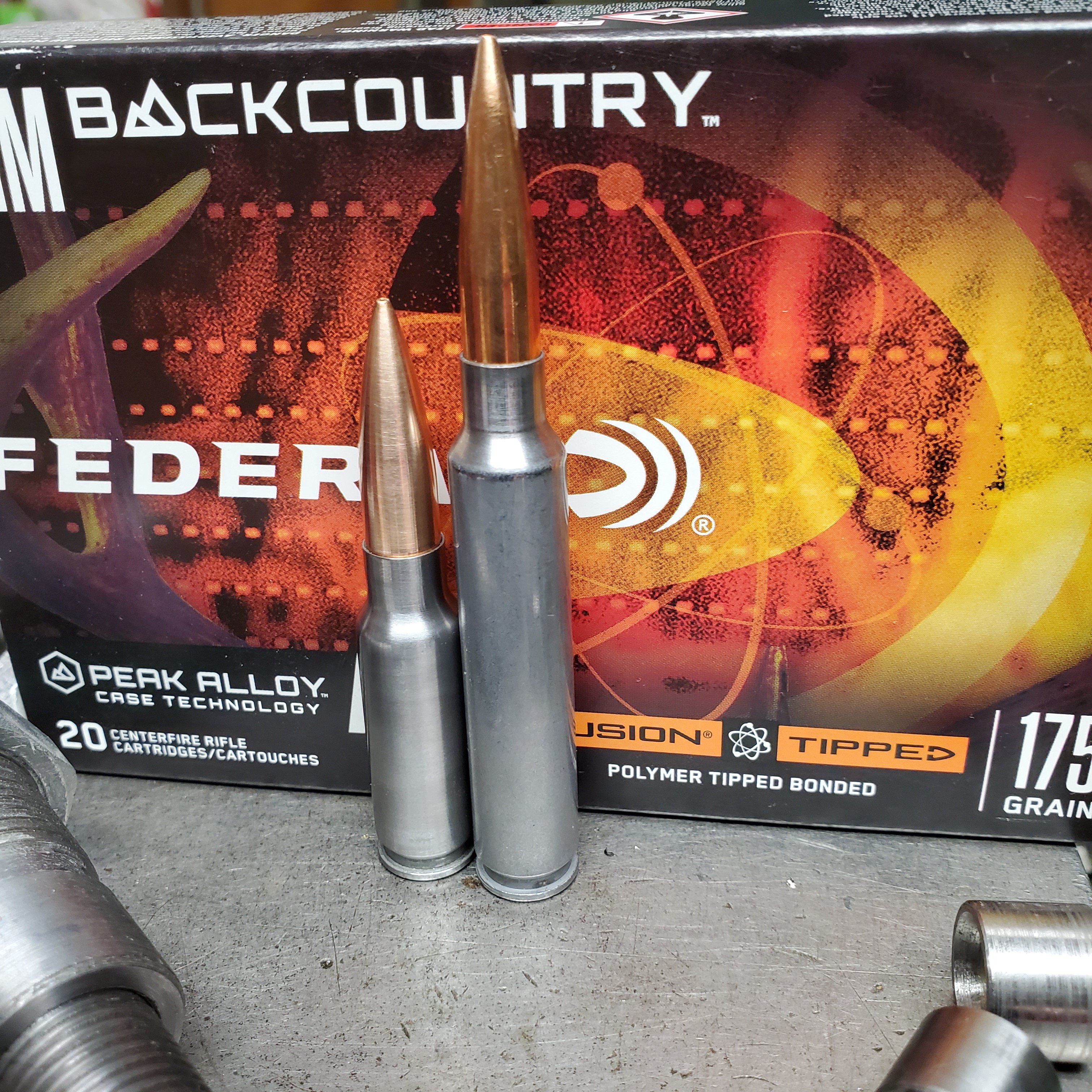

If you make your own brass from longer cases, you can make it any length ya want.
This is a non standard cartridge, no factory ammo.
You can even run the reamer deeper for more case capacity...since it's a wildcat you can make it one of a kind....but it requires quite a bit of work making brass.
I did it with the 338 ARC to get more super sonic velocity.
Just make all the one of a kin cases, which you're kinda doing anyway, just a bit more involved.
