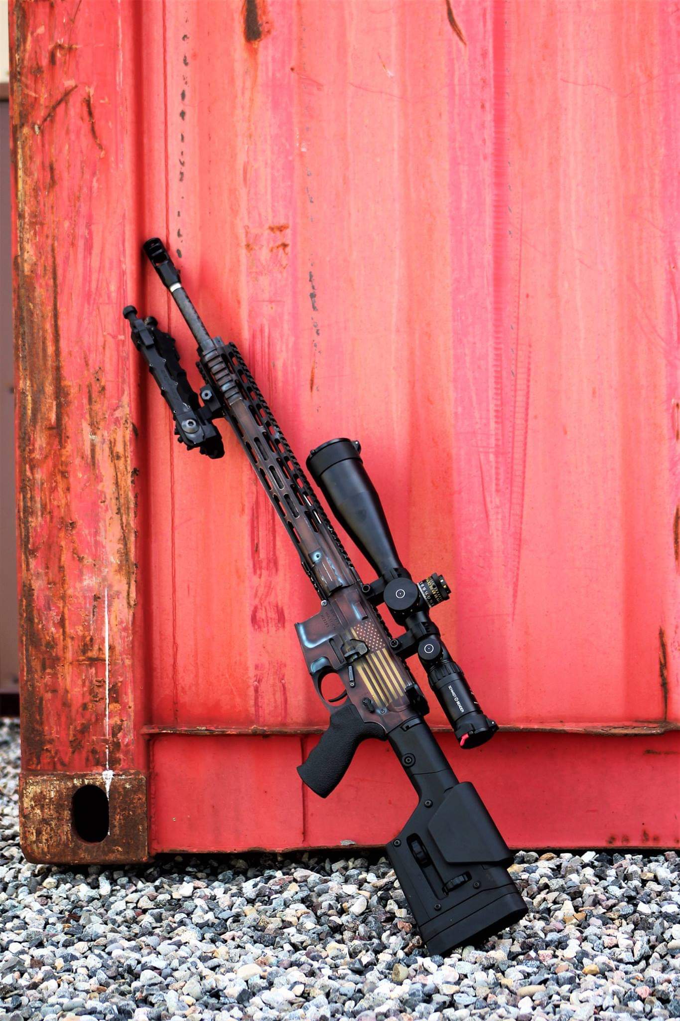

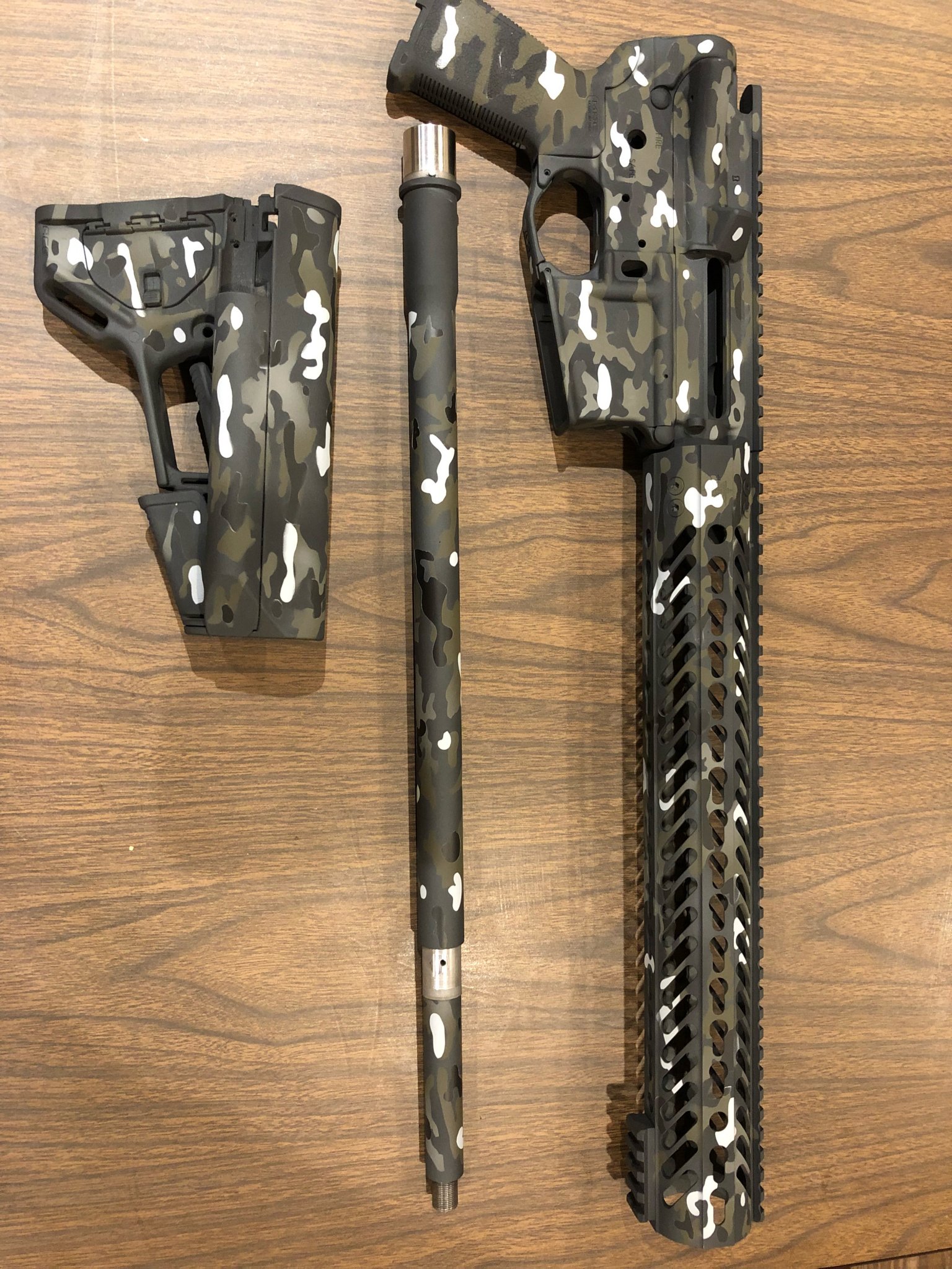

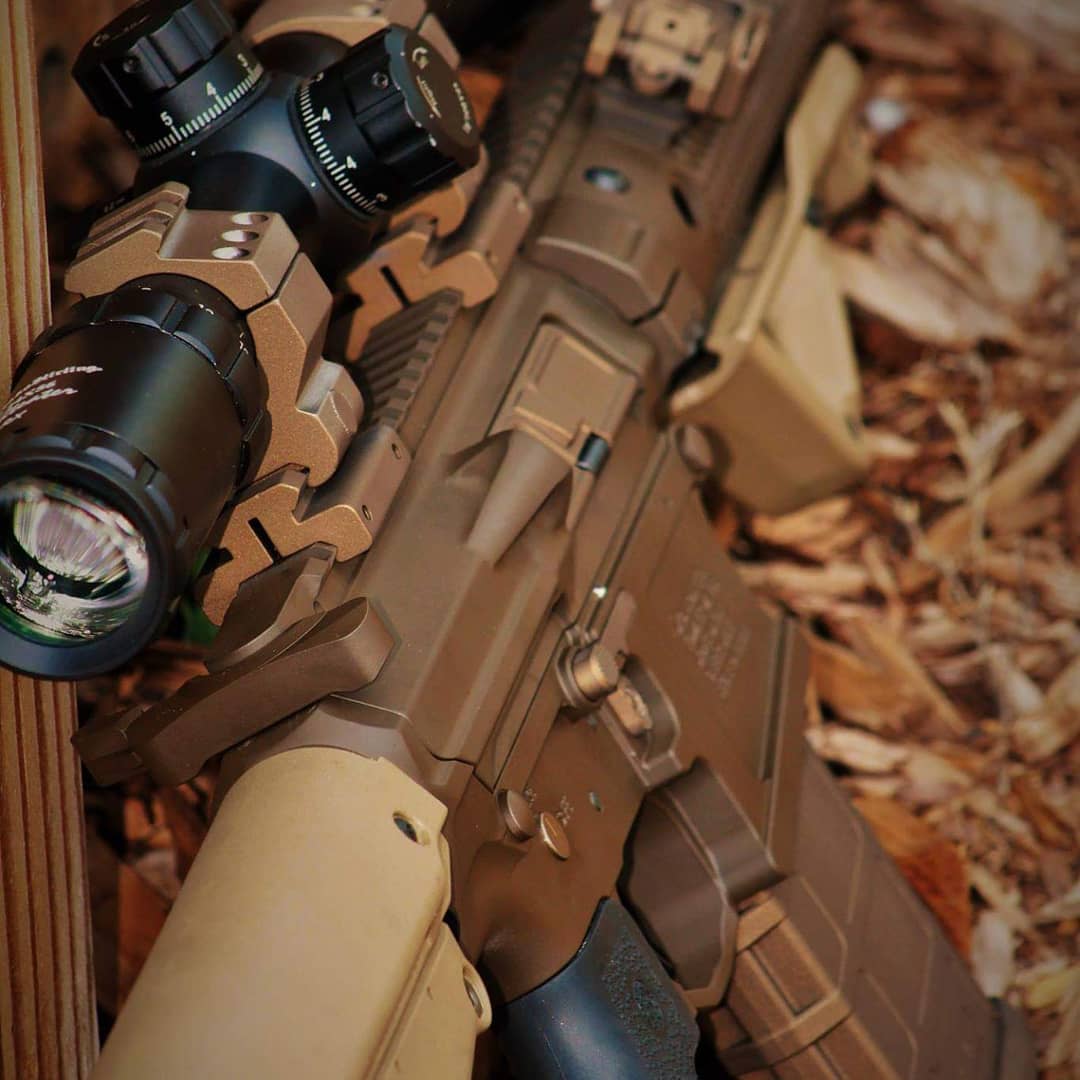

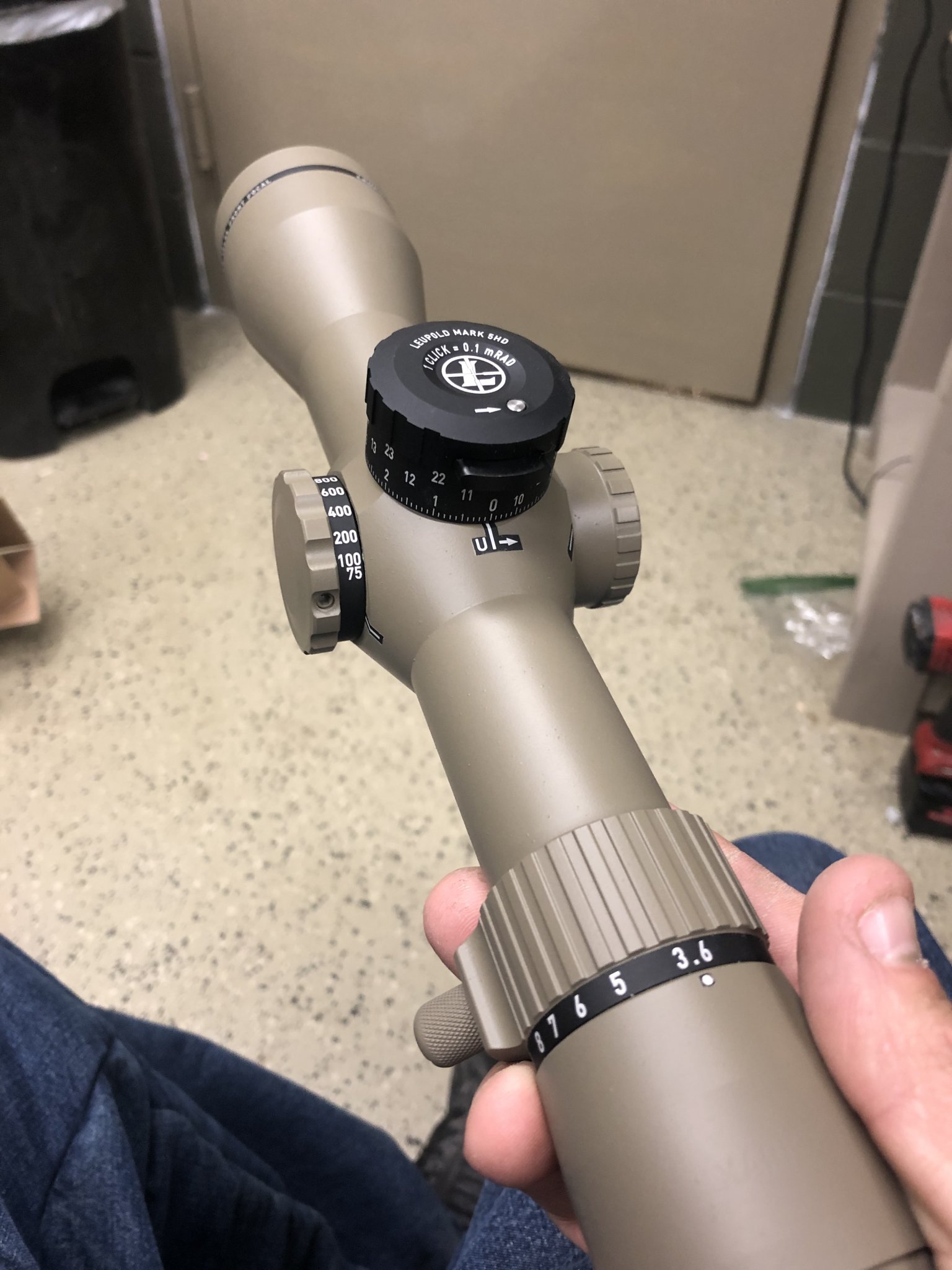

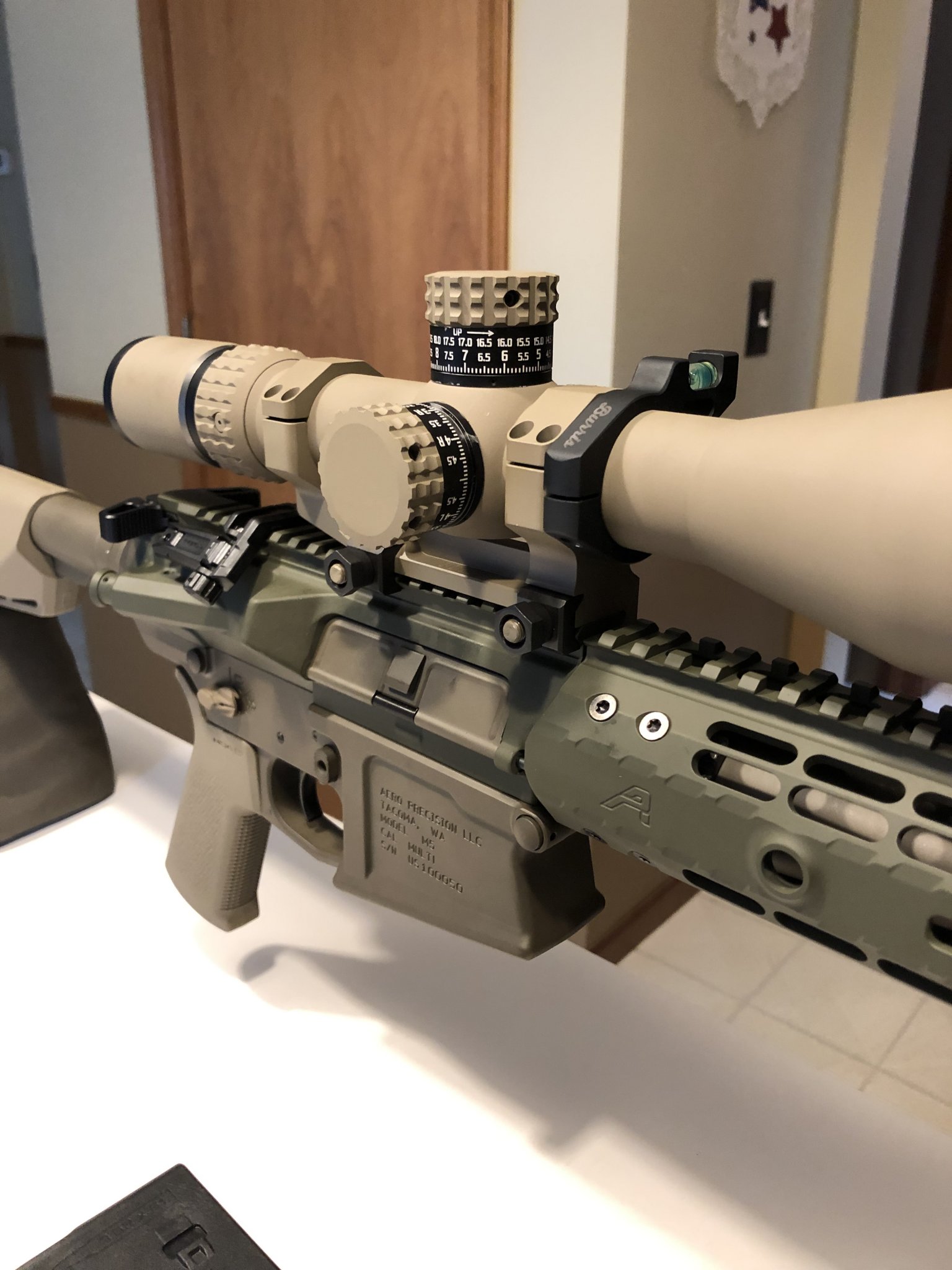

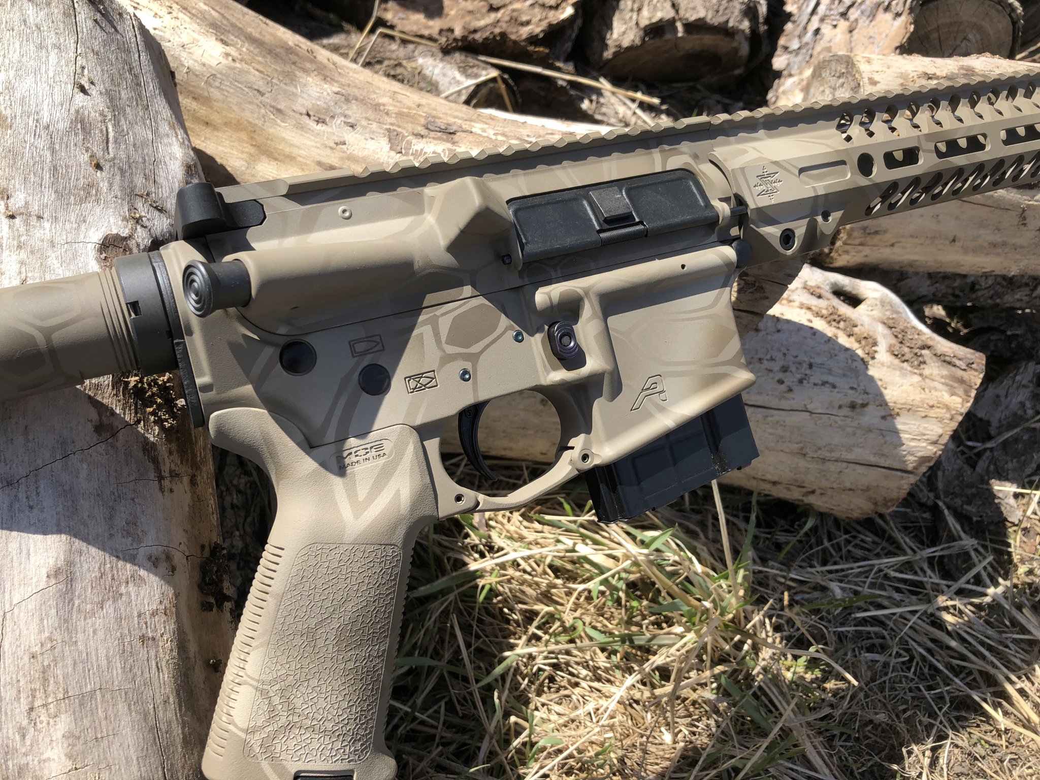

I've been doing cerakote for about 4 years now and have turned out some amazing work. But I'm always looking for more ideas, patterns, how tooos, and share other information/techniques with others.
I keep seeing lots of new stuff like wood grain, differnt textures, and always wanted to know if it's truly cerakote alone or if most people use cerakote just a clear coat now...
Lookong for others that want to share techniques, failures, success. I'm always looking to help others and will do what I can.

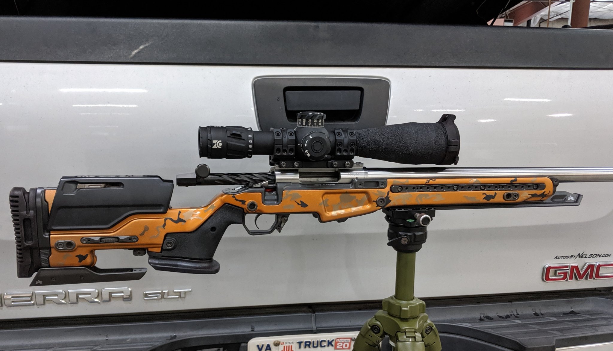

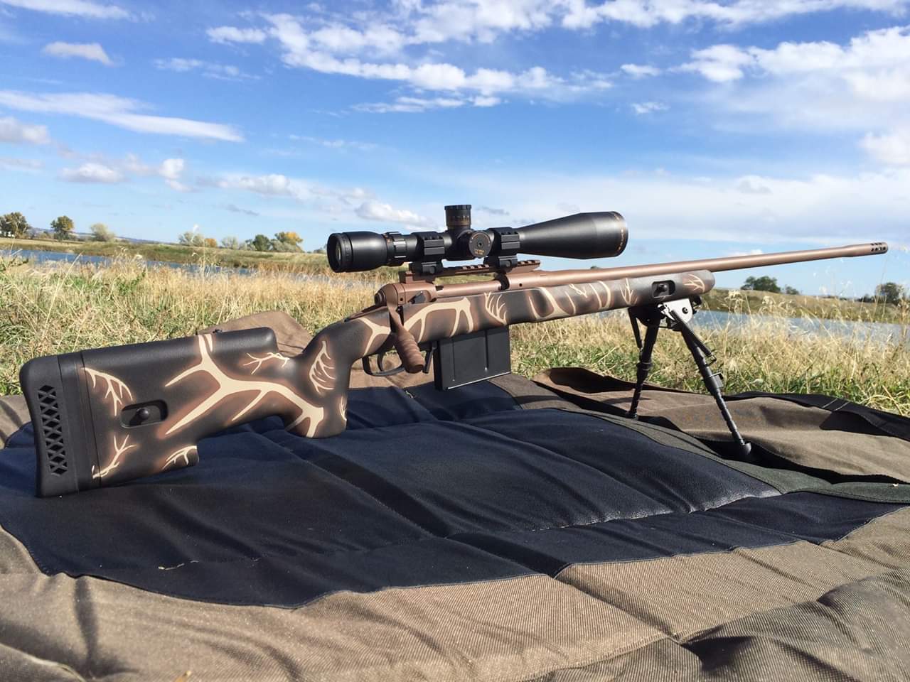

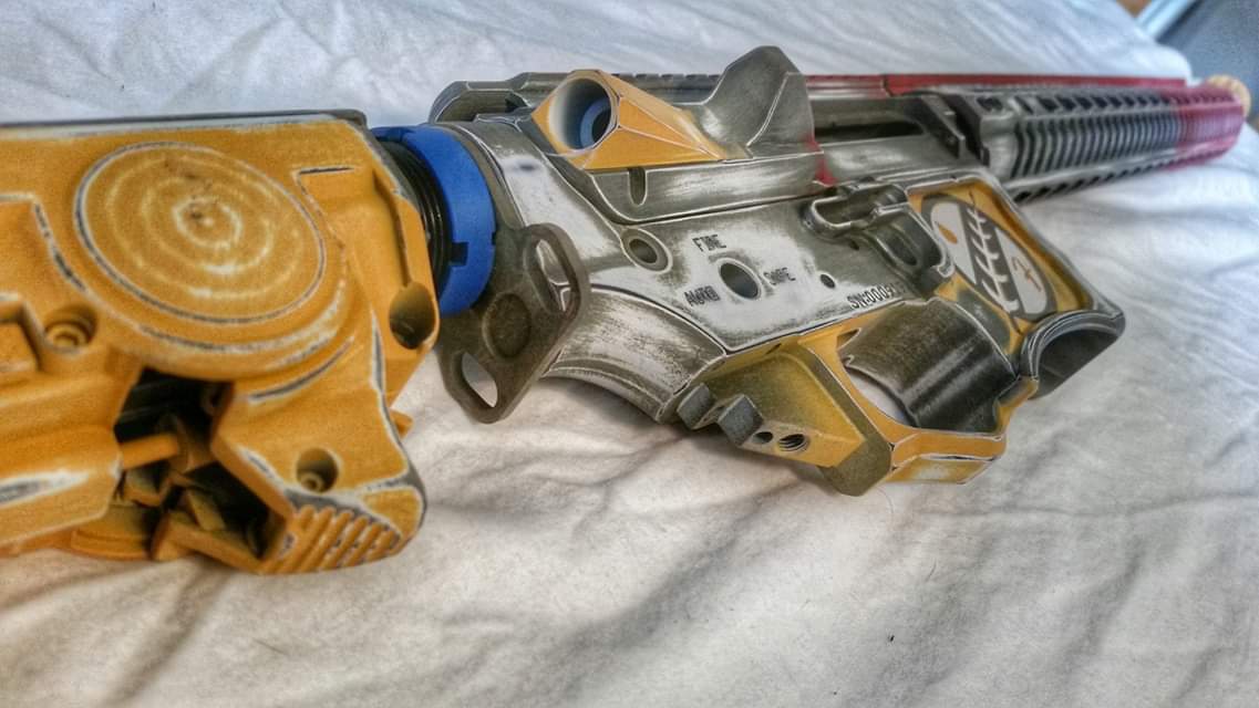

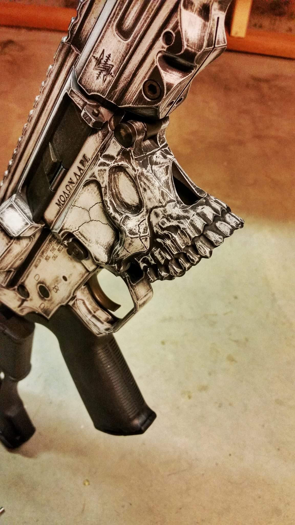

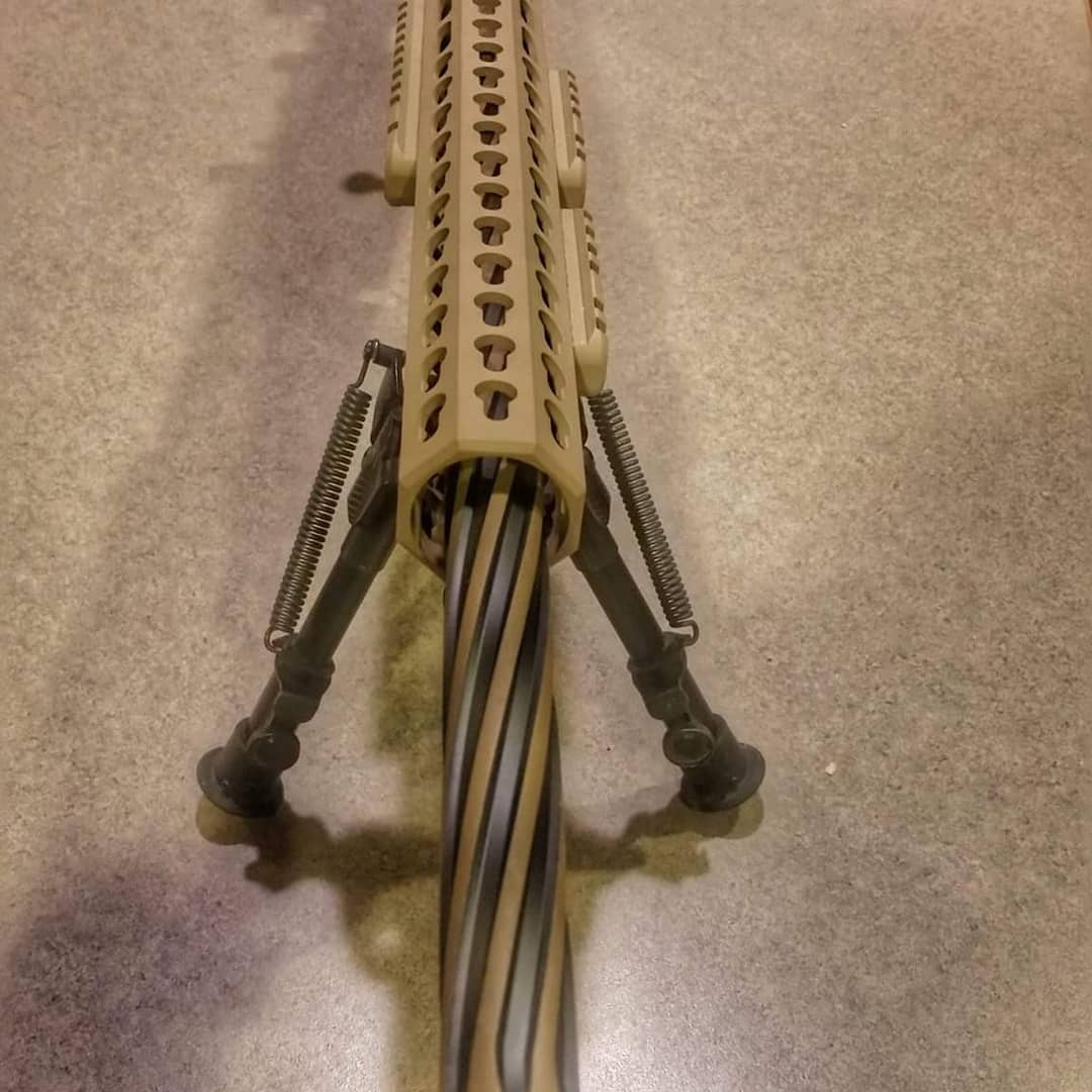

Here's a sample of my work.

Nice looking work. I have a Cerakote shop and we are in our second year of operation (we are factory certified). For me, it’s all Cerakote, I’ve only used the clear coat on two jobs so far.

I have a friend that wants a fluted barrel black leaving the flutes Stainless . How would you guys go about this ? Asking around I was told to tape down in the flutes then roll a ball bearing with pressure to cut the tape along the flute edge . Will the high temp tape hold up to blasting then coating or should it be remasked ?

I use a double layer of blue painters tape for blasting and then redo with high temp tape to coat. High temp tape isn't as sticky as painters tape and can come off during blasting.

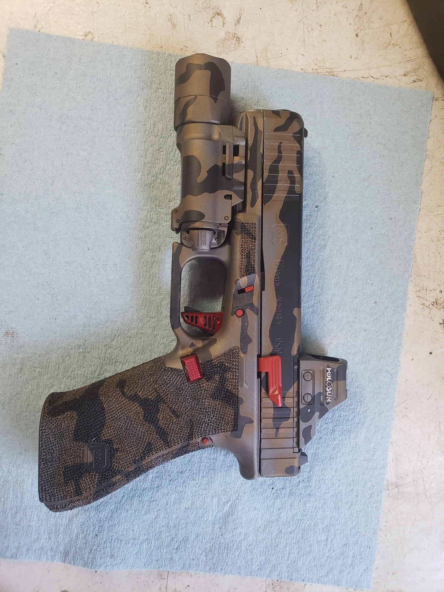

I used blue painter's tape and high temp tape. Painters tape for me didnt peal off as clean as high temp. But the flutes on my barrels or the ones I order are pretty sharp flutes which makes it nice. And then ball bearing it or the handle of a knife.

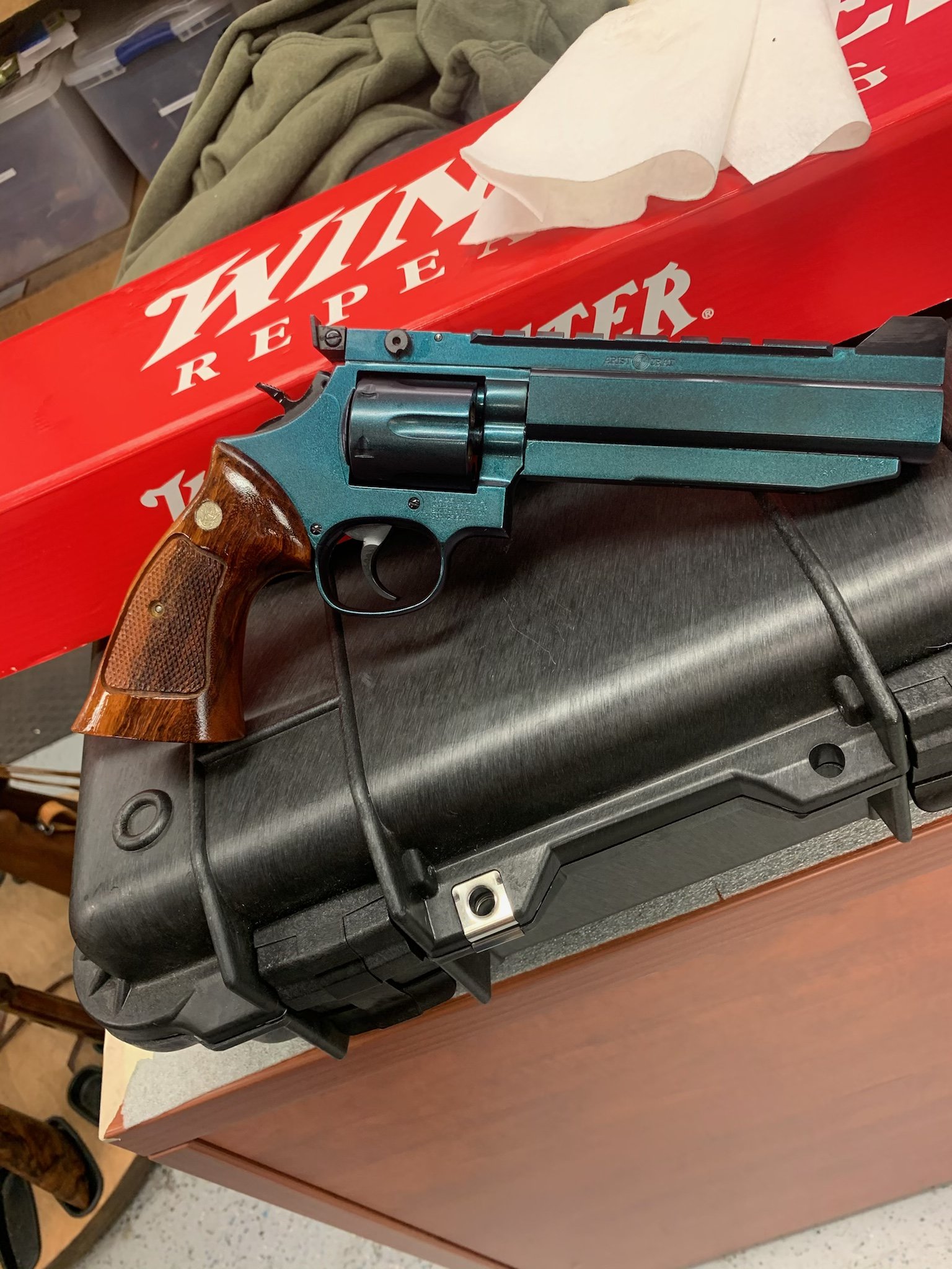

I like that! How does it spray? Never played with the candy as it seems to flashy for me.
It sprays just like the clear. The pigment is a very fine powder that mixes with the clear coat. They've got some colors that aren't real flashy, but have a metalic sheen. Pretty simple, if you use the air cure.
