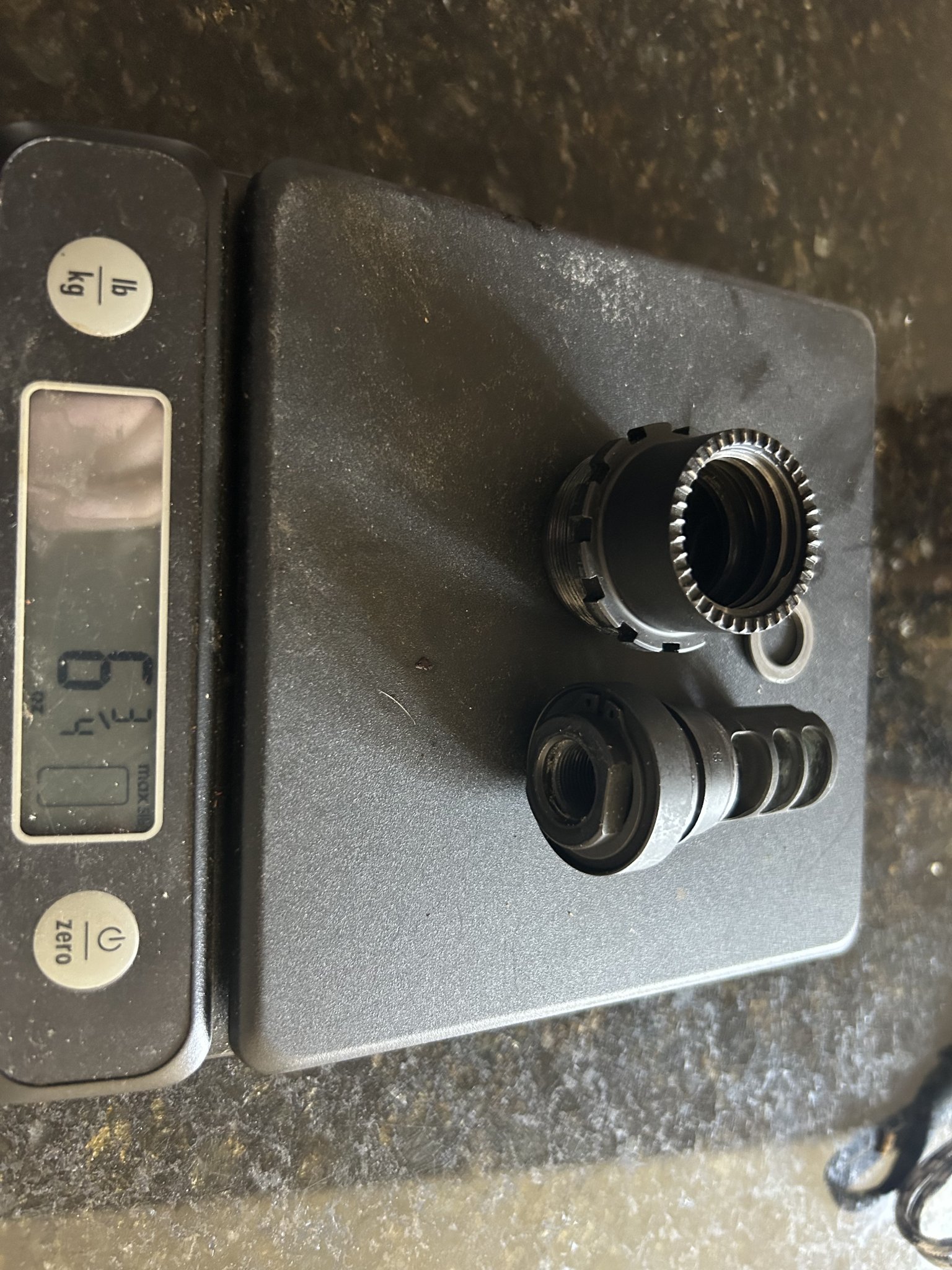

There’s about a 3 oz diff in weight and about an inch difference in length between the YHM phantom and the Rearden/cherry bomb systems. I made the switch for most of my guns, but I have 2 that still wear the phantom brakes. The only real down side to the Rearden/Q stuff is the cost of entry. $1500 on mounts and adapters is a pretty big pull to swallow.
BTW, how do you adjust the phantom collars for lock up? That would eliminate my biggest complaint with their system. Thanks.
