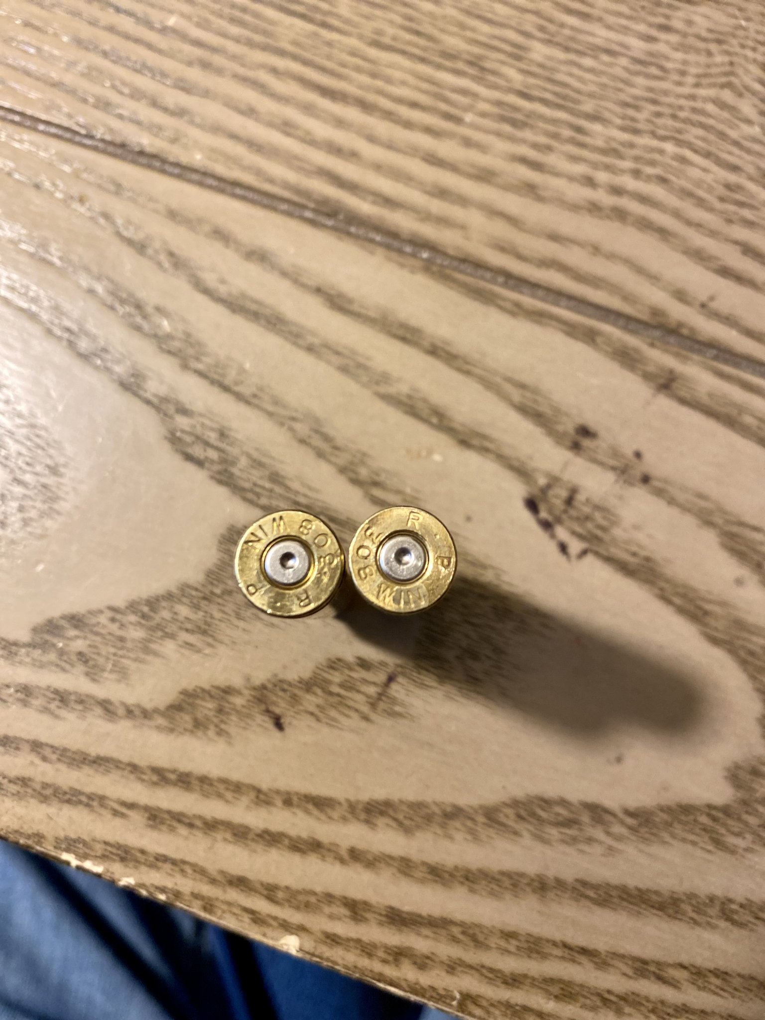

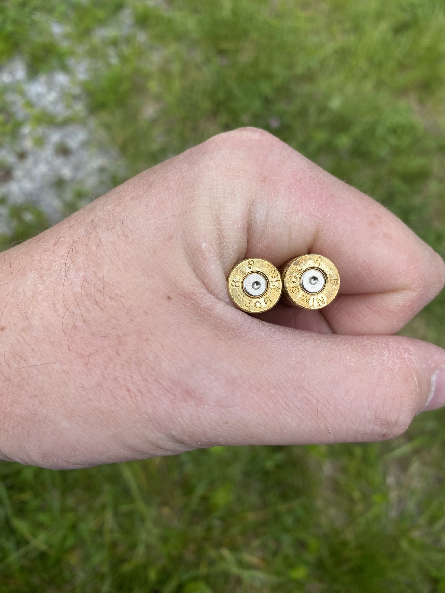

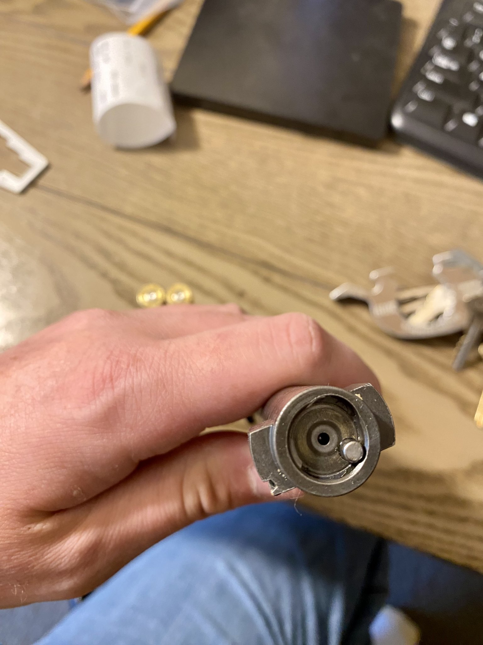

Starting a new load for playing with. Fired a few into the bank to check for pressure signs. The 2 test loads primers look ok, but I see a very distinct plunger mark on the brass at about 6’oclock in the pic. I also noticed brass on the bolt face.

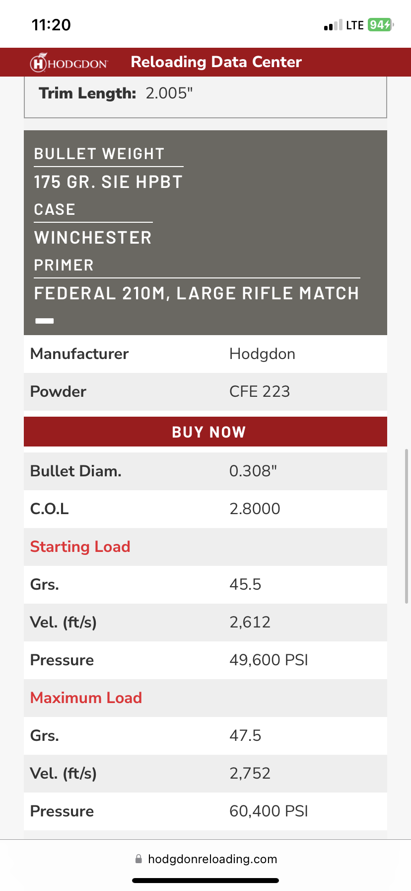

I used the hogdon starting load of 45.5 grains for a 175 smk. Am I being too cautious or have a right to be concerned? ETA cci benchrest large rifle primers, 70 degrees.

I see that is RP brass. If it was fired from factory loads, are you sure those ejector prints were not there from the first cycle?
If you have no bad history with the rifle using other ammo, I would suggest the next session is one where you carefully study all the ammo and cases up front. Try some factory ammo first and see if that shows problems.
Try to run with a chronograph to see if the speeds also make sense and track with expectations.
Try to double check the charge weights. If you have any leftover, it may be worth taking one apart to check it. If all of them looked like your photos, versus statistical issues, you have a chance to find it by checking one.
Another idea is to try the same load with a different brand of brass.
Double check all your brass prep dimensions to be very sure before you repeat the tests. A start load of CFE223 isn‘t supposed to cause pressure signs, so you were right to question the marks on the brass.

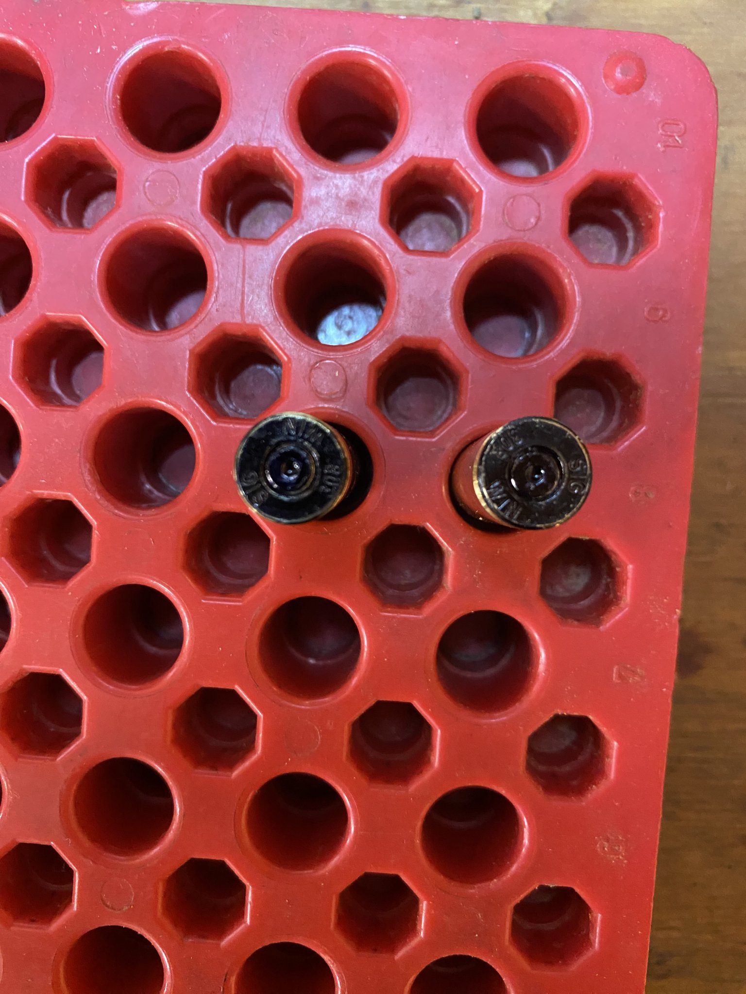

I've gone to "painting" the bottom of the case with a Sharpie to see if new ejector marks appear... It helps differentiate old marks from previous firings against new ones.

Ejector hole marks are a sign that one of two things is going on:
- Pressure is too high for that particular brass (softer brass will show marks at lower pressure than harder brass, brass is not all equal)
- Headspace was too large. This is the relationship between your sized brass and the chamber, NOT just a reference between the chamber and a go gauge. Pushing the shoulder back too far while sizing = excessive headspace, which causes ejector hole marks.

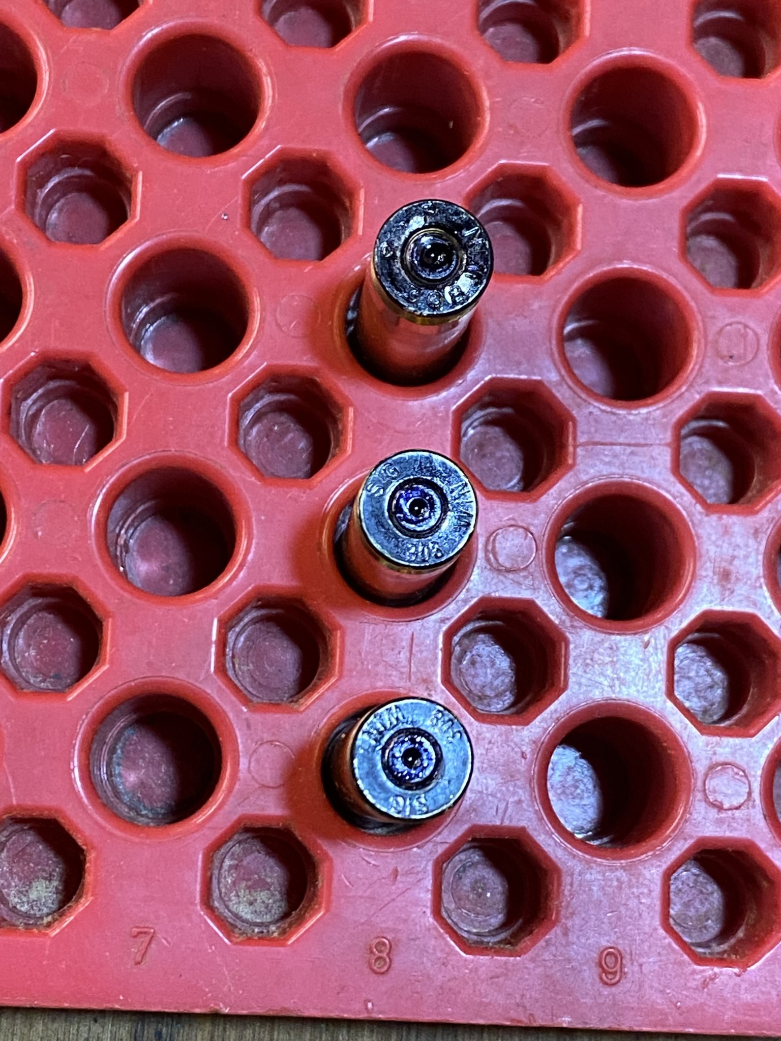

Took a lot of advice in this thread:
-re-checked charge weights
-tested scale against a known reliable scale
-checked oal and seemed ok
-Sharpied the bottom of test brass. Sig showed no marks, the RP brass still had marks.
Tried some prepped Sig brass and signs disappeared.
Both brass have the same trim length and the same prep.
