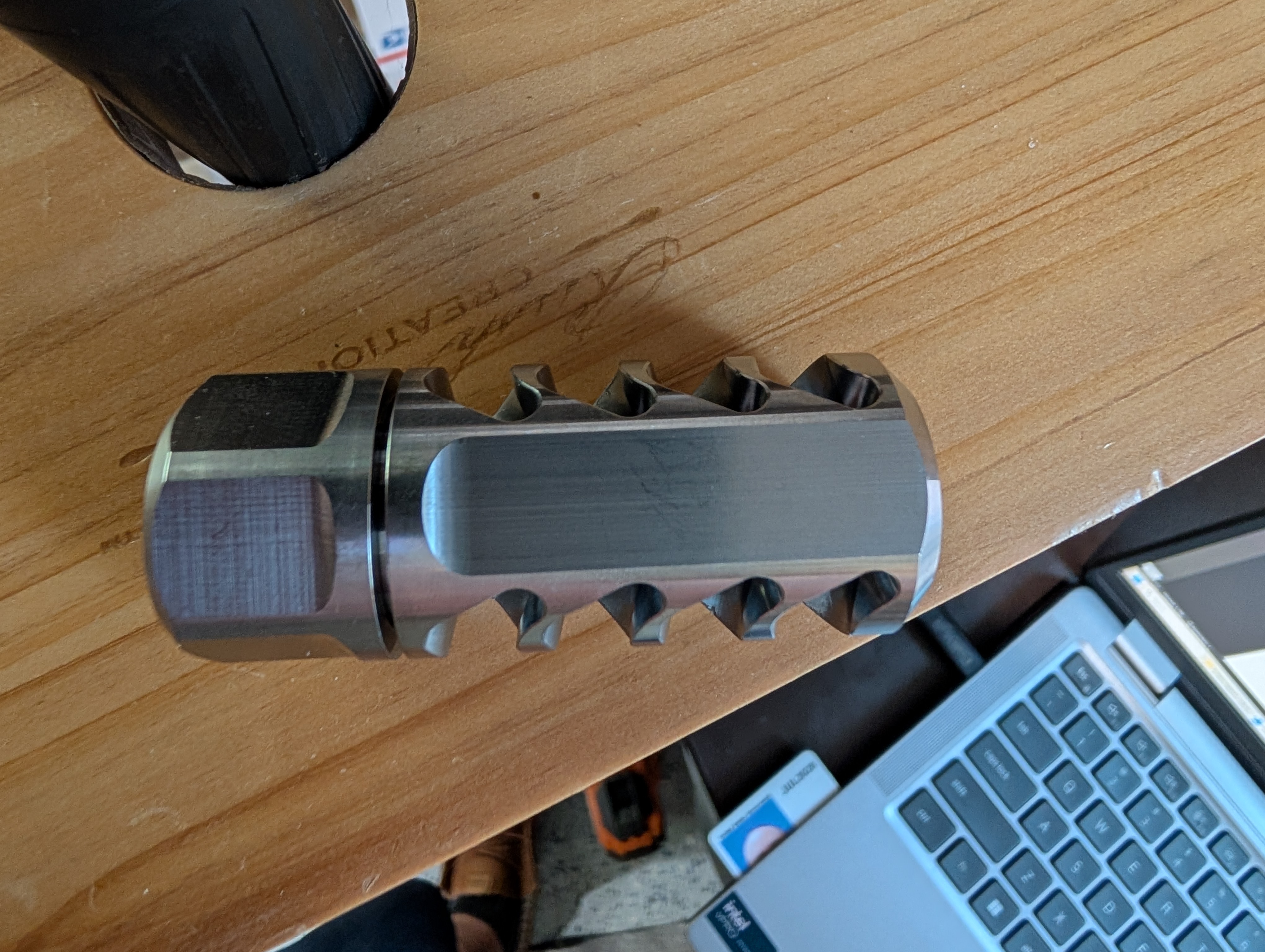

Haven't tried the Botnia, but the concussion from the Chad was pretty terrible in my opinion. Extremely effective recoil reduction, but it didn't matter because the time spent recovering from the flashbang that just went off 3 feet from my face was about as much time as I'd spend requiring the target with a suppressor. I found the DN5 to be a pretty good middle ground between recoil reduction and concussion at the shooter. Side benefit, it's not $600 for a brake.

The Chad is more pleasant to the shooter so that's the direction I would lean. I know guys who have both and can't really tell too much of a difference.

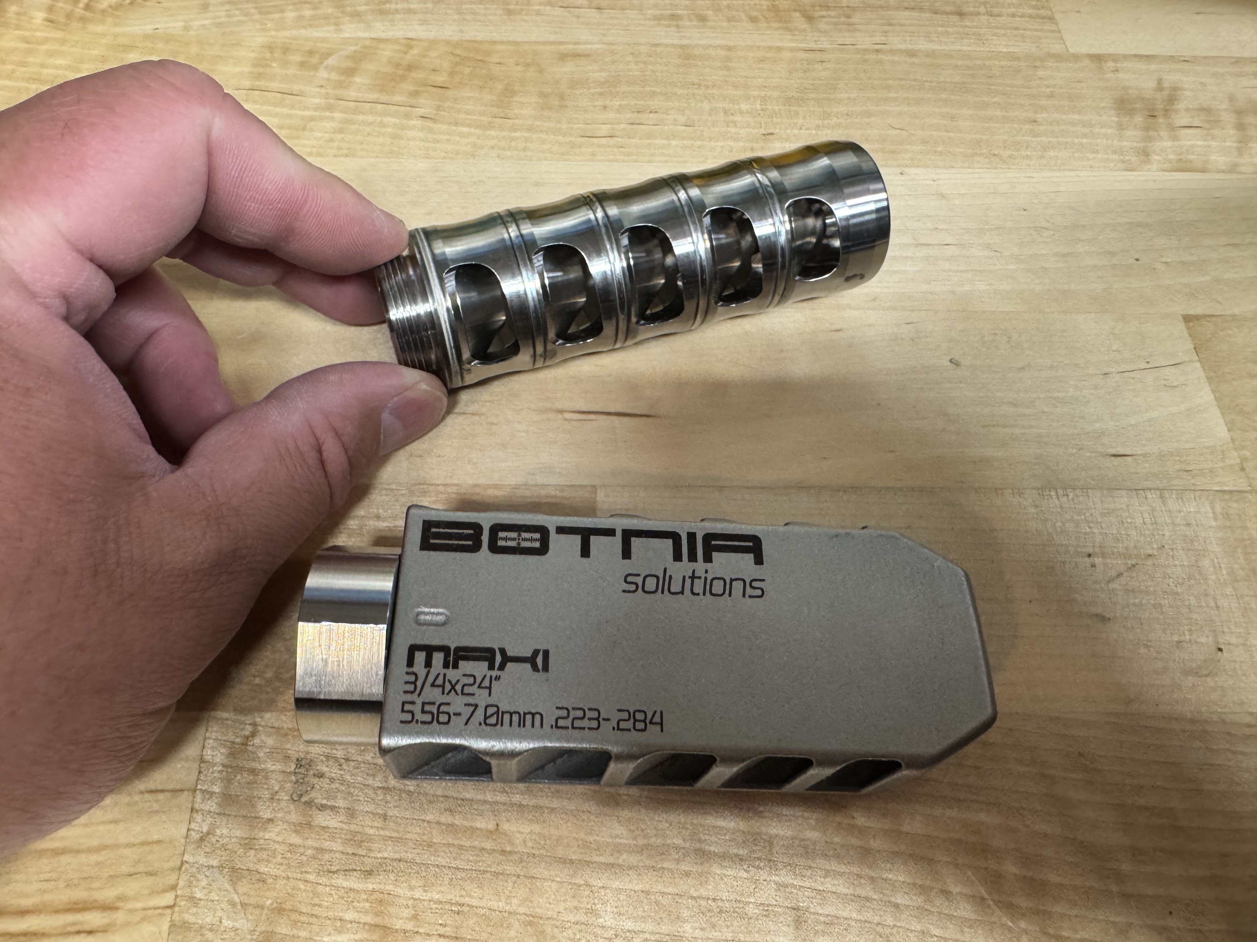

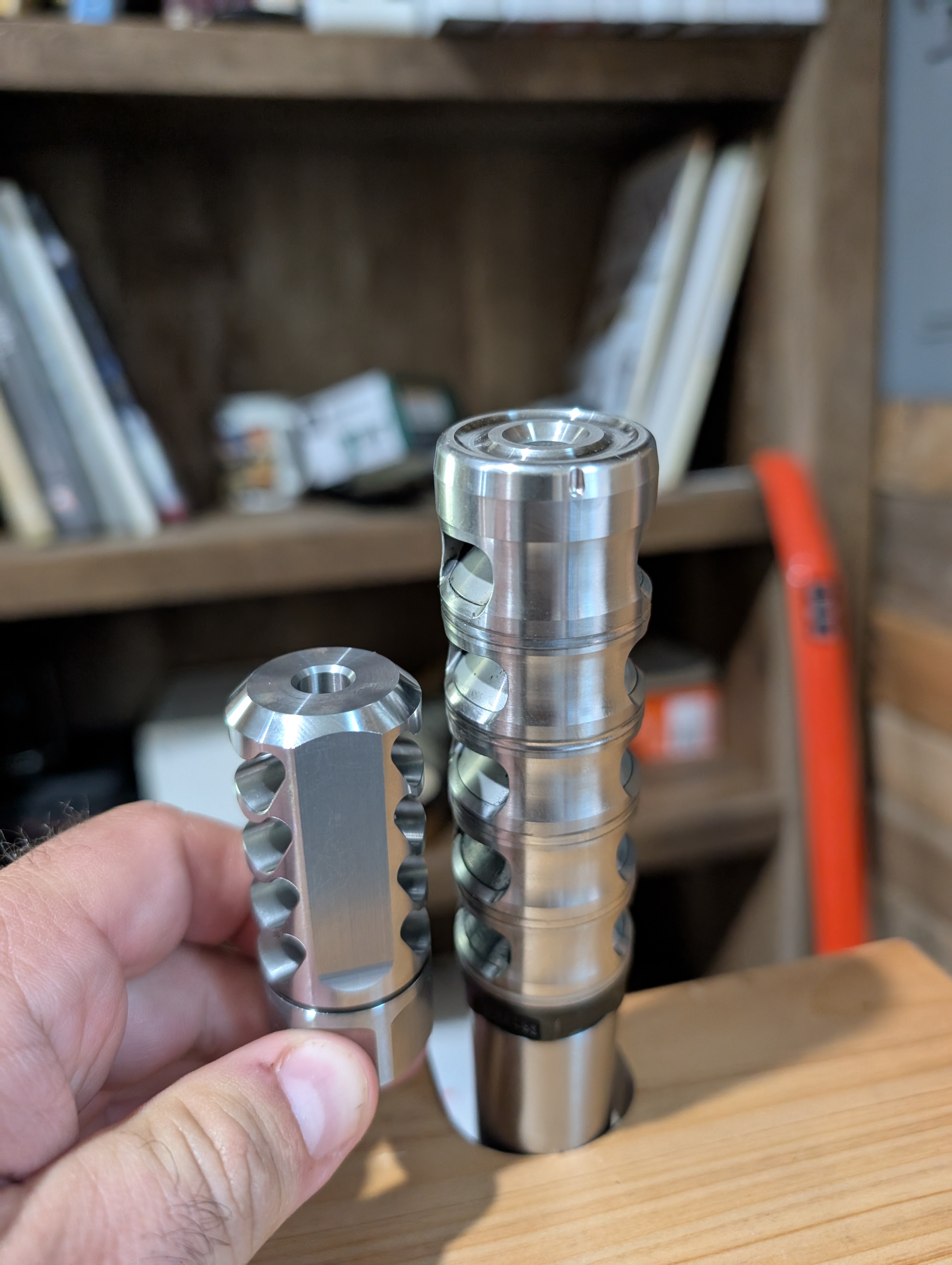

I've put quite a few rounds through both. Setting being on PRS open rigs in 6.5 Creed & 6 Dasher, and NRL Hunter Open Heavy rifle in 6.5 Creed. They're very good, but a but different. That said, in my use cases I don't think you'd be able to really tell in a 6mm. 6.5 is where I was able to notice differences. See below...
Chad: Keeps rifle flatter. Blast isn't bad on the shooter. If you shoot under cover (roof), then it feels a bit louder than I'd like. Nice that I can use 5/8 and 3/4 muzzle threads. Blast isn't a loud ringing, but more of a wave of air the washes over you.
Maxi: Less recoil and feels softer, but little more muzzle rise. Nicer when shooting under a roof. Nicer/easier way to set timing on the barrel. Blast isn't bad on the shooter. I "see" the blast more in my peripherals.

I’ve shot both and IMO the Botnia is better as far as recoil reduction and kinder to the shooter as far as blast/concussion as compared to the Chad.

I really like shooting the Chad, that said I have pretty much switched to shooting Suppressed. It is just so much more enjoyable!
I have both. I didn’t really feel a noticeable difference in 6mm. 6.5cm the Botnia feels a little flatter. 7mm definitely the Botnia is flatter.
Only have shot the Chad, was at JTAC class and shot my gun off the barricade with my Ace break with my 6GT. Then shot my buddies gun which is almost identical to my setup other than he has the Chad. We were learning their free recoil and with my Ace I was getting 2-2.5 mils jump. When I shot his with the Chad it was actually -.5 mils. To me the blast was no different than my Ace.
I have both. Botnia and Chad. With 1000+ rounds on each in matches. They are equally flat on muzzle rise and recoil but the botnia has less blast and vibration in the rifle system. The muzzle blast is violent and the vibration can be felt through the whole rifle with the chad. The vibration impulse is extremely fast so it has little effect on your ability to see what’s going on downrange but the botnia has the edge in performance because it’s so much less violent. My opinion.

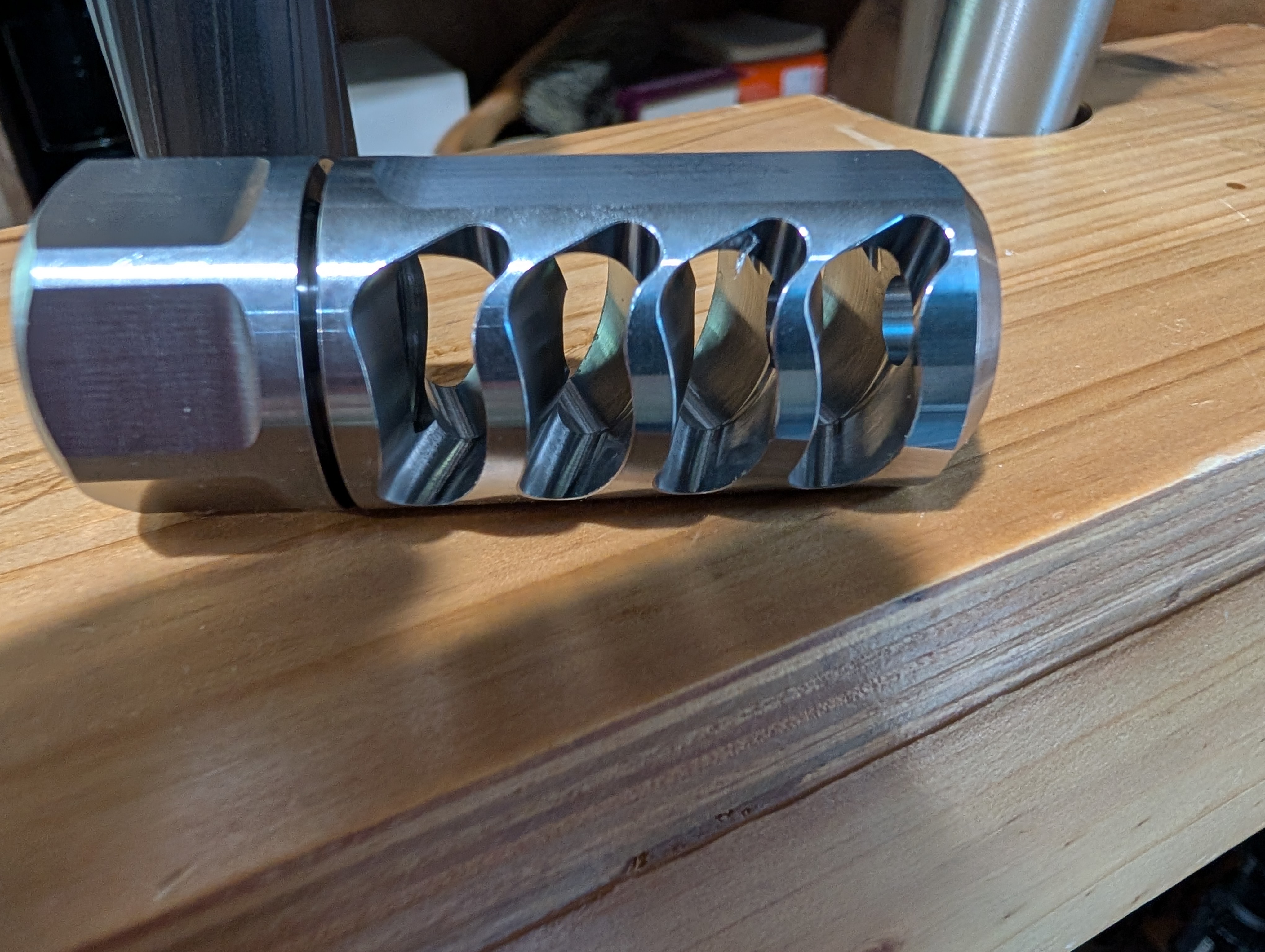

Performance equals how much gas deflection a brakes has and how efficient the brake is. Gas deflection means more gas being moved through the brakes geometry instead of it escaping down the bore and out the front and efficiency means how effective the brake is at converting that redirected gas then to recoil reducing energy via jet effect and gas pushing the brake forward.

The more gas you redirect, the higher the intensity of the blast (because the pressure will be higher), and because the volume of gas that’s being redirected is larger, the longer you’ll feel it for. The higher the efficiency of the brake and the faster the exhausting gasses, again the more you’ll feel the gas as they will carry that intensity further.
All gas you redirect is felt by the shooter and the more aggressively you direct it rearward, which increases performance the greater the angle, the higher the affect of the blast because it’s directed closer to the shooter.
So no matter which way you look at it, more performance equals more blast coming out of the brake.
Now the only way to reduce how much of that blast the shooter feels with a high performing brake is to use angles to direct the blast in a direction, that compromises and hurts performance the least amount, while creating as much distance between the blast and the shooter as possible.
The chad directs the entire blast upwards at an angle of 15 degrees (our patent pending redirected blast tech) and rearward at an angle of 47.5 degrees. It’s a compromise that doesn’t hurt performance much while creating a lot of distance between the blast and the shooter vs the original tmb. If I tried to add more performance to the chad tomorrow, every percent of performance I added to it, would increase blast to the shooter. There’s simply no way around it.
So it’s not really possible to make a brake that noticeably out performs the chad in recoil and blast at the same time while being of a reasonable size. You might find a blend of angles that combined with really high efficiency internal geometry, technically has a few percent better performance with only one extra percent in blast but it’s not going to be a game changing difference.
The more important factor to focus on differentiate the two would be the personality of the brakes. They do similar things but are very different in design and thus have very different recoil impulses.
