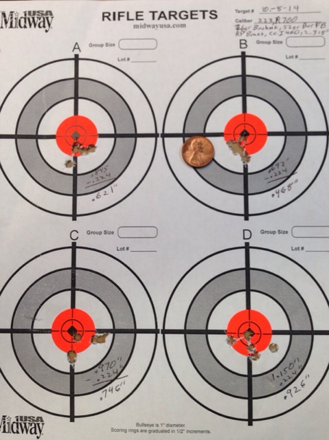

Took the .223 out finally.
The rifle is a Rem Tactical with a 20" bull barrel currently setting in a B&C Light Tactical Medalist stock not bedded.
The group is 5 shots and measures .505 outside to outside.
I was using LC09 brass, CCI 400 primers, IMR 3031 powder and 52gr Berger Target Moly bullets.
** Edit - Now that I know the load works this well I'll put together 25 more and get the 5 groups on one page.

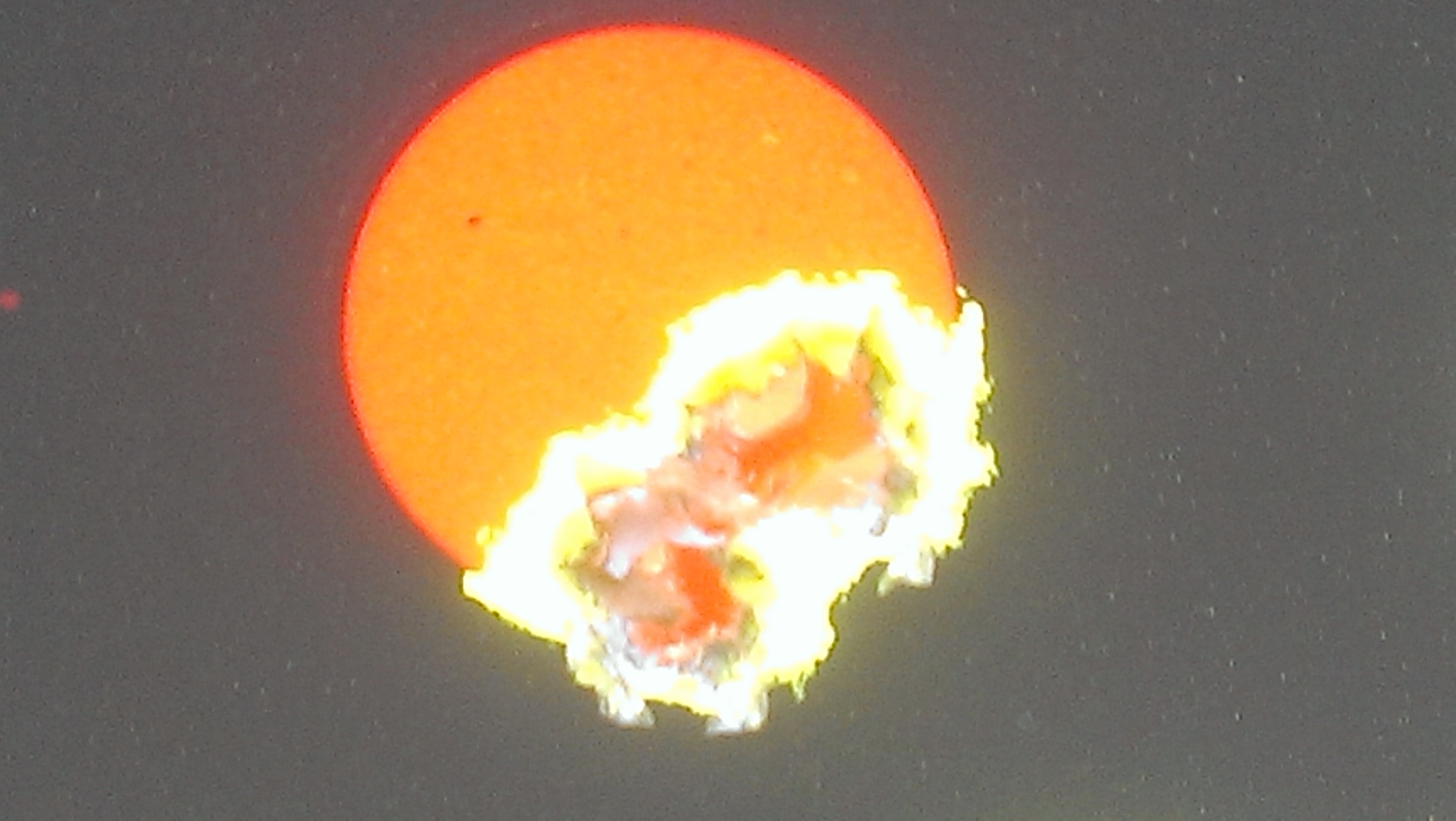

I can only add this one single picture - as the rifle has now been converted to a different caliber. This 5-shot string was out of my Savage 10FP 24" .223, only modification was a Bell & Carlson Medalist A2 stock and Glade's Armory bolt handle. Load was 25.1gr of H335 under 69gr Nosler Custom Comp and Wolf SRP, COL of 2.260"
Less than 2 months after shooting that group, I yanked the barrel. There was virtually no rifling left in the first 1/4" of the barrel, I think the previous owner (bought the rifle used) shot it a bit more than he led on.
A couple old groups , I need to load some ammo and fire a string on one target.
Remington 700 Tactical with stock barrel. Threaded for AAC blackout flash hider and suppressor mount. Groups fired with AAC M4-2000 suppressor attached.
Its boring but fun to shoot.
69 Sierra BTHP / N140
52 Sierra BTHP
