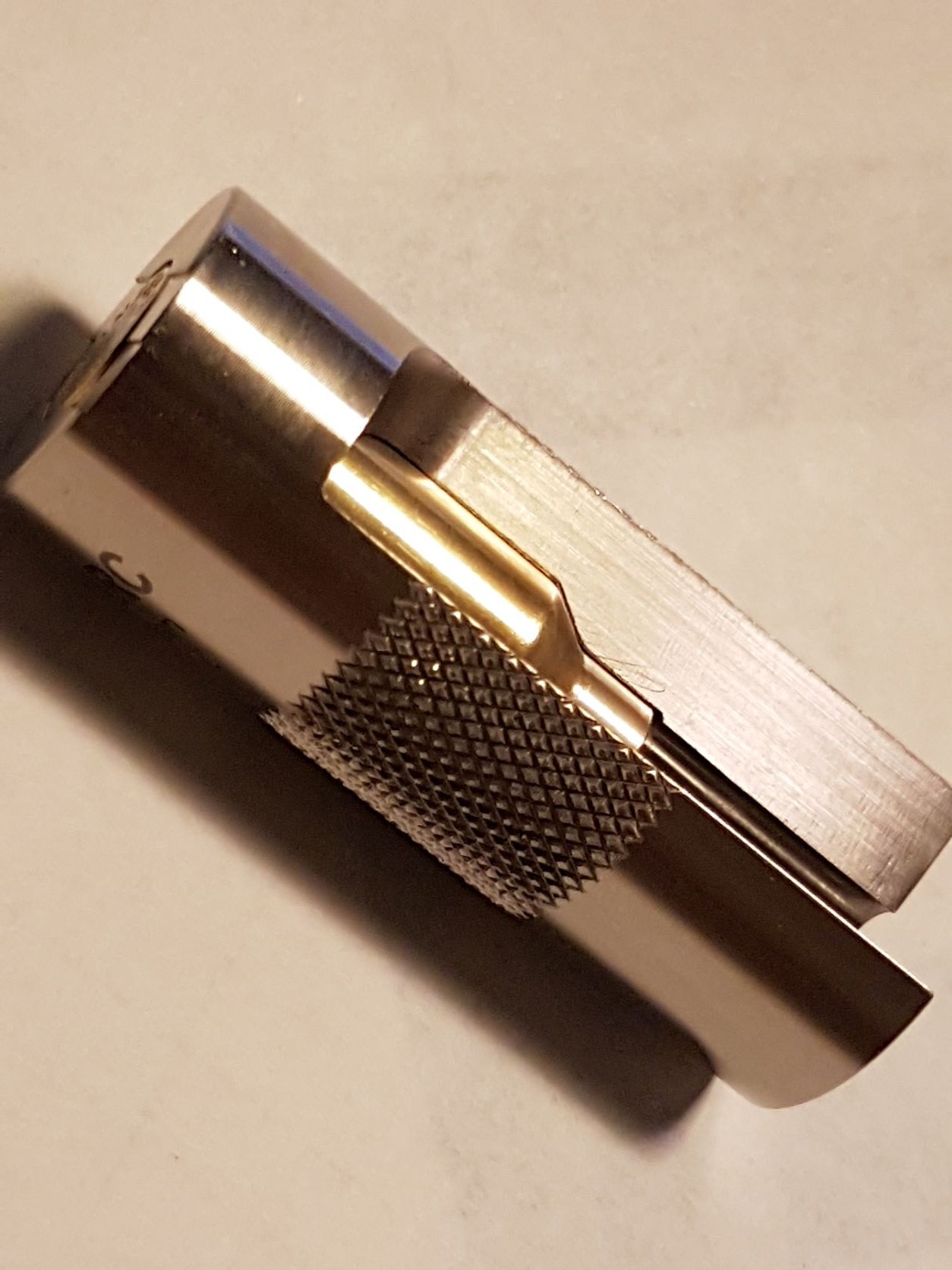

....this is why I prefer the Sheridan Slotted gauges, it allows you to see where a casings issue lies, i.e., the base reduction, the shoulder bump and trim length....all in a single glance. The gauges are cut with a SAAMI chamber reamer (at MIN spec) so it ensures cases that fit in it will fit a properly cut SAAMI chamber. I would imagine if there is enough demand, I suspect Sheridan could add 6GT gauges since it is a SAAMI spec cartridge.
...sample of my 6ARC gauge that was used to validate my conversion of 6.5 Grendel cases for my initial sizing die setup before committing components to loading, YMMV.
Would likely do nothing at all to identify potential sticky cases due to sizing issues. Most of the time, the brass fits in the chamber fine.
They are cool for sure and really good visual tools.
But not really gonna help the OP’s situation except in the most extreme situation. Which is typically obvious and had he taken advice thar was giving immediately in the thread, he would have known immediately.
...I don't disagree with this.
Assuming the OP had the proper tools (calipers. comparators and inserts) to measure his fired cases and the experience/knowledge to apply his findings to adjust his reloading process, he could have done so. My suggestion was based on the tool the OP used in the attempt to debug the issue. The benefit of the Sheridan tool is to create a loaded cartridge that WILL FIT in a SAAMI spec chamber so it CAN be fed/chambered and fired. That fired casing can then be measured to extract updated data to adjust one's load procedures. If the loaded cartridge can't be chambered, it can't be fired to blow the casing out to conform to the chambers dimensions so relevant data measurements can be obtained for subsequent reloading.
