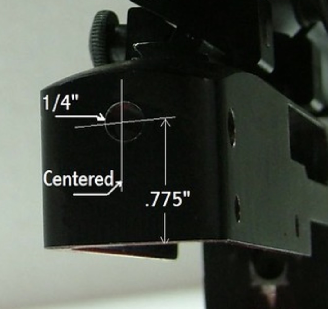

Always better to clean from the chamber end. For 10/22 it is as simple as drilling a 1/4" hole in the back of the receiver.
