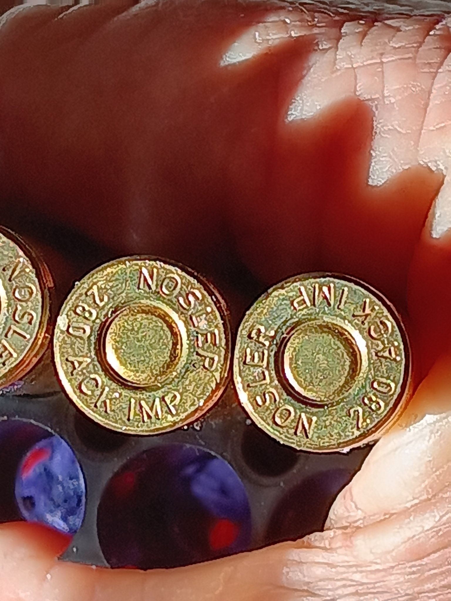

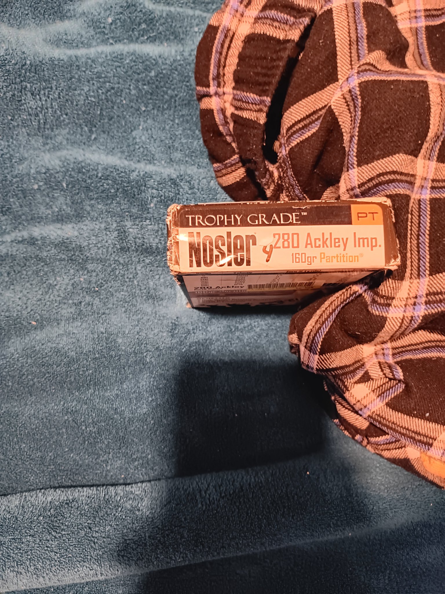

I haven't been on here for awhile so be gentle, and I did use the the search function with no results. I purchased 80 rounds of Nosler Trophy Grade 160 Gr. Partition in 280 AI ammo several years ago and put it in the safe. Problem is, I decided use it and when I chamber some of the unfired rounds, they won't eject but fall out if I tip the muzzle up. Out of the 80 rounds, 39 fall back out. All other factory loads, no problems, rifle has approximately 50 rounds through it. I couldn't find any recalls on these particular lots of ammo. MODS, if this is in wrong forum, TIA please move.

OP, can you get your extractor to grab the round with the bolt out of the rifle ?
tried several times but the extractor won't grab the case. It seems to be just these 2 particular lots of ammo, other brands chamber and eject just fine?
You and me both. Only reason I'm reading the thread is to try to figure out what this means. @pooch what do you mean the rounds won't eject but they fall out? Are you saying the extractor is not pulling the round out of the chamber but if you tip the barrel up the round slides out of the chamber with the bolt open?
the extractor is not pulling the round out of the chamber but if you tip the barrel up the round slides out of the chamber with the bolt open?"
Yes, the extractor doesn't catch on the case and the round falls out of the chamber all by itself if I tip the muzzle up. It seems they were sized at the factory too small for the chamber? What is confusing is that other brands of ammo work just fine, even regular 280 Remington that I'm using to fireform cases works fine.
Do they extract and eject when fired ? Sorry if i missed that part. I have seen brass NOT work when dry cycling, but functions correctly when you press the bang button.
You need to compare the length of your fired cases to the Nosler cases. All 280 AI chambers aren't the same. The legacy 280 AI chamber is slightly longer than the Nosler SAAMI version. If your rifle is a rechambered 280 and the person that chambered it fudged and didn't set the barrel back before he chambered it, your chamber is longer than the legacy 280 AI chamber. This could cause your issue.
