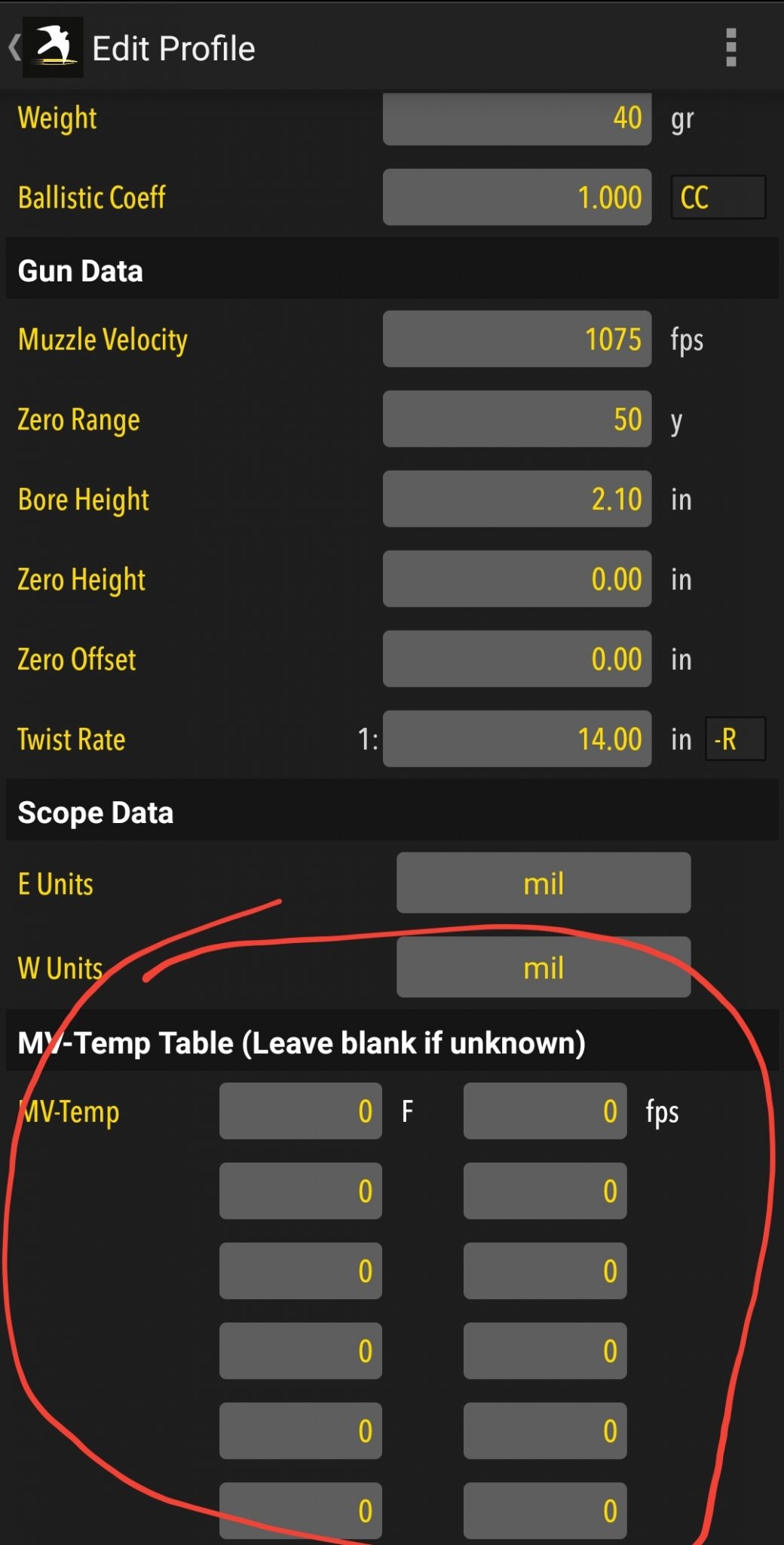

    You said it yourself earlier that you can have 30-40 fps speed differences in the same box of ammo.
    honestly, trying to match ammo to the temperature to keep zero sounds like a lot more work than figuring out what your dope will be on 1 lot of ammo for any given temp....
    at most i could see having a "winter lot" and a "summer lot" of ammo.....but saying "im going to shoot Eley tenex at 80*, and Lapua midas at 70* and eley black box at 60* and Lapua polar at 50*" sounds like a fuck ton of work.
    personally i like to reduce as many variables as possible, and the brand, and more specifically, the lot of ammo, is the biggest variable we have in rimfire.
