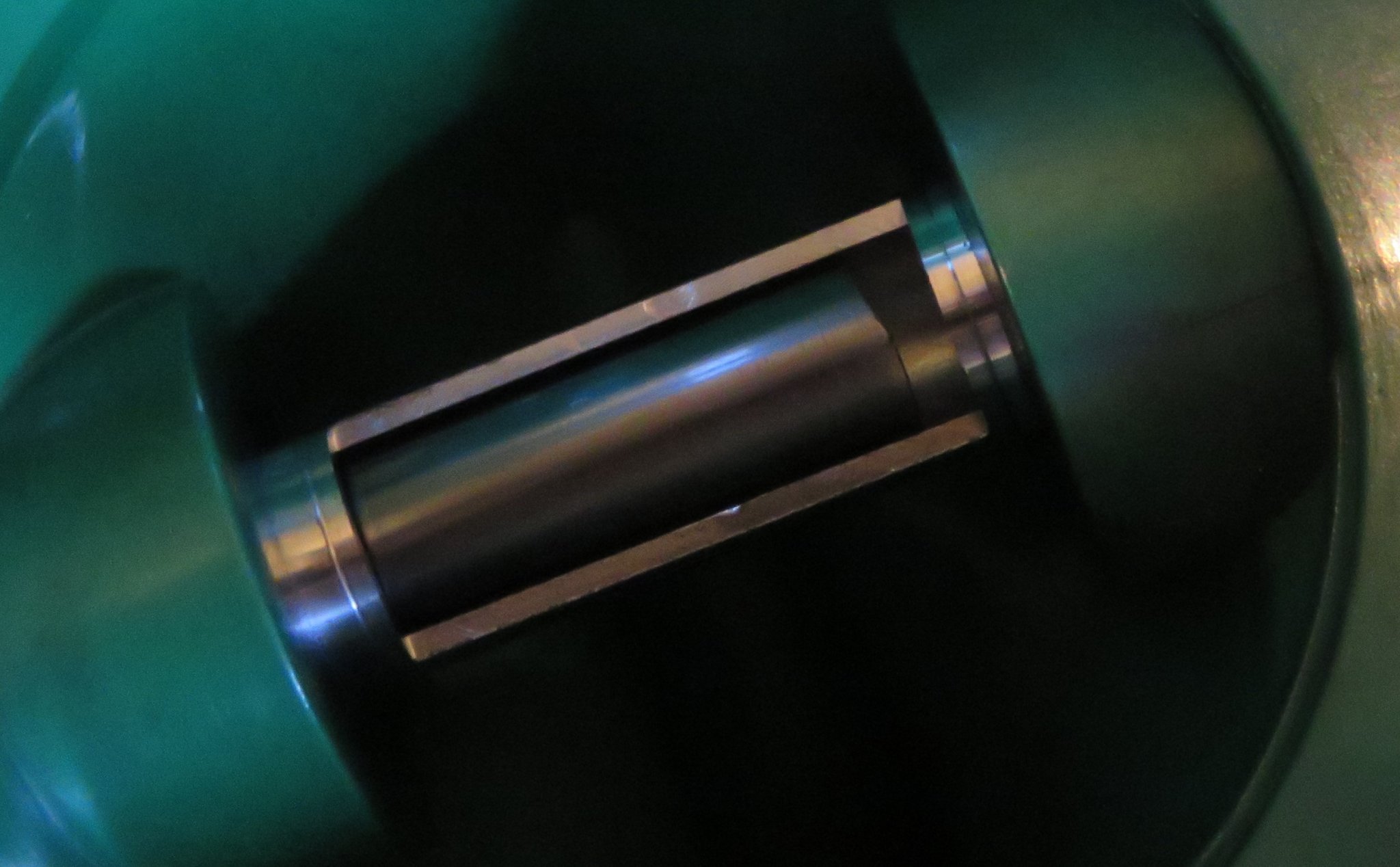

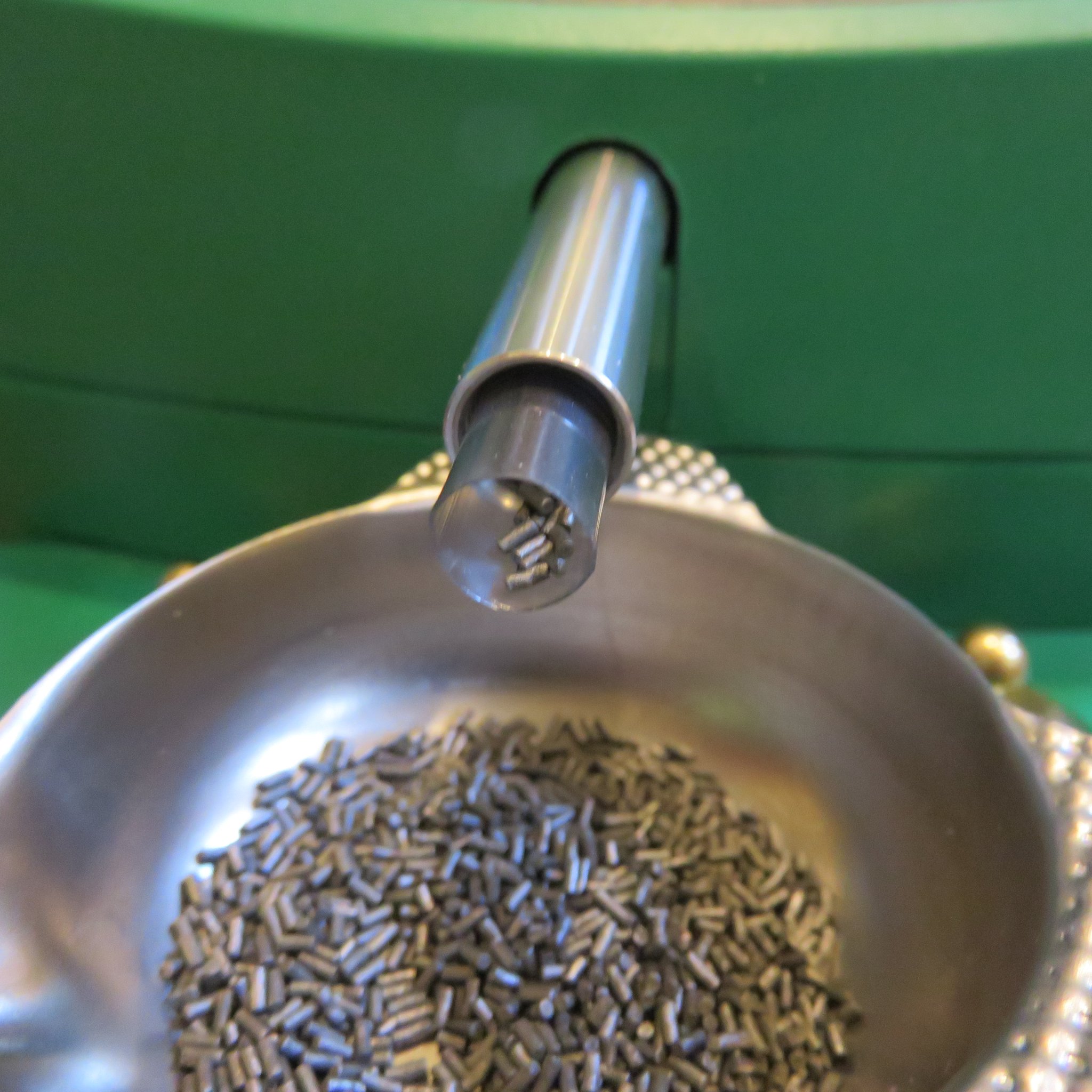

    The straw I use is not very tight and there's no problem moving it in and out. My straw is plenty long where I can shove it so far in that it will block any powder from interring the straw. I can pull the straw forward various amount to adjust how fast powder is going into the straw based on the size of the powder granules, which helps trickling reducing under and over throws. Here's what that looks like:
