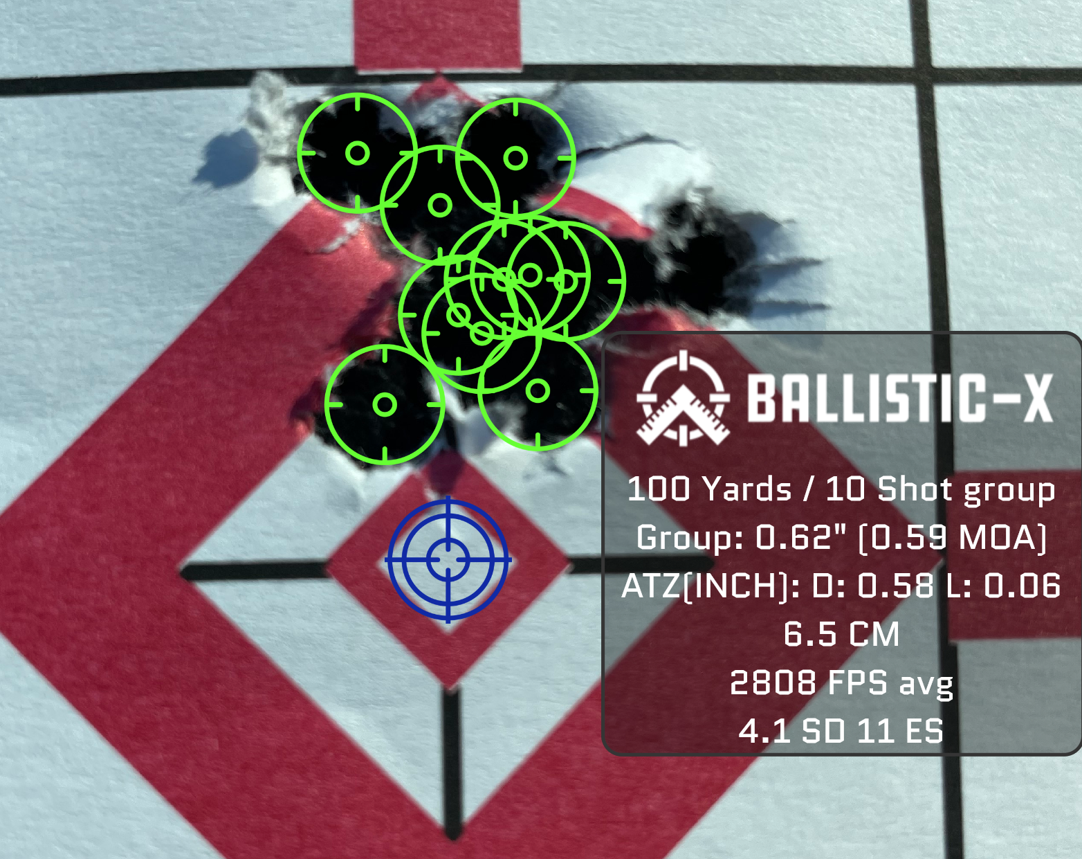

I bought the “oversert” from MK Machining for my Chargemaster lite, worth every penny. Also bought the MK pan as well. Throws fast and right to the money, no over or unders. It’s key to let it warm up, have it level, and I like to wipe my down with anti-static wipes when I turn it on. The last 10
shot group i shot with rounds loaded from it had an ES of 11 according to my Magnetospeed
