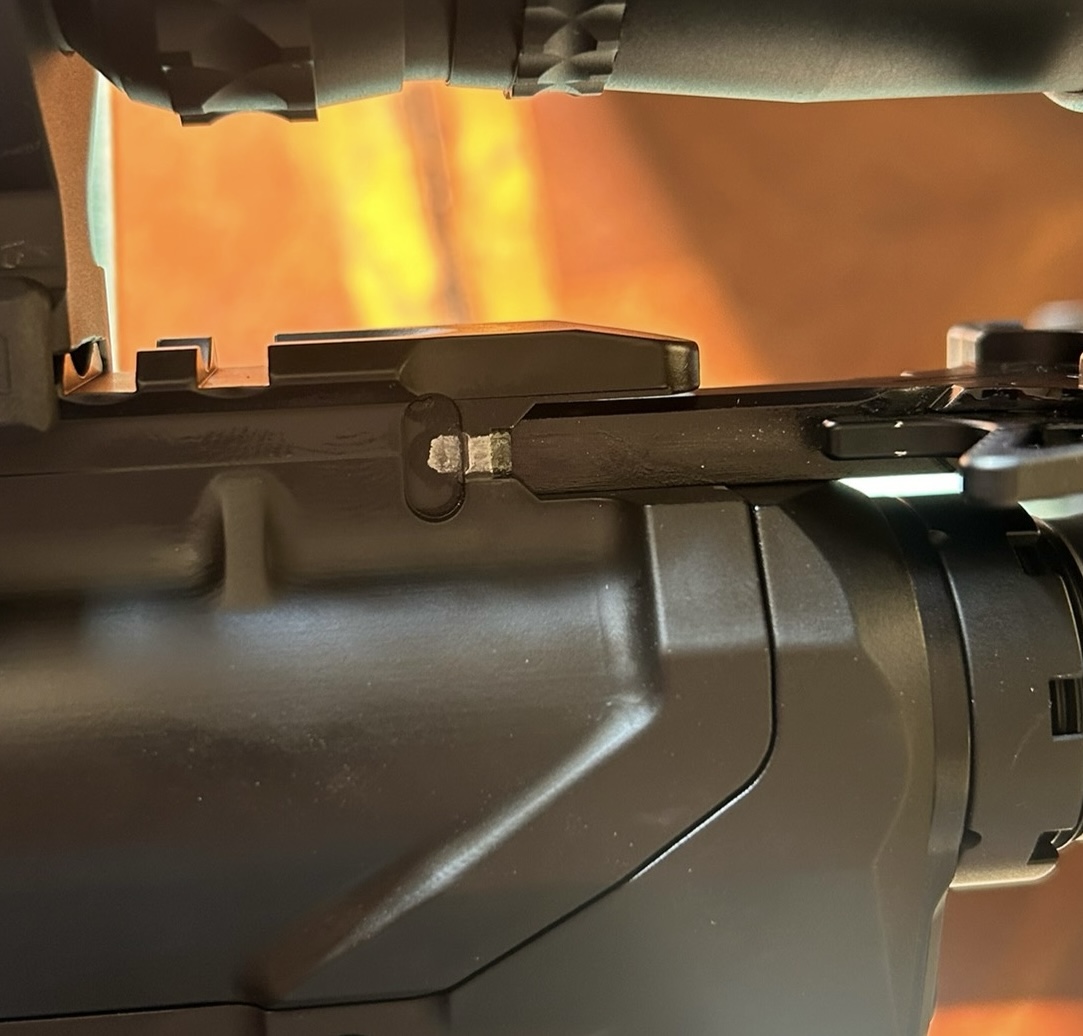

However see pic the charging handle is popping loose on last shot while I’m tuning quite a bit. Shouldn’t it stay locked on last shot regardless? Sorta looks like it’s wore the paint off which is probably normal but I never looked to see if that cavity had a sharp edge from new or was sorta rounded over like you see

The charging handle popping loose could be a few things. The action cycling so violently that the handle won't stay put, the locking arm on the handle being worn or maybe the notch in the upper receiver not being deep enough. Regardless, on a new rifle, this shouldn't be happening. I'd quit diagnosing and start packing it up to ship back.

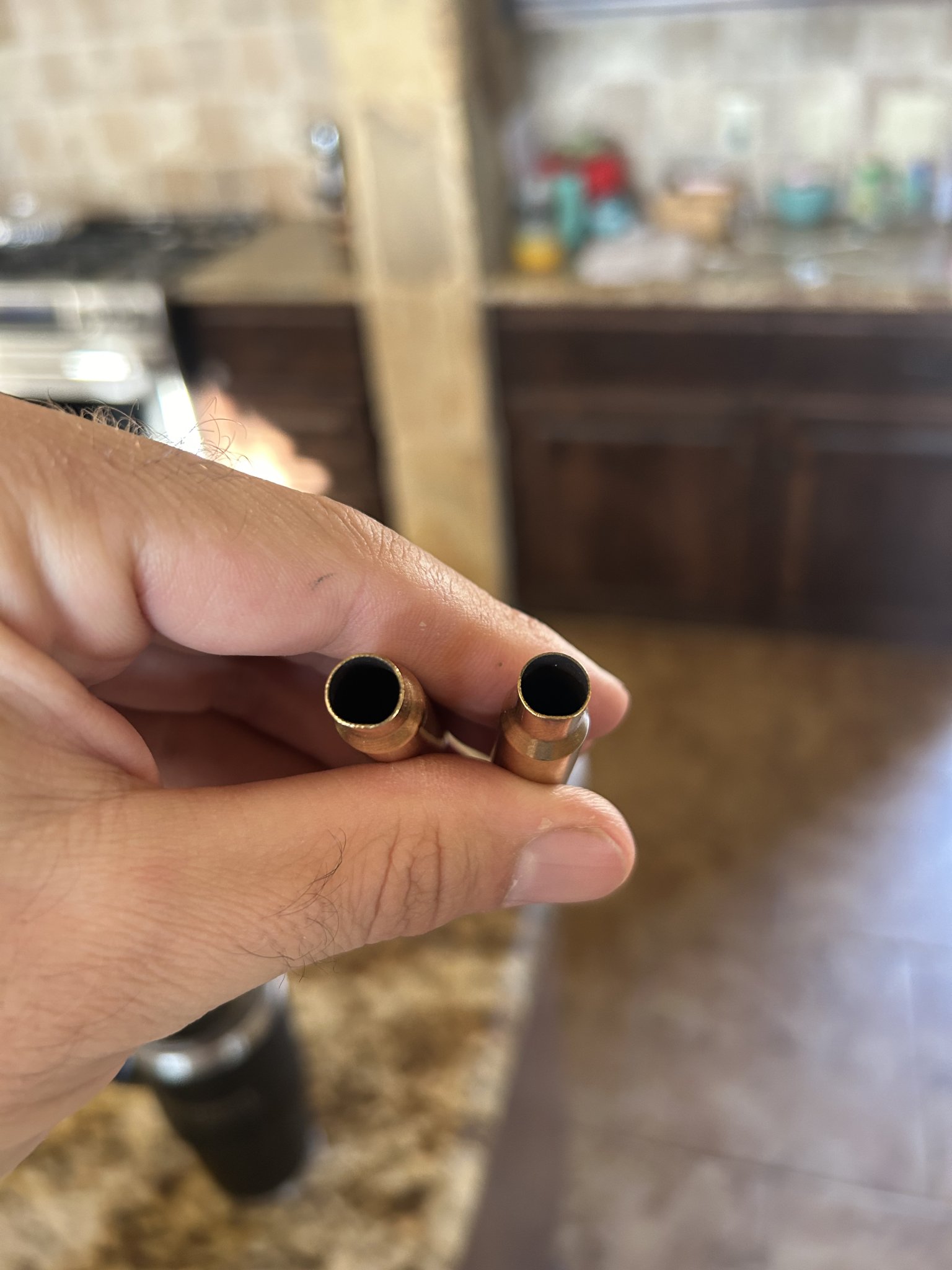

The casing should look fine, except for maybe some deformation on the case rim. It sounded like you had to struggle a bit to get them out. Next time, use either a bore safe cleaning rod to knock them out or google "mortaring AR15." Mortaring the rifle is an easy method of removing stuck cases ... as long as the extractor doesn't let go.
I broke the gun down yesterday and oiled the chamber area and bcg. Today the first two shots at my bolt lock back setting looked perfect…. Just for testing I closed the GB one click. Sure enough the next two rounds stuck but were not crazy hard to pull out. Went back open one click and didn’t do it again. That’s when I decided to give it the two extra open “insurance” clicks on the GB that most everyone does and not one case has stuck again.
All I see on the stuck cases was the bent area on the case neck rim and a scratch on the side of the neck.

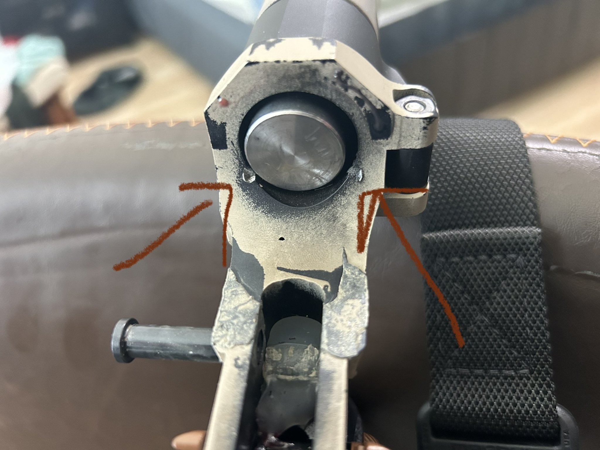

However charging handle still popping out in last round and hitting me in that nose. I think I may have found the issue. Look at the pick of the bottom of my charge handle and see the two wear marks where the bcg is coming back and hitting it.
Does this look like the problem or is this normal. It is going it on last round of mag everytime
I pulling the charge handle out of a larue which is a precision reflex handle and that channel is milled all the way back where this V7 stops about 1” short. I’m tempted to swap them but I’ll wait and see what Joel says

Wanted to update this for both parties involved. V7 sending a new charging handle, for whatever reason that channel on the bottom is a smidge out of spec of the gun is throwing the BCG back a smidge farther than spec... Either way i put in a different handle i had and no trouble. So V7 sending me a billet ambi charge handle free for my trouble... Great company
