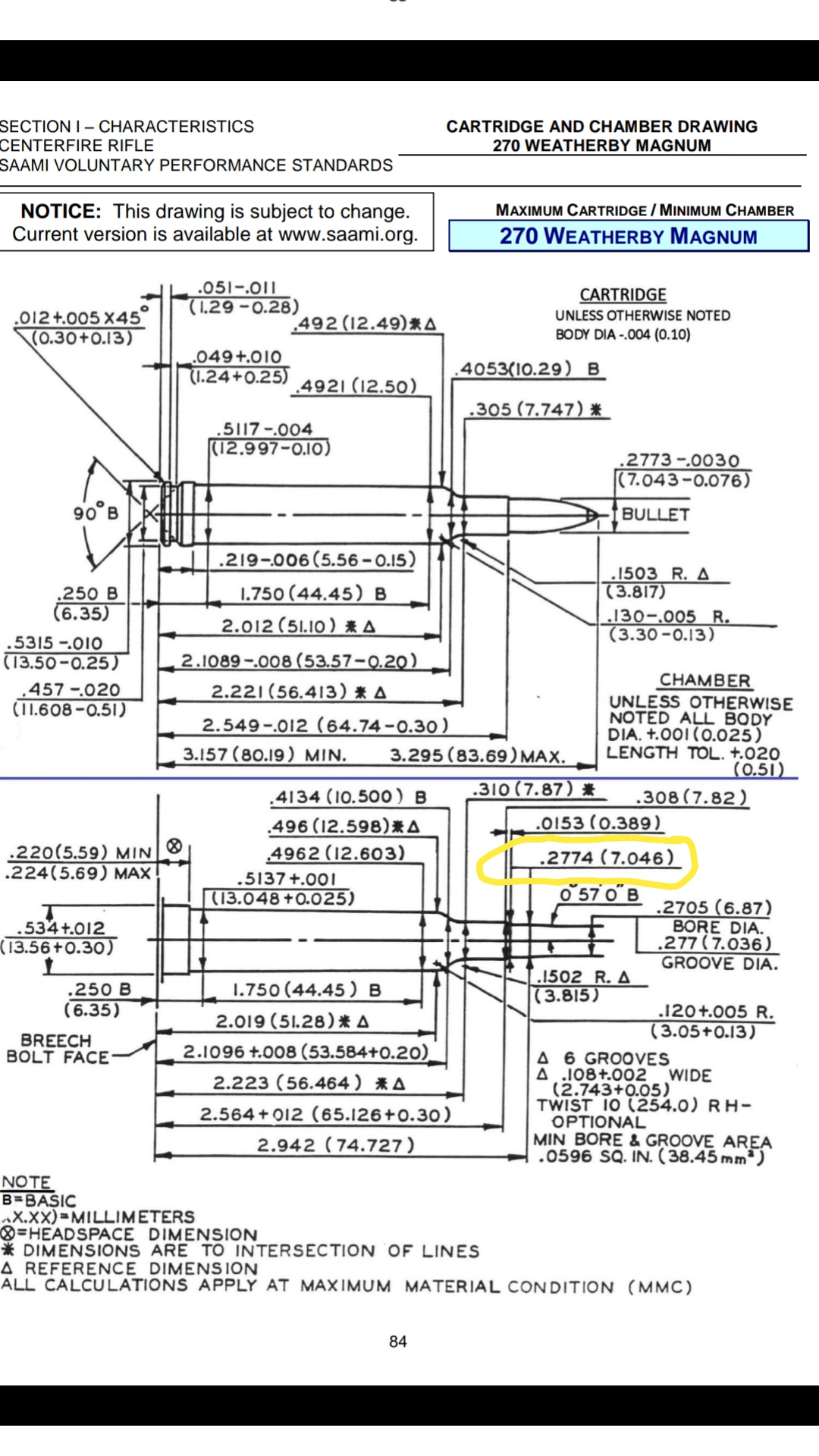

Just to add, I do have one rifle that I never chase the lands. 270 Weatherby, it has standard .375" freebore. I really can't measure jump because the bearing surface is out of the case neck when it reaches the lands.

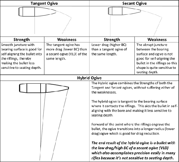

Only the ELDs are a secant design and as such are more sensitive to seating depth changes than tangent designed bullets.

Roy Weatherby had an ingenious design, the freebore diameter (ID) is speced .0005" over caliber. This guides the bullet squarely into the lands. Where as conventional cartridges' freebore ID is several thousandths bigger than caliber. I only have one Weatherby cartridge, 590 HOT rounds shot but the borescope shows that the start of the rifling has no fire cracking at all.
