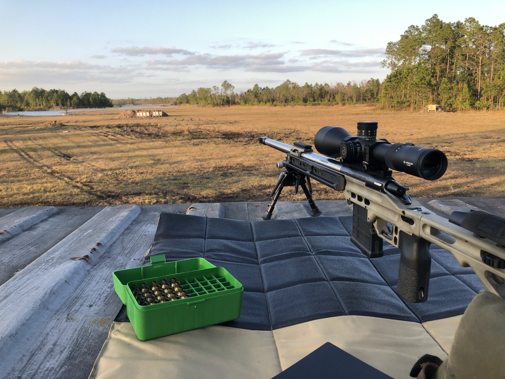

I’ve been running a bighorn TL3 in an MPA action for a few years. I’ve always had an issue with feeding issues if there is any forward pressure on the magazine when running the bolt. I’ve recently starting shooting rimfire with a Bergara b14r in the same chassis. It’s even worse with that action. I have tried to train around this issue but if I even slide the rifle forward to its balance point and the bag contacts the magazine I have a failure to feed. I’m willing to change chassis or stocks if that will help. What do you guys run/like? Do you have this issue with your rigs? Thinking about an MDT ACC as it’s a similar build but the front of the mag well is more of a barricade stop.

I had similar issues with the KRG Whiskey 3.
Instead of actually fixing the problem I switched to an MDT ACC.
I never had any issues with the ACC, but I won't say that it hasn't happened on someone else's rifle.
It almost seems like there's too much play in the mag well allowing the mag to pivot on the mag release.
Reactions: TNSleeper99
I found a little piece that MPA sells called the “mag block insert”. Ordered 2 sets of them. Seems to be their solution to a known problem. Hoping this is actually this easy to correct.
Yeah that's what I was talking about. It limits the vertical travel of the mag. It works pretty well and it might fix your issue.
I put one in to test fit and see if it was the right one (they send 2), and it helped a lot with vertical mag travel. I don't know if the other one would have been better or worse because I couldn't get the first one out. I may could have but might have destroyed it in doing so. They say to use some glue or something when installing the one you want to make permanent but of course I didn't. Between the side adjustments and that mag block thing the mag got pretty snug with minimal movement.
There is a second video on MPa’s website, the different blocks coordinate with changes in their machining process. Earlier versions fit one and later versions fit another per their website.
ARC made this a non issue for me with the Xylo, the mag catch is build to prevent the magazine from rotating if you put a load against it.
I know loading into the mag hard is a bad idea, I just want to be able to slide forward on a bag until the mag well stops and then drop into my scope.
This is pitiful. If a chassis company can’t make a frame/mag combo that doesn’t require blocks and videos and bandaids it’s pathetic. Especially for what they charge. That being said, I’m not fluent in these issues so it’s maybe more complicated than I perceive but from the surface just seems crazy in a “precision” world.
I have to admit that I felt the same way. I love the MPA chassis but it is kind of pathetic that I have to buy a freaking plastic block to get the mag to fit correctly on a $1200 chassis. I've only had one so I'm not sure if it's all of em or just some or depends on the mags or what.
Reactions: db2000
It’s really not so much the chassis fault as it is the mag cut on the action itself. You would not have this issue with an Impact action in the MPA even if you rested the full weight of the gun on the magazine.
Reactions: Stoweit
Its pitifull that they have to make something that will function with dozens of different action, mag combinations on the market?

Wow, this got a lot more heated than I expected. I wasn’t posting to take a stab at MPA or any other chassis company. I have ran this BA comp for 4 years and it feels like home to me. I have spoken to Phil and the crew down at MPA about various upgrades and issues over the years, and that have truly been awesome. You guys are right, most of these rifle have quirks that have to be massaged a little bit or trained around. I have no problem sending off for a $10 part to solve my issue with my current set up.
