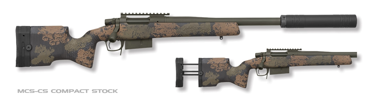

I'm trying to get a precision rifle put together for my wife who is 5' tall and my son who is turning 5 this month. Is there a chassis out there that is adjustable enough that would accommodate a young child's length of pull as well as enough adjustment to fit a small lady? I'm not sure if something like that exists, but R700/clone footprint would be preferable.
The Manners MCS-CS might work?
