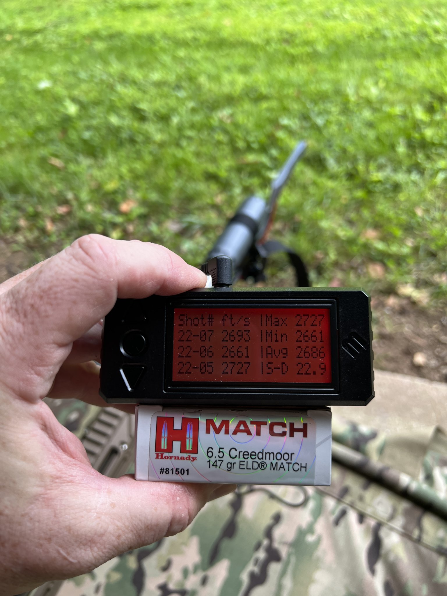

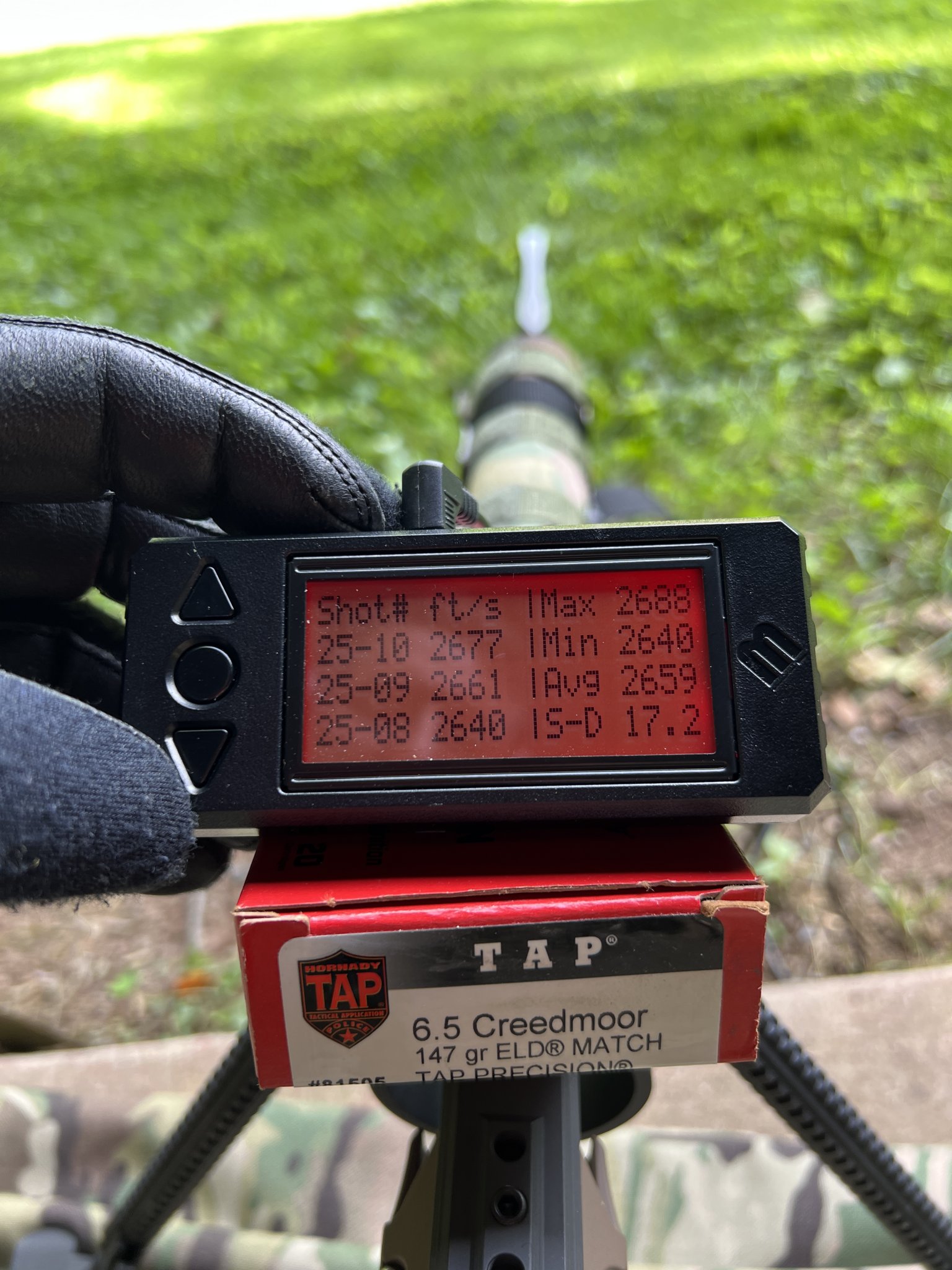

Well, Hornady was doing really well for awhile, then when ammo started running scarce, they started suffering from issues with their quality control.
Commercial Hornady got sorta crappier, and TAP (police) remained better.

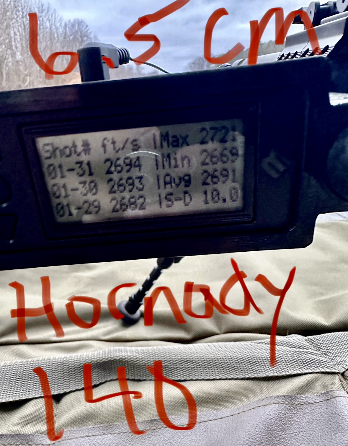

These are both 147gr 6.5 ELDMs:
You'll note that the SD is way different between the two. With my handloads, an SD of 10 is very good. Factory ammo at <15 isn't bad.
If we look at Hornady, we see a difference between the older and newer commercial ammo:

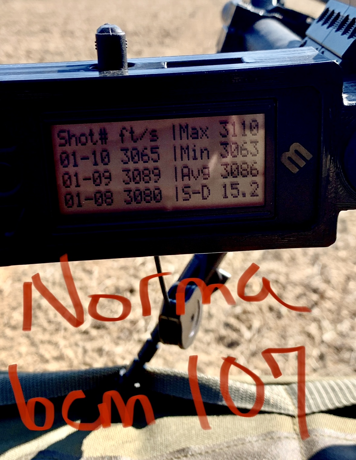

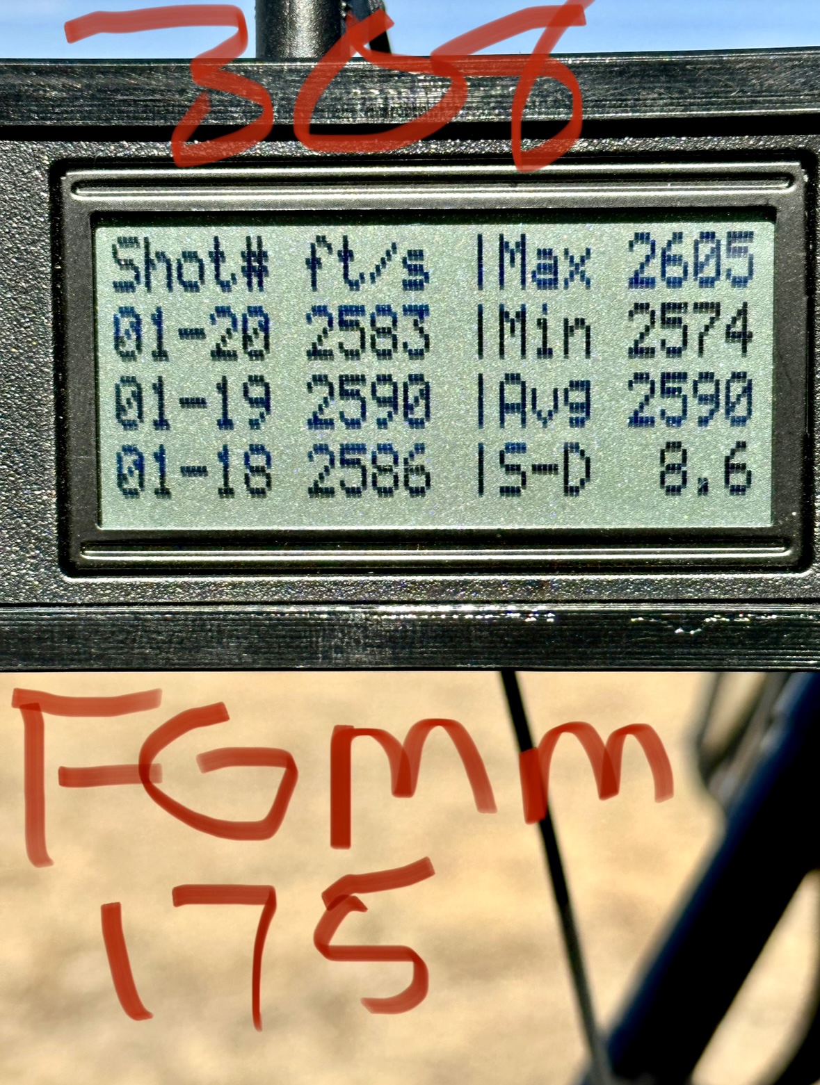

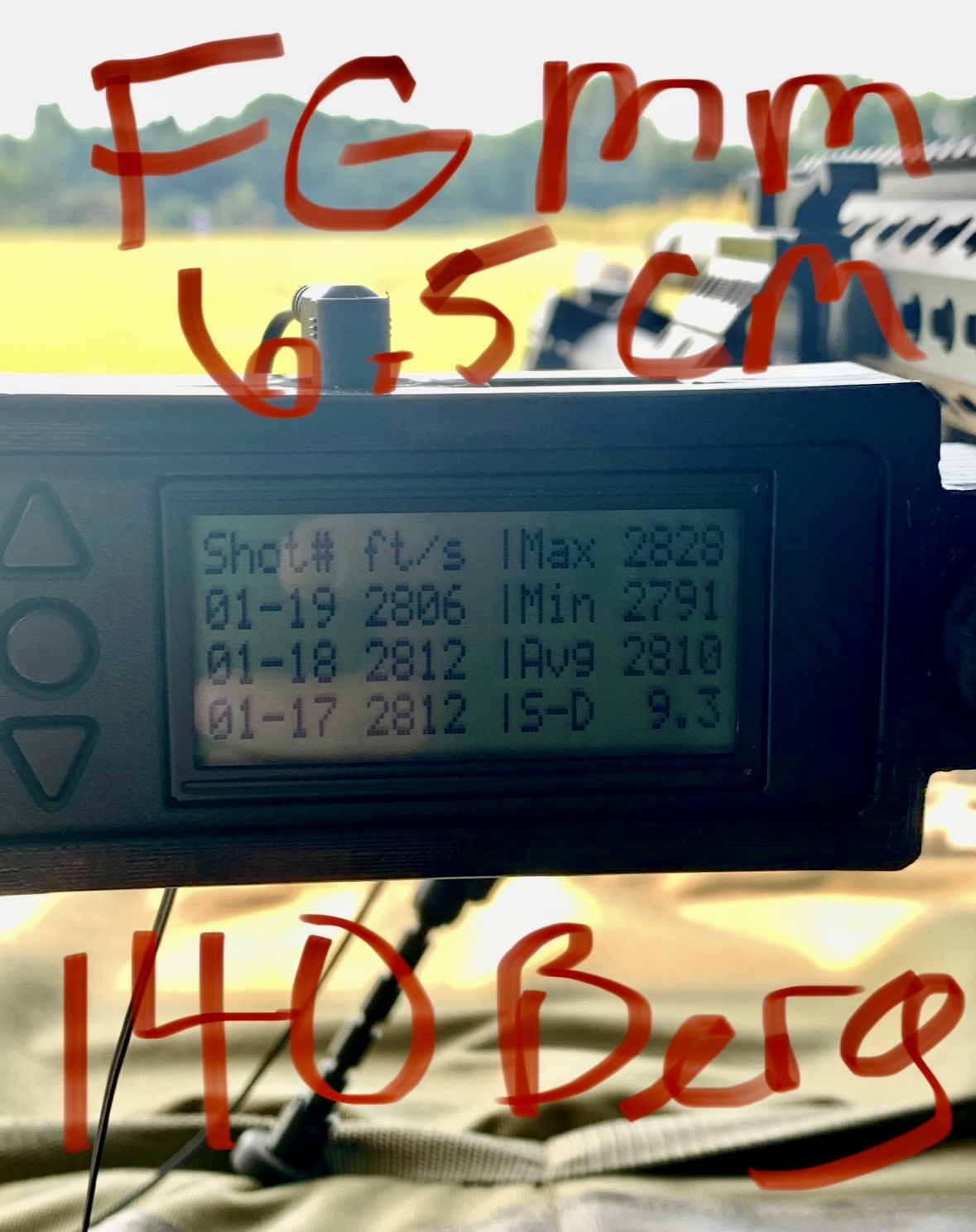

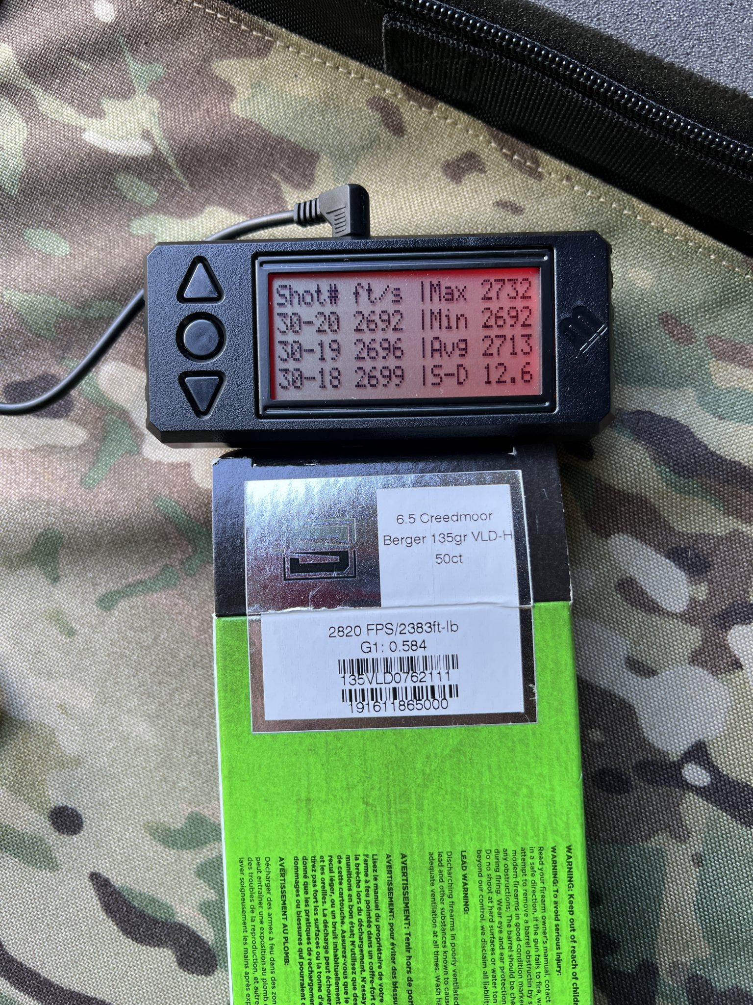

But let’s take a look at a bunch of others:

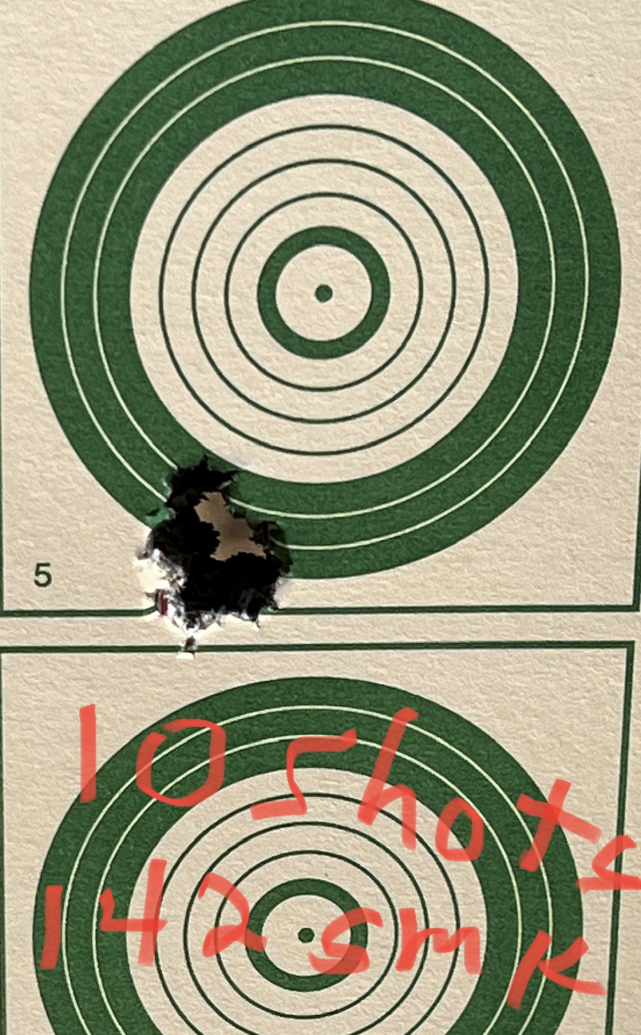

The 10 shots in that target -> That is a 22lr target sheet, 50 yard, benchrest target (shot from a bi-pod, prone, at,100 yards). The group is the size of a nickel, and the 142 SMK didn't have the very best SD, but it shot very well.

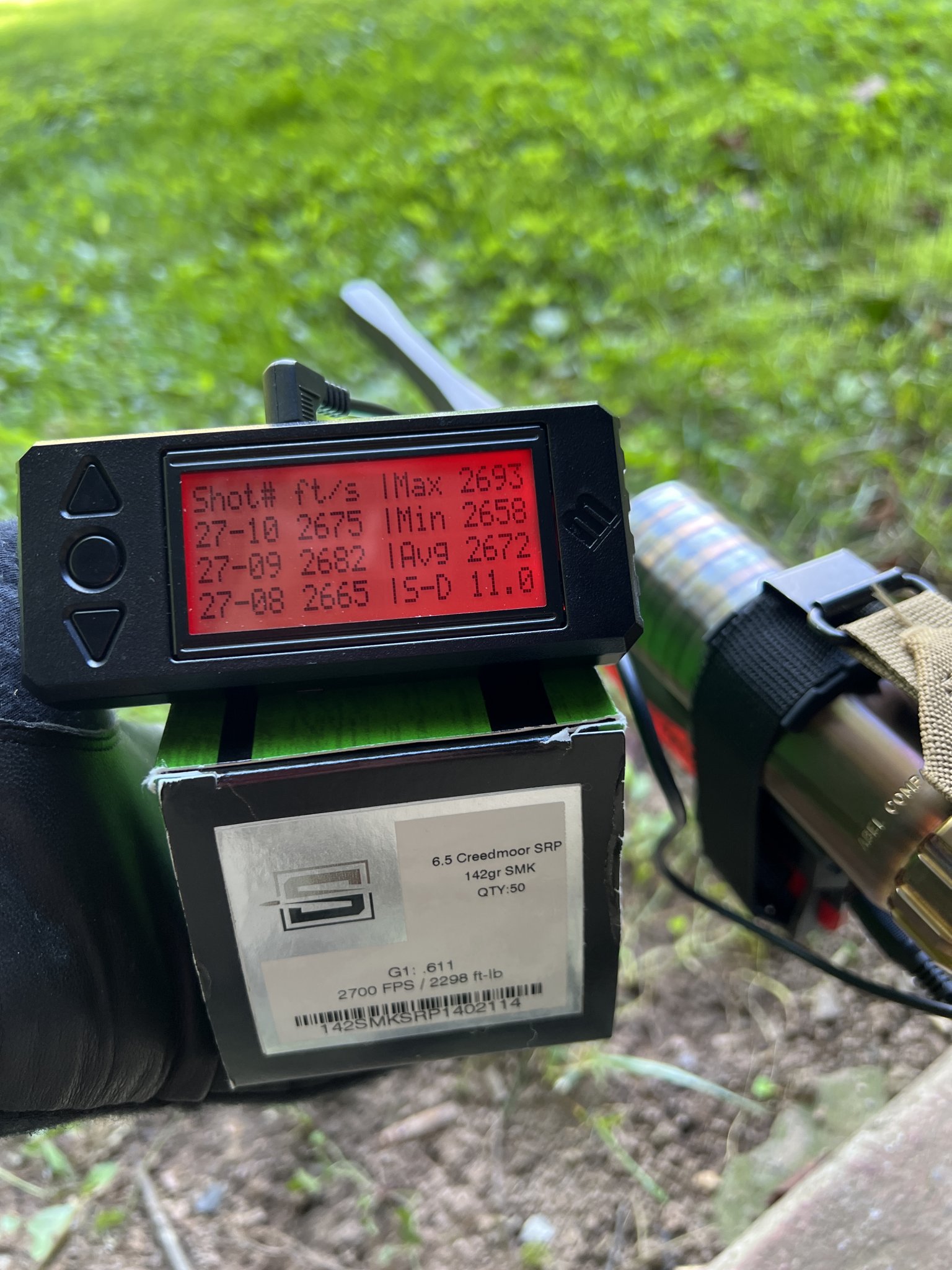

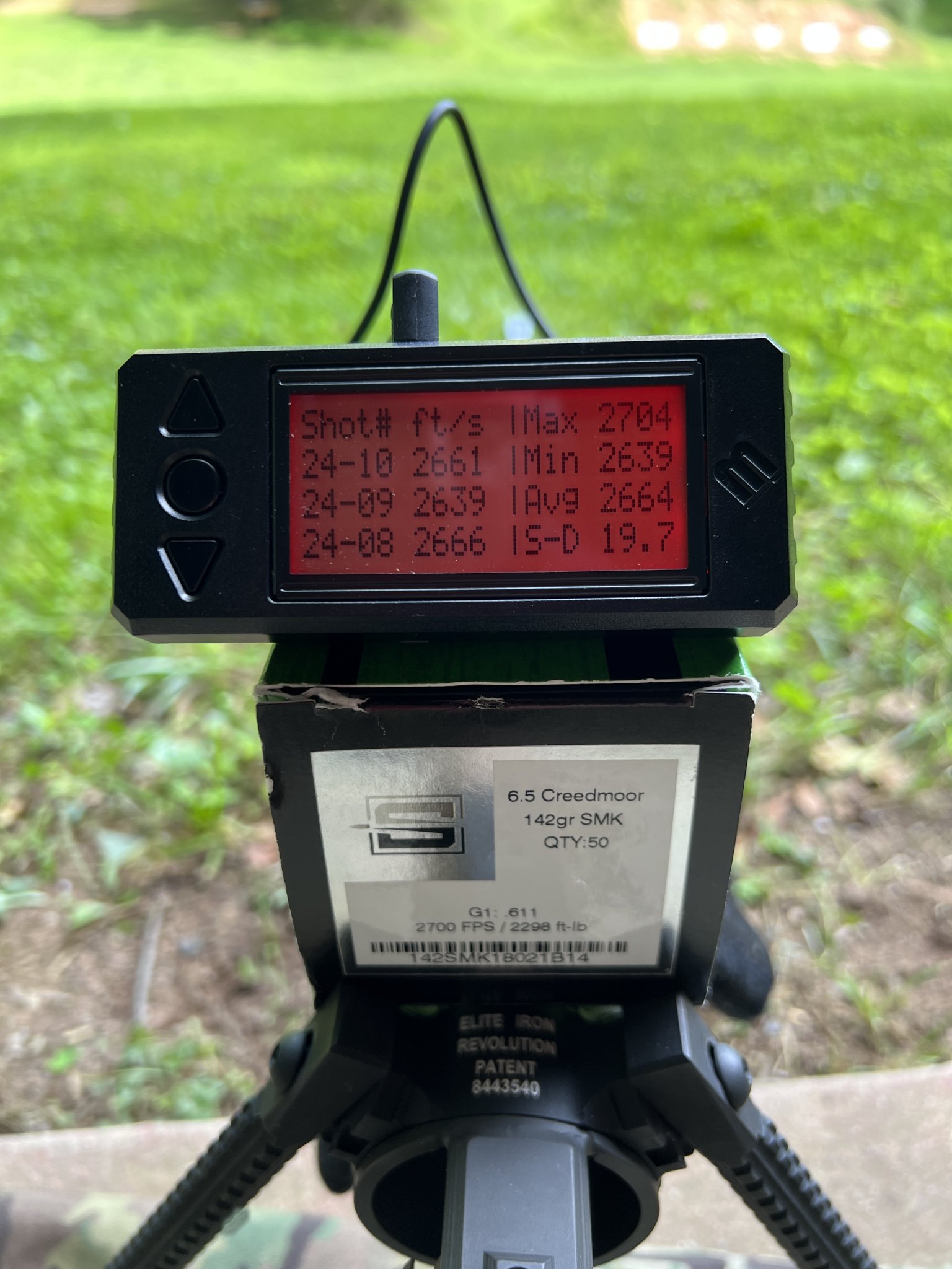

Then there is the SD difference between LRP and SRP:
So what does this really mean to you? The larger the SD and the larger the ES, the more variation you will see at distance. 50-100FPS will result is a significant issue hitting targets consistently out past 600 yards.
The chronograph becomes important when you’re trying to set up a ballistic calculator, so that you know what your holdovers should be, as you start shooting further out:
For the record: I should state that any of the Chrono data up above that isn’t a 20 round lot is probably incomplete data. You’re really want a larger sample and 20 rounds is a good start; 50 rounds would be much better. That being said, of the ammo up above, I actually have shot all of that to larger sample sizes and what you’re seeing on the Chrono is generally accurate, even when the sample size is larger. (… I just didn’t feel like trying to find my lab radar data.)

I’m hitting targets at 1000Y without any issues, and Berger factory ammo ain’t bad…
Yep, we both shot factory at the Frank/Marc clinic in PA...I think you with Hornady ELD-M 147's and me with Berger 140 HT and we had zero issue with getting accurate dope and making first round hits at range. I believe we both got first round hits shooting from the platform at a 12" x 12" piece of steel at 1040 yards.

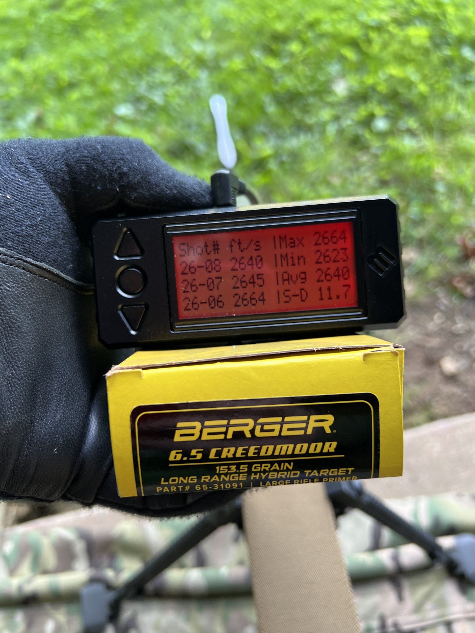

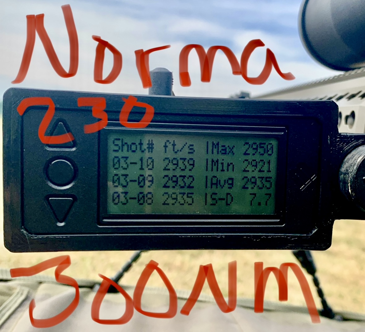

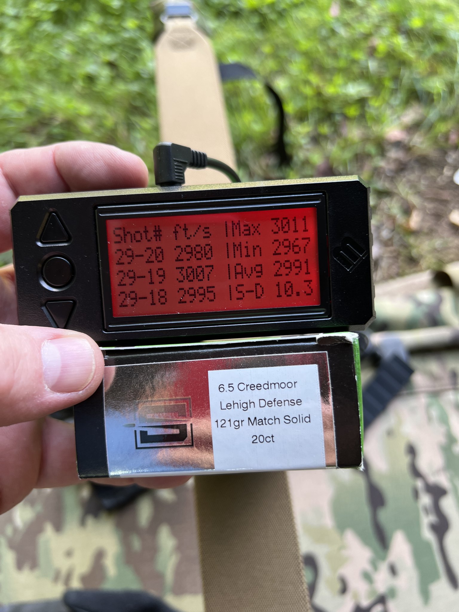

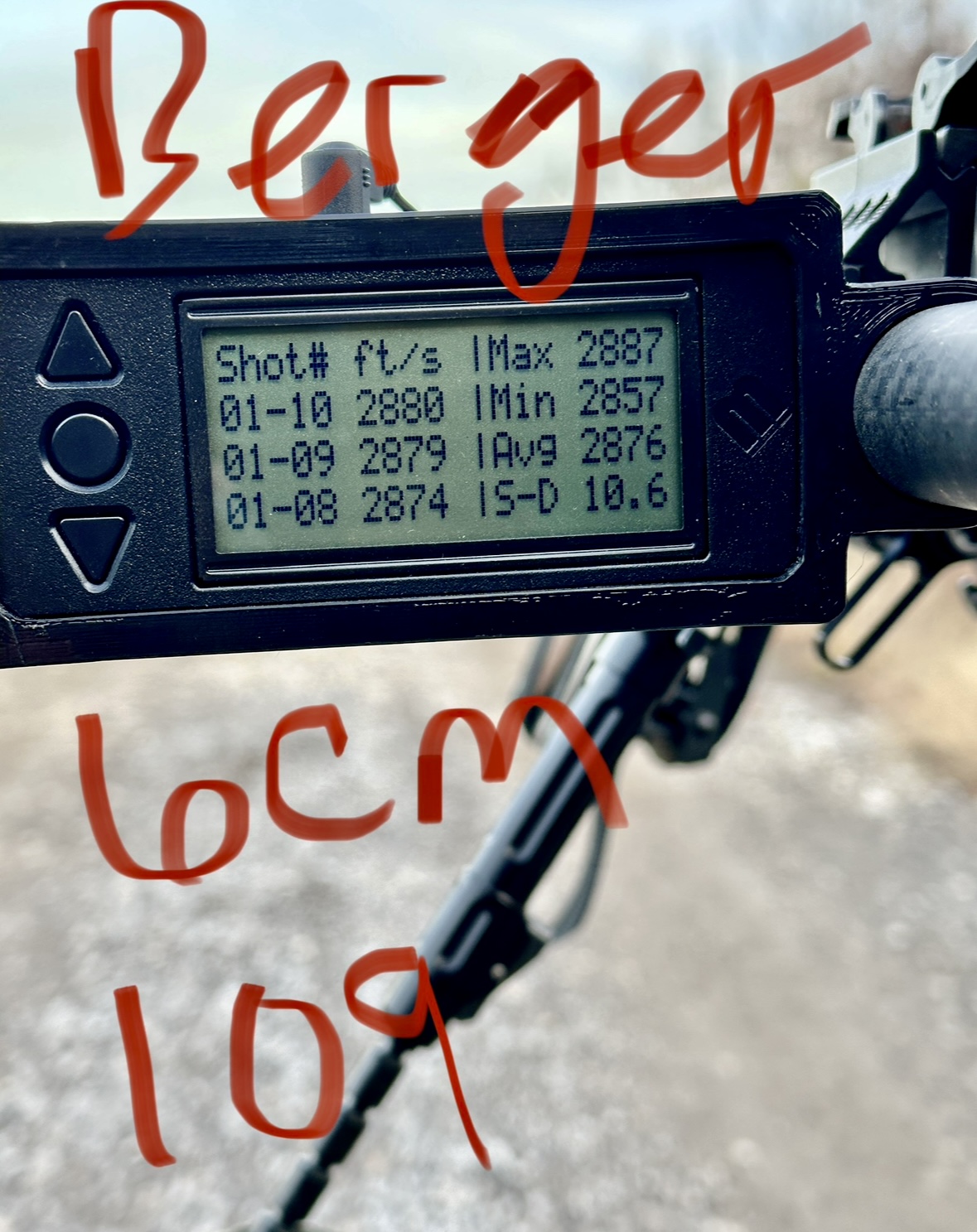

That’s some pretty nice Chrono data!
I’m really not sure you can load better than that per se; that the amount of effort necessary to reload your own is worth it, unless you’re saving a lot of money, given those results.
Thanks, I’ve been pretty pleased with shooting factory match. I mean, I don’t know any better, haha. Never have shot good handloads. I guess I’m just not there yet, to want to get into hand loading.

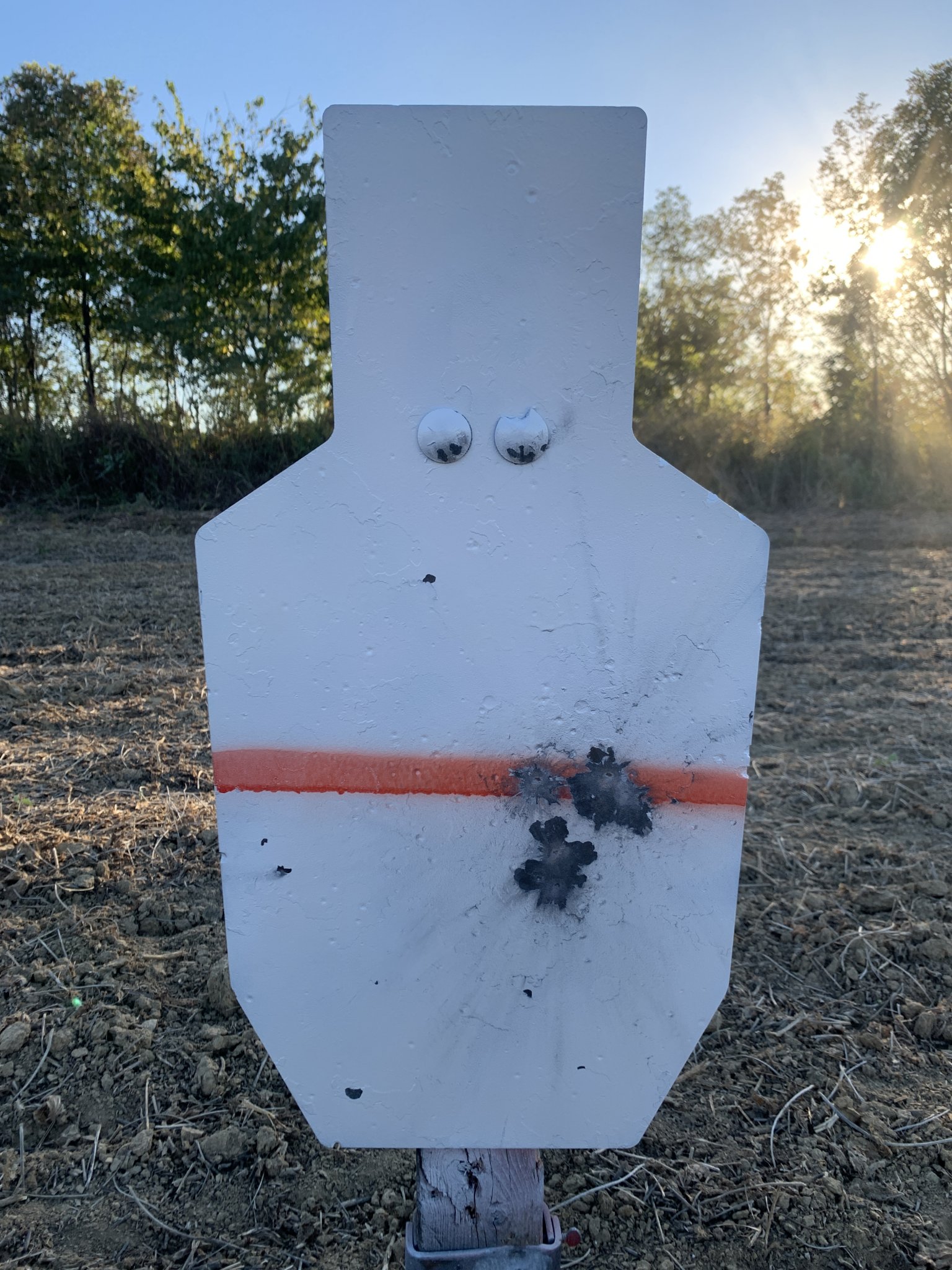

I was stoked to shoot this 5shot group with Norma 6cm 107gr at 556y, and what’s crazy is it’s barely over $1 per round currently!
  • Love
Reactions: Baron23 and LR1845

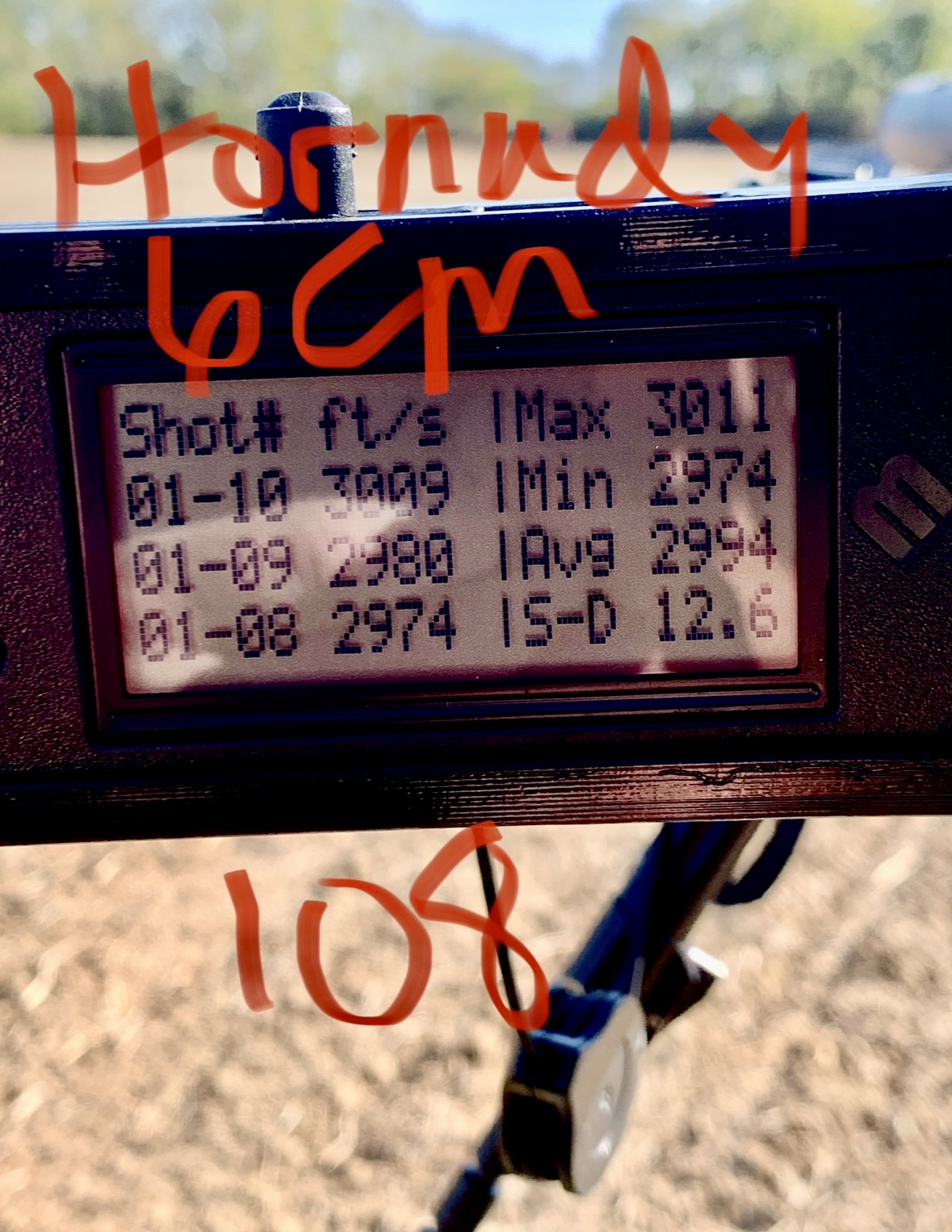

Chrono data on the norma 6cm?

Meh my prime is 3151 out of a 6cm. Accurate -AF too.
Dang....now, I'm shooting 6.5 Manbun and with Prime with (need to check to be sure) 142 SMK's. I'm getting 2755 out of a Proof SS barrel that is pretty dang fast compared to others. 3151 fps is low level supersonic flying, brother. :cool:
