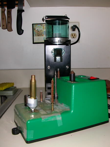

    Dogtown hit this one the head and is virtually the same process I use. I don't quench mine. I could be wrong, but I would assume that the quenching process is counter-intuitive since we want to make it more ductile rather than brittle. I'm no metallurgist but I know what works and gets the job done.
    'Dual use tools are the best tools.'
    Alton Brown
    Chris
