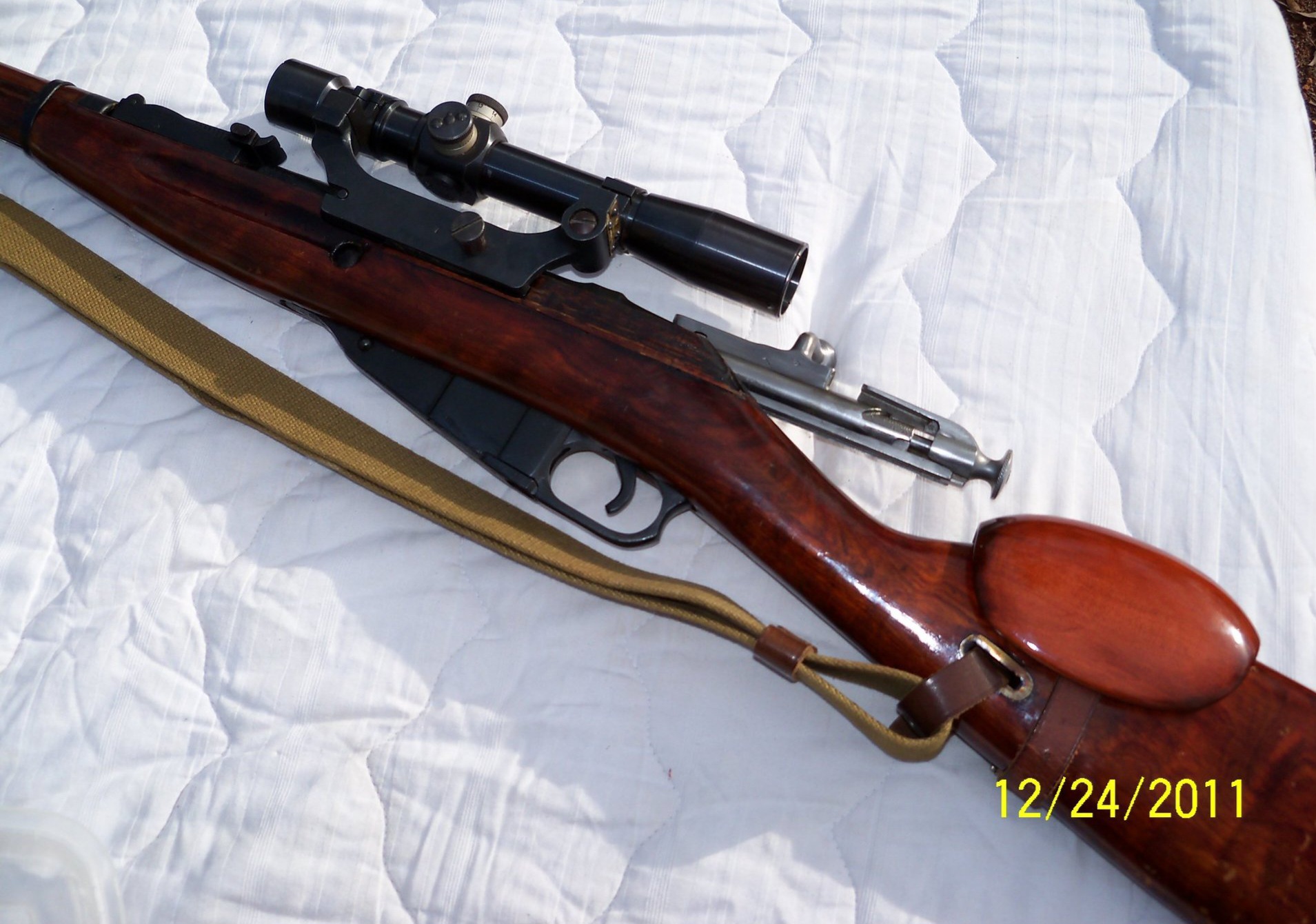

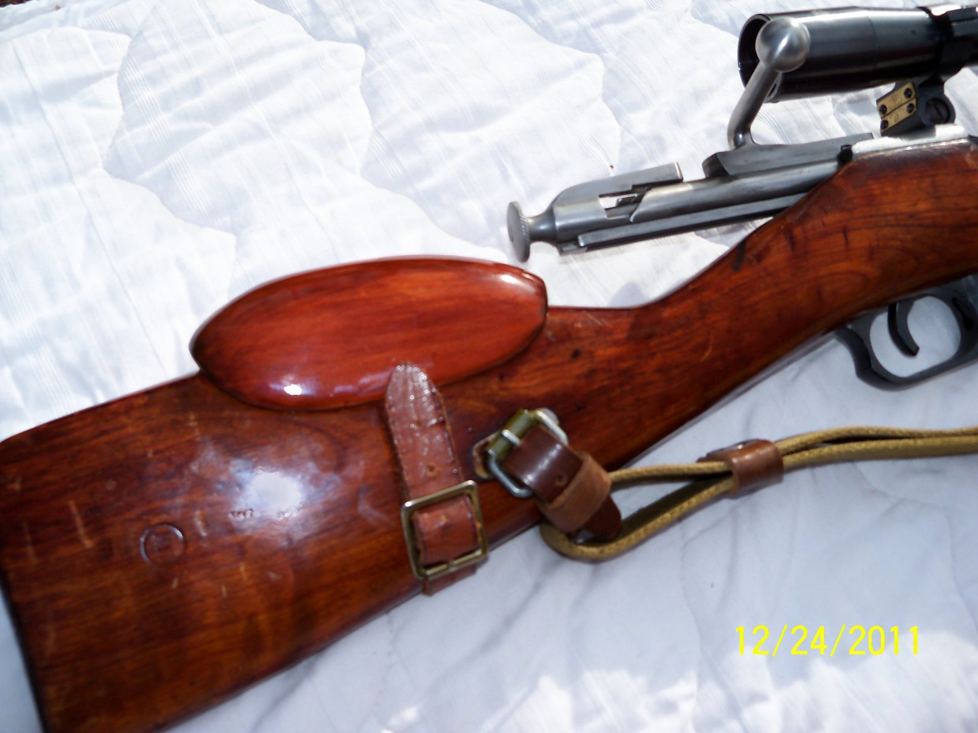

Good Day,
The Soviet did experiment with a few different designs of cheek rest. Here is one mounted on my PEM (repo mount). Very few of the cheekpieces survived the war.
Regards.
Michael

Re: Cheek Rest On Mosin Nagant?
OP - don't know if you've bought anything yet but don't go doing any permanent alteration to the stock until you've looked at these:
http://www.cheeknstock.com/main.html
I used one of the special order versions on a Mauser M03. It worked great, easy to put on/take off and offered a stable, consistent cheek weld.
They're made to the measurements of your stock and you can specify the height of the comb/pad to suit.
Not "tacticool" perhaps, but a great solution that requires no alteration to the rifle.
Thanks FlightRN, I didn't know that... I was thinking to make an Enfield style wood cheekpiece to screw it to a MN stock but I'll try to make one like Yours. Regards.-
Good Day,
Yes, the cheek rest you see on my PEM Mosin is a latter design and was obtained from the Central Armed Forces Museum in Moscow. It is an exact copy (the buckel may be a little off) of a setup that was used in the 1930's when the Soviets and Germans were experimenting with different designs. Many early Soviet designs used German optics and mounts.
