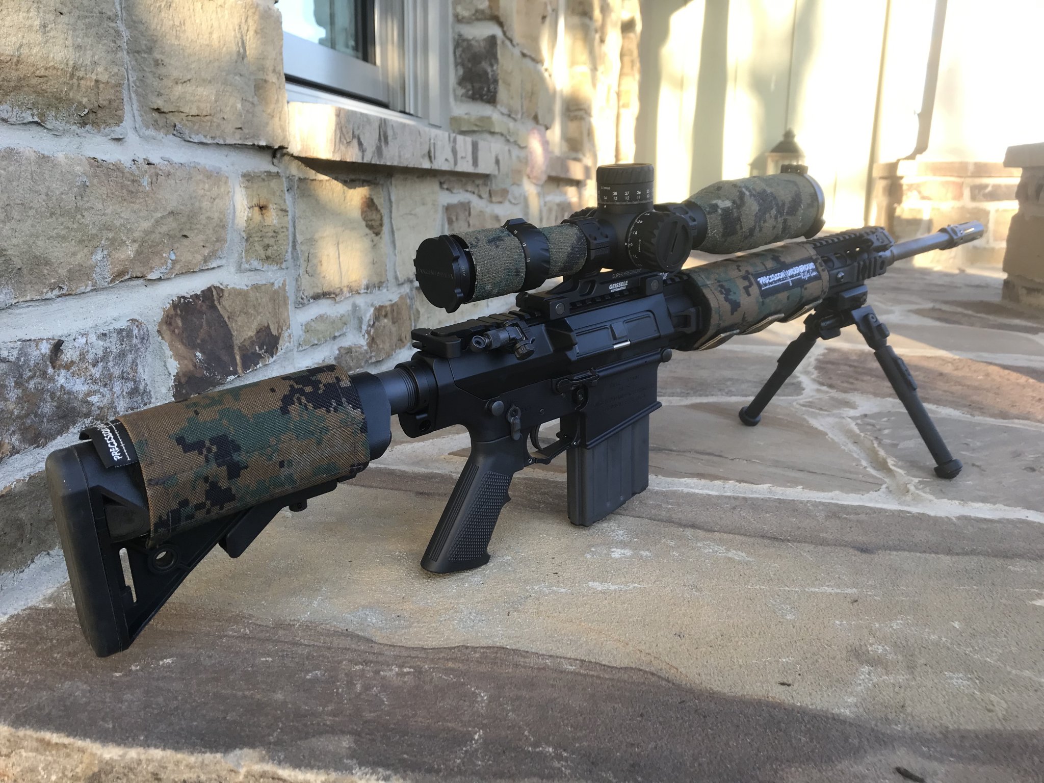

I know you said you don’t want to go the collapsible route but I would consider a B5 Sopmod. I run one on a 308. Every bit as comfortable as the A2 on my AR15. Cheek weld is pretty solid and I run a 1.5” mount.

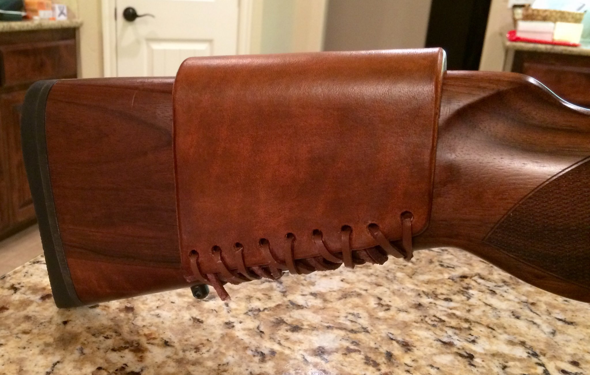

Leather Lace on? I can do that. Here's one I made for my CZ 455 Varmint (needs a bit less lacing though):

Go to Lowes, get the adhesive backed velcro that are 2"x 4" packs, I think you will need 2 packs total.
Start with the fuzzy side applied to stock in the exact place you need it. Then stick the Male and Female pieces together, as layers, adhesive side stuck together so one side is male, and the other is female. Then stack it up as to the height you need.
The last piece if velcro on top should be the male piece, and to cover the adhesive area, use whatever material that will stick and will be soft. I just used 100 mph tape to cover the very top, works perfect.
It is a solid setup, can get the perfect height you need, and if you need to adjust up or down, either add a layer, or take one off.
Cheap and easy, and looks professional without a bunch of other stuff all over your stock.

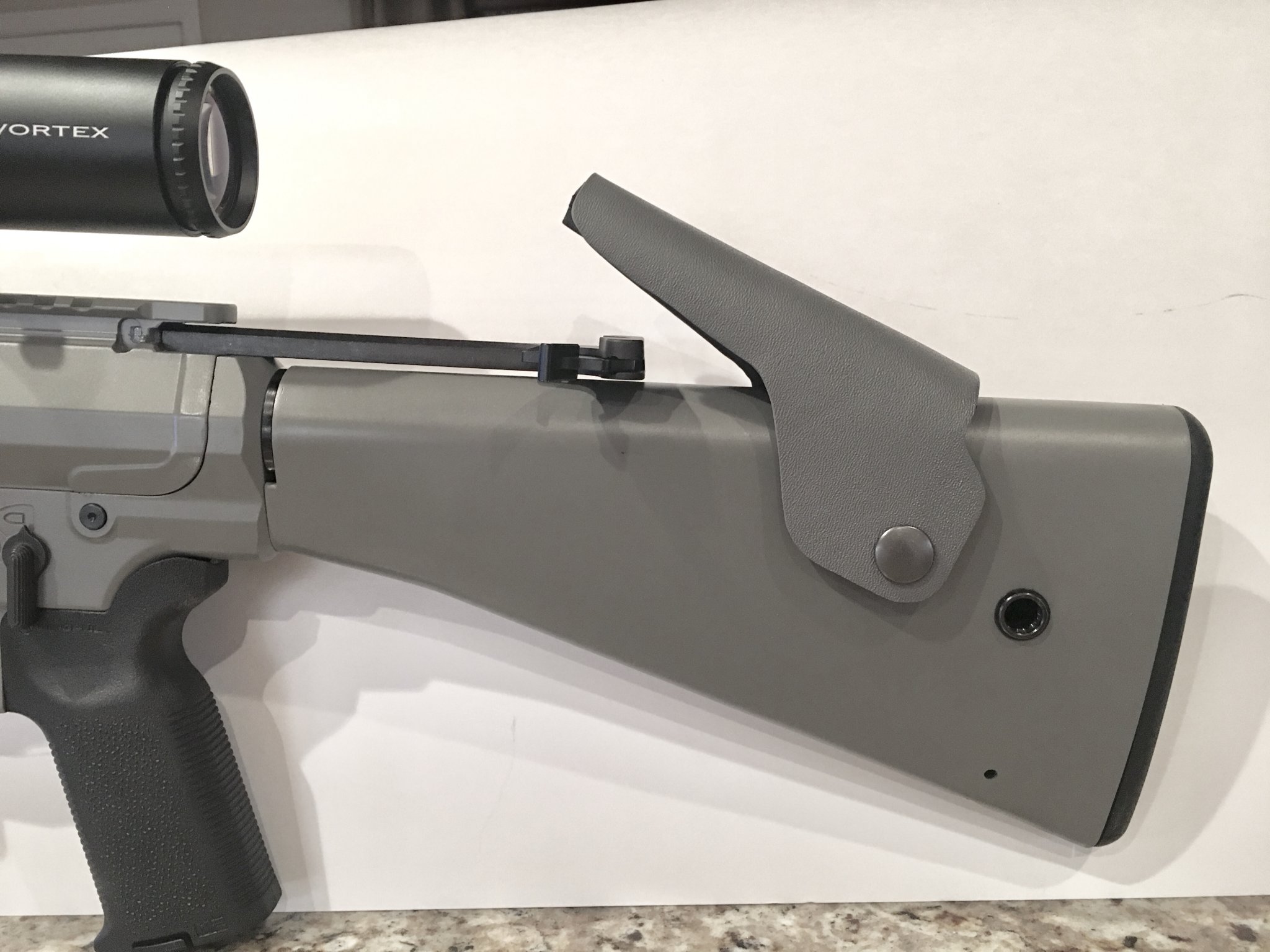

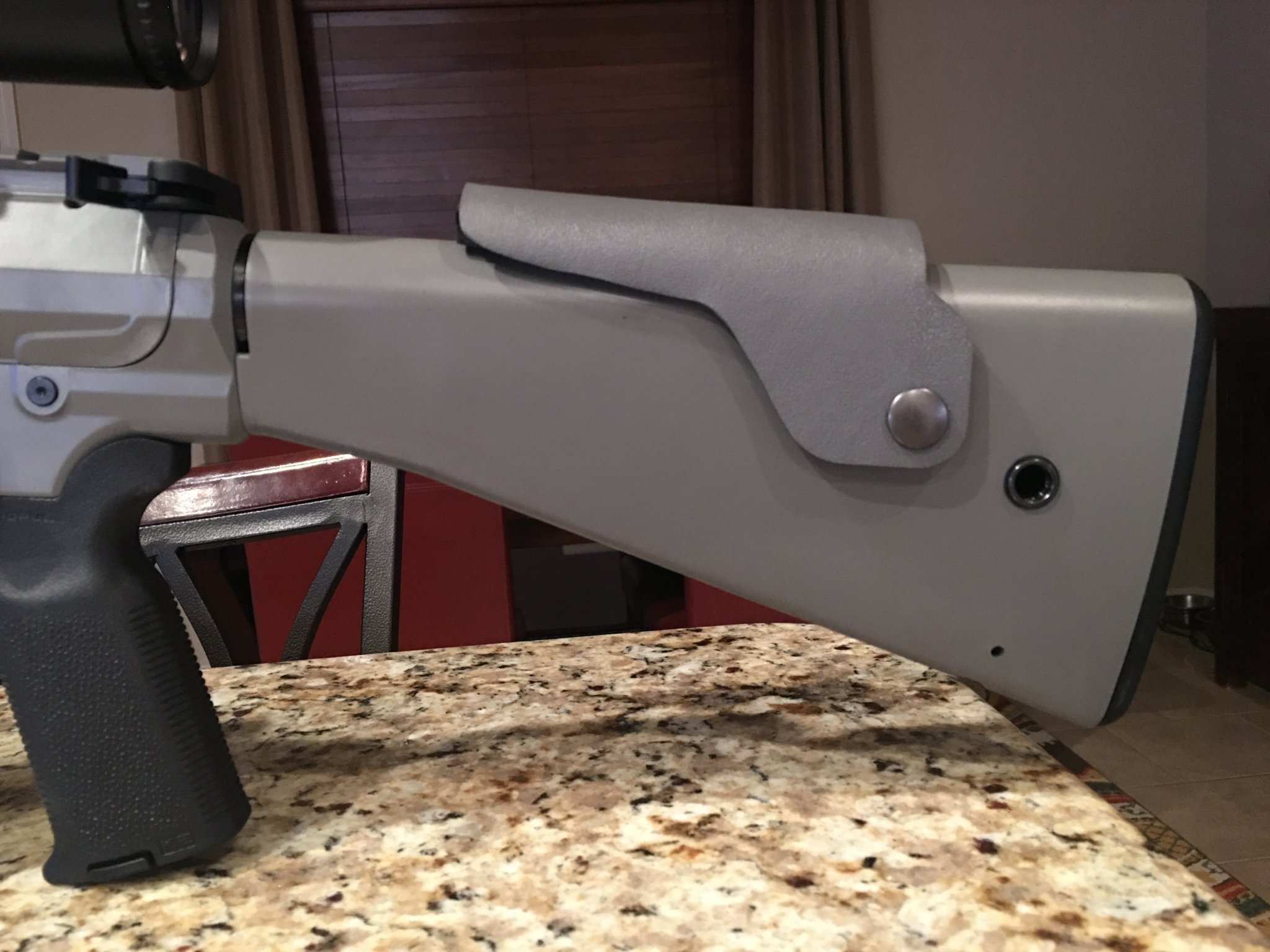

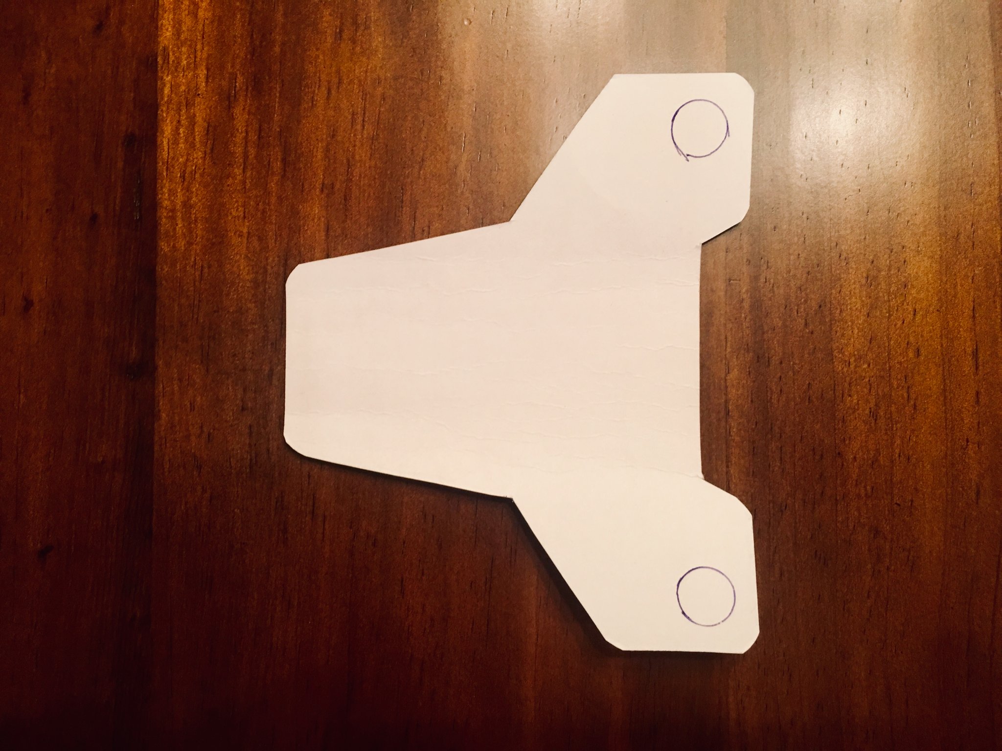

Well, I can’t find “exactly” what I want, so I’m going to try my hand with some kydex. I found a pic of a cheek riser that gave me an idea so I’ve modified the design a bit and we’ll see how it works.
The circles represent Line 24 snaps. I’ll install the male portion of the snaps on the stock and the female on the riser. The cutout at the back (right) will give me a little clearance. The snaps will act as pivots so that when I need to pull the charging handle back, I can pivot the front of the riser up and out of the way without having to remove it. A piece of EVA foam, rubber or other material can be used to support the front of the riser.
My kydex arrives next Tuesday so I’ll post the results next week.

Not to mention that I’d have to replace my upper and hanguard and Duracoat them all over again. I’m pretty confident that my pivoting cheek riser idea will work. I’ll get it made this week and post back.
