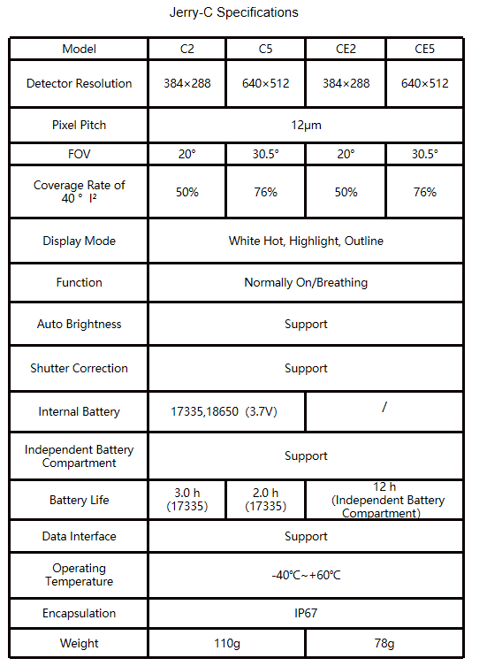

1. There is be a boresighting issue, where the image in the JerryC is not overlapping completely with the image in the night vision. The is a issue as things in the thermal image are not where they should be.
2. The lines in the outline mode the lines are too thick obscuring much of the image especially compared to the PAS-29 COTI and ECOTI
3. The ability of the JerryC to separate background clutter from objects of interest and emphasize that portion of the image is worse than the PAS-29 COTI and ECOTI. This does not get significantly better when changing the contrast option in the menu. It seems that there is just too much contrast in the image, where the brighter/dimmer parts are too close together.
4. The increased FOV over the COTI seems to be amazing, as I can't imagine running with only 20 degrees FOV.
5. There is no illuminated circle across the whole image unlike the COTI, increasing night vision image contrast across the central portion of the visual arc.
6. Looking directly through the JerryC, the image quality seems to be very good and there maybe potential for the addition of a lens on the JerryC allowing it to be used stand alone during the day.
7. The detection range for cars/people is very good have detected a person around 300 meters away.

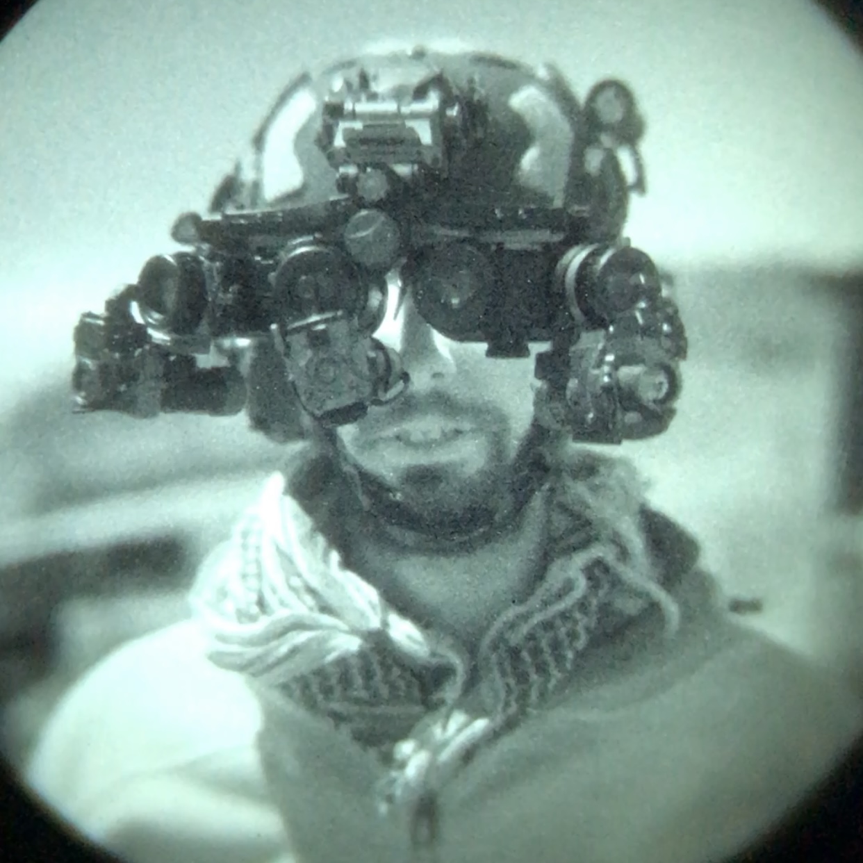

COTI vs ECOTI vs Jerry-C
Nick will have his full review up soon, and check out his Instagram/YouTube for more videos. In the meantime here are the key takeaways:
1) The COTI is a good entry level option for fusion tech. We could detect cows >300y away.
2) The increased 30deg FOV of the Jerry-C and ECOTI is a worthwhile upgrade from the 20deg of the COTI.
3) ECOTI in patrol and Jerry-C in full had similar image contrast and detail which is much better then the COTI. Jerry-C had slightly better focus/sharpness then the ECOTI, however this is not really important for detection and may just be a difference in focus distance between devices.
4) Paddle controls of the COTI and Jerry-C are better then the 3 buttons on the ECOTI, but after some use the 3 buttons are a non-issue.
5) If you have the cash, Jerry-C or ECOTI are definitely better then the COTI. Is the ECOTI worth 3k more then the Jerry-C, probably not, but Chinese company with no US presence vs American company so up to you.
6) 3x COTIs is completely un-useable as it is just too much information to process. Why 3 and not 4? You only need 3x to have a thermal image in all fields of view. Since they are not collimated, 2x in the central image would never match up and look like a mess.
7) My neck is still a little sore...
